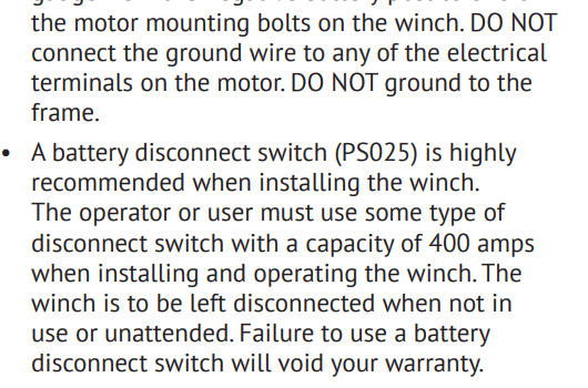

...probably your winch. Installed mine myself, wired directly to the battery (I have no aux switches). took it in for electrical service and tech tells me that since I did it myself, they couldn't even test the electrical system (read, aux battery) as my warranty might be voided. Tech was phenomenal and told me exactly what their concern was. Literally, drove it to a parking lot, disconnected the winch, and took it back. Voila! My warranty is back in tact and they ran their diagnostics. Seems their concern was that I had two connections inverted (winch worked fine) and they didn't like that.
40,463
53,911
Wish I had had that sort of luck a couple of years back........ their fix was moving the winch ground cable from the top of the IBS to a chassis ground. Electrically identical, cable-wise, they introduced a smaller cable into my winch ground by doing that.
Where I'm going now, they don't seem to mind that I have snow plow cables throughout the engine bay, winch, power steps and other stuff.
But if I ever run into what some are seeing, it's a simple matter of pulling a couple of cables off the battery and going in saying "see, no electric mods"
You ran across not only a clever tech but a place where there's still a trace of "customer service'.

I installed my winch myself and it's hard wired to the battery. I leave the + side not attached till I need it. No switches, no problem.
40,463
53,911
The downside is that because fuse 42 is pulled, the ESS system will no longer operate. It states Stop/start not ready.
That won't stop ESS from working. There's something else it's detecting that is preventing it from working so- that means there's another issue with that truck.
F42 ONLY prevents the PCR relay from opening for the aux battery check. It still believes it opened the relay and still senses power where it's expecting it - because it's seeing the main battery voltage.
the truck starts and runs better and the charging system works more efficiently.
How would it run better? Placebo effect. It can't run any better! That's because the ESS system has zero impact on how it runs, and as long as it's got adequate voltage, it won't know or care about batteries.
No way it can possibly "run better". Start better? No, not unless you had some serious issues causing low voltage during cranking.
Your mods didn't do a thing for the charging system to work more "efficiently". How could it?
All you likely did was install a fully charged new battery and in the process, left the IBS unplugged long enough for it to reset. The same thing could be accomplished with the aux battery system in place.
Sorry, but noting you did made it run better, cause ESS to not work, or make the charging system work better.
There's "quick connect" connectors for exactly that. Slip the cable over the stud on the quick connect and tighten the big nut down by hand. Takes seconds and no tools needed.
No switch to mount, no second short cable to run, clean and simple. Slip in the cable, snug down the nut. Go.
Hope you don't have to open your hood in the middle of a mud hole, or on the side of a cliff.
I did this too. I do plan (when I remember to) wire in a manual switch. In the mean time, it’s part of my trail prep routine… comment the winch while deflators are doing their job. After trail, disconnect winch while compressor is airing up ties…. Too easy!

Hi Zach I live in Newman, CA. you are right to much of a draw.
That is correct, but any one of the aux switches can be used to control a high amp solenoid for a winch. Or a switch can be installed to remove power when the winch is not in use.
