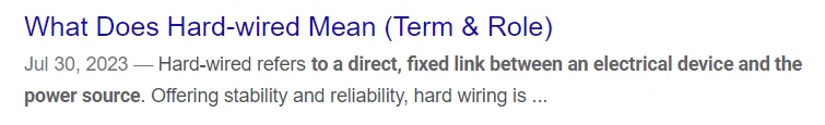

If it's not fused it's direct power. If it shorts or draws too much current while in use it will melt things. It's a simple enough concept.
Not true either - anything that's hardwired in your house goes through a breaker. The Level 2 charger i installed is hardwired - to a breaker. It means there is no switch and no outlet between power source and device.
Anything with a switch or outlet or some other connection (like a dash cam plugged into the 12v socket) is not hardwired.
You are saying that nothing in your house is hardwired.
Jeep Gladiator Dealer Trying to Void Warranty Screenshot 2023-12-07 105127

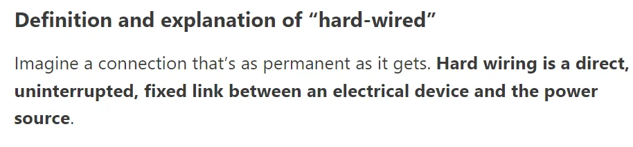

The power source is the fuse or the breaker.
Jeep Gladiator Dealer Trying to Void Warranty 1701976427463
Uninterrupted - no switch, no control device - a direct, fixed link between device and source.
Because they’re directly connected to the power source, there’s less risk of disconnection or interference.
