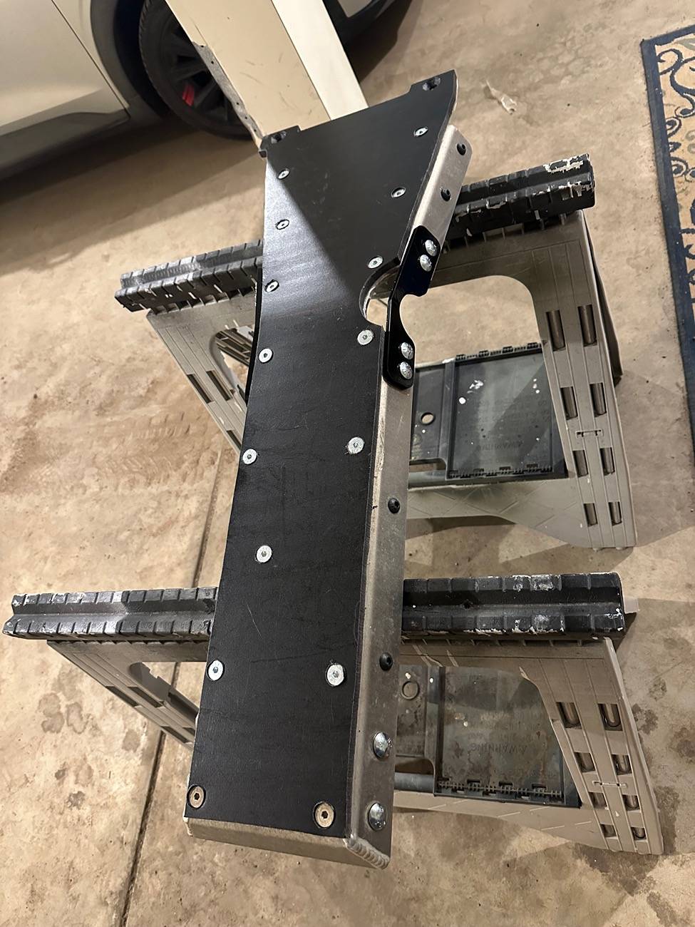

Nice - did you have NVM make those? Make it yourself? I don’t think I’ve seen the UHMW on any others

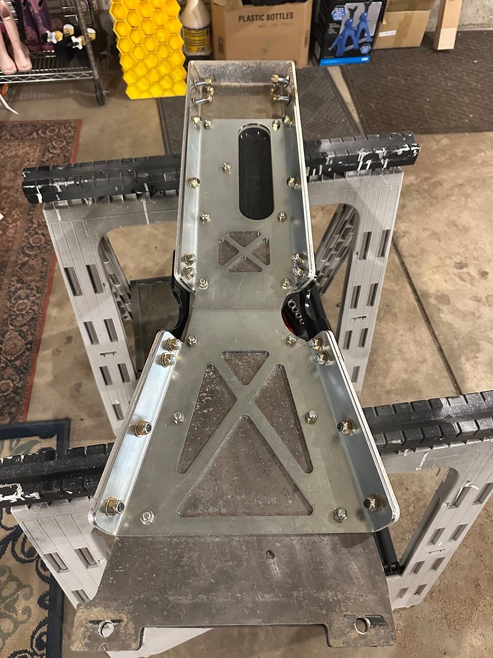

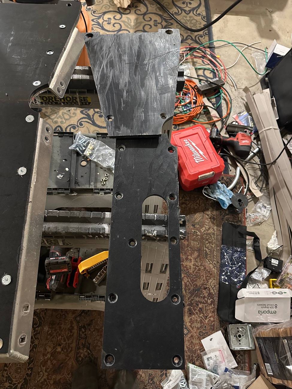

Yes, it’s nvm. Had it since 2022, but I bought a steel reinforcement kit for it after a bunch of abuse. I chose to make my own replacement UHMW layer in one piece. They use two pieces. I wanted it stronger at the bend, and wanted to eliminate the large oval under the pan for oil changes. Las picture shows the original UHMW. Still in perfectly fine shape after bashing them for years.

I have a full set of belly skids (Next Venture Motorsport) on my truck. It has an oval drain slot for oil, but unfortunately the oil does not drain straight thru the slot - sometime it gurgles and glugs and occasionally a little hot air apparently gets trapped and blows a nasty bubble through the oil. This is thicker diesel oil; I dunno maybe this never happens on the pentastar with 0W20. Hot bubble of air ends up doing this with burning hot oil while you’re under there pulling that bolt:
If this were more common I’m sure we would all be complaining, so maybe this was a one-off. Oh well. But more seriously, the oil dribbles all over the inside of the skid plates and runs EVERYWHERE. It drips out for days out of the most unpredictable places all over my clean driveway, and eventually forms sticky sludge when I take it off-road. Pulling the oil pan skid plate and getting all the interlocking bits to line up again is not something I want to be doing all the time if I can avoid it
I put a Valvomax on. Low profile (about the same as the stock plug), has a cap with a seal that lives on it, and there’s a one-way valve inside that’s opened by a screw-on hose fitting. Hose goes all the way down into the drain pan. No more dribble and sludge.
YMMV but for me there was a problem, this was the solution, and along the way it‘s now a faster cleaner and easier oil change than any vehicle I’ve ever owned, so I’m happy

Uh, you need that solution -
Yep. I just remade my engine skid to not even have the big oval for oil changes. This is all I need with the valve.
You were one I was thinking of when I said "with a skid" (something that obscures or blocks access.)........... me, no, you - yes.
