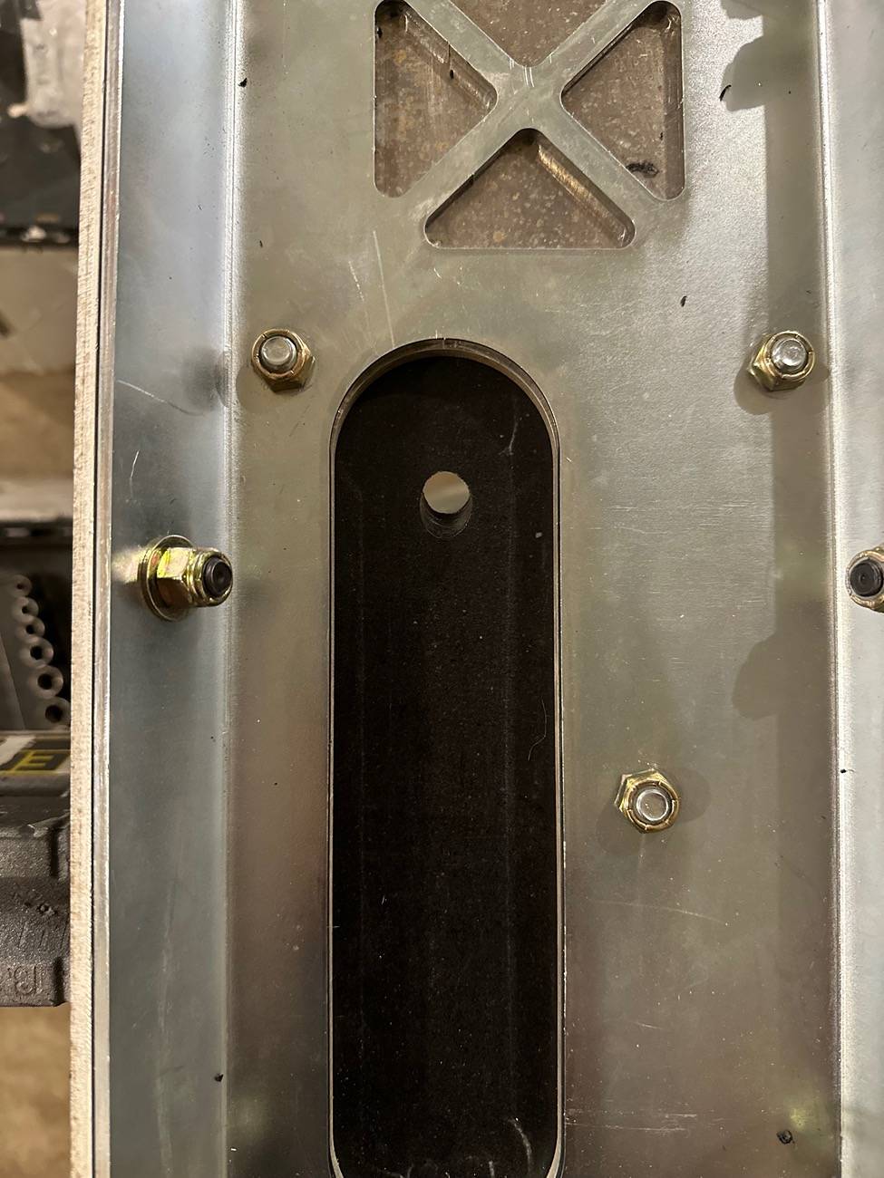

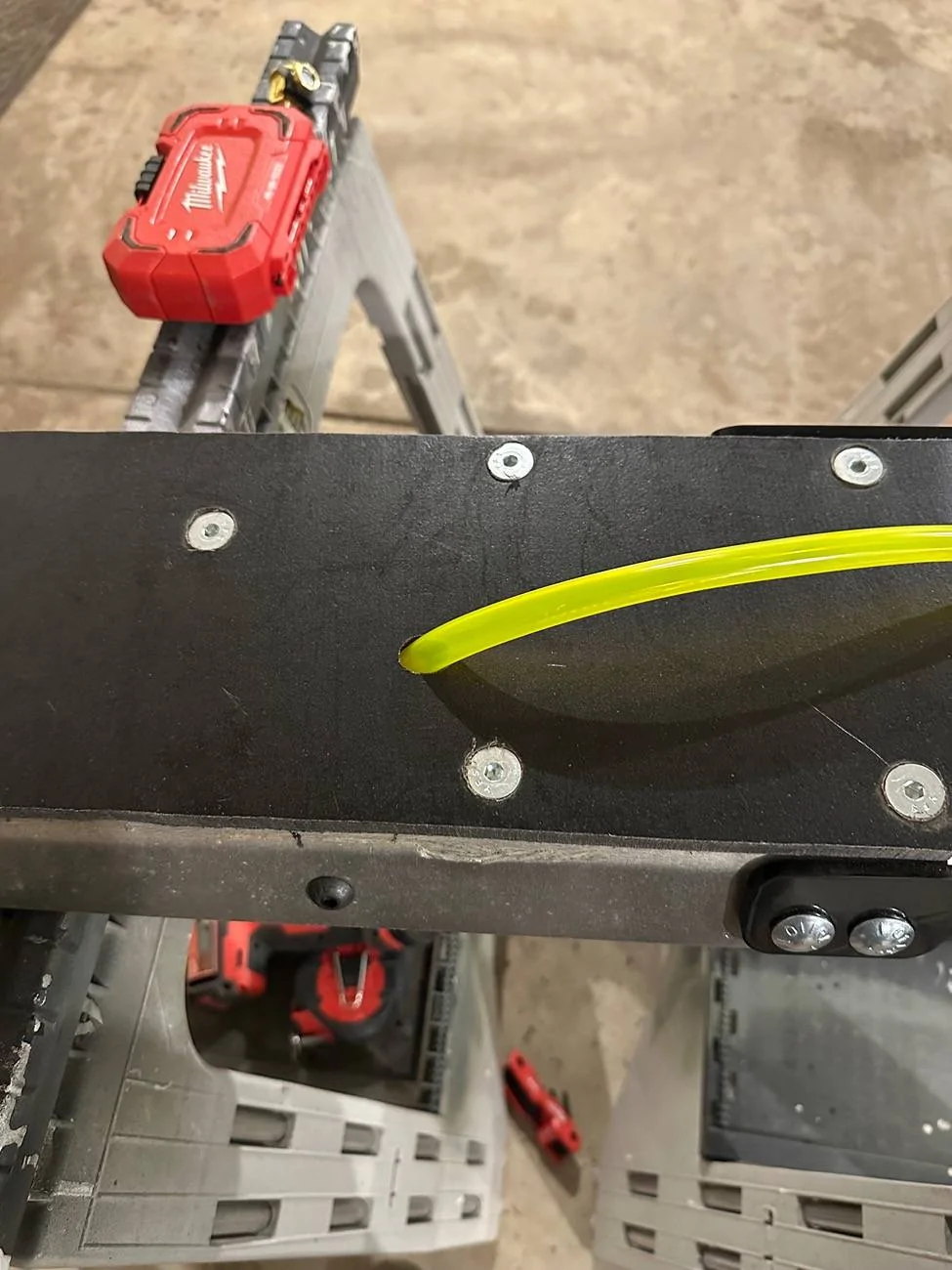

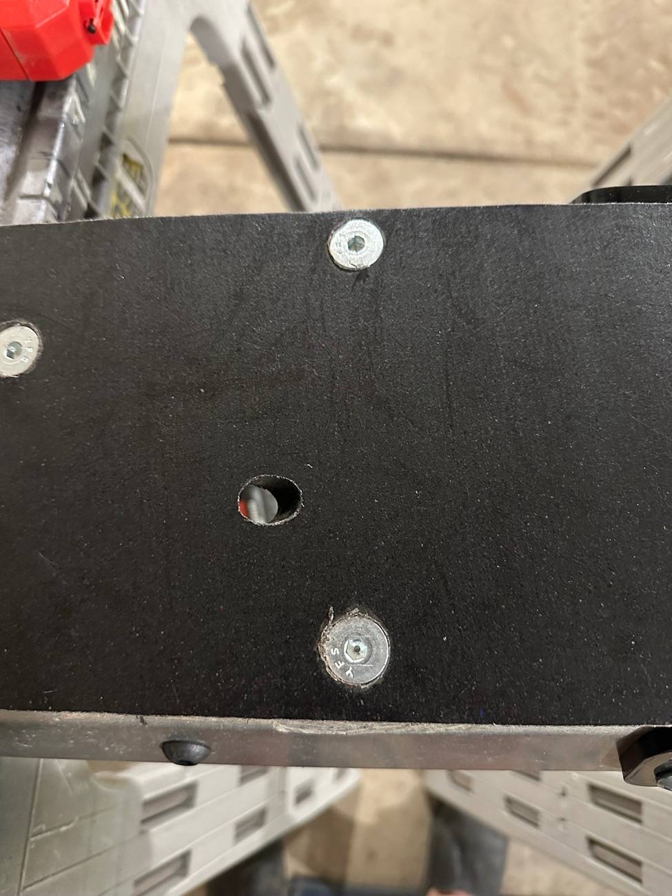

Yup….. I had one on my Tacoma for years.
Not good if you do any offroading because they stick down and could get sheered off. Unless you have a belly skid plate that protects it.
Yep. I just remade my engine skid to not even have the big oval for oil changes. This is all I need with the valve.
