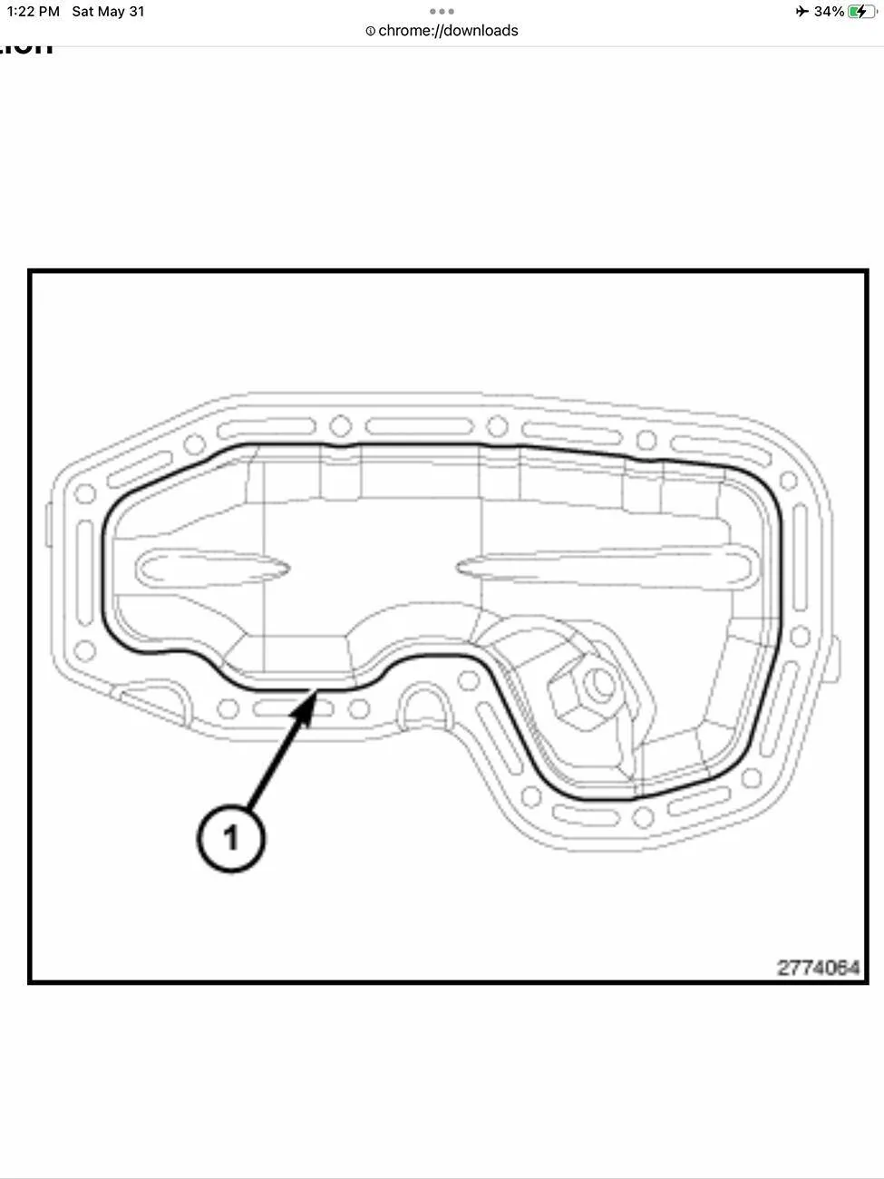

Most YouTubers put the RTV in the oil pan valleys and around the holes. Here’s a Chrysler illustration that shows the RTV on the inside of the oil pan valleys which make more sense to me. I know not our 3.6 but similar.
