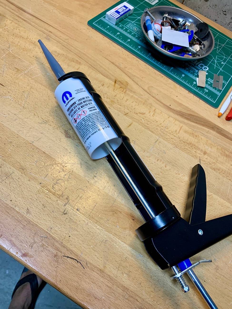

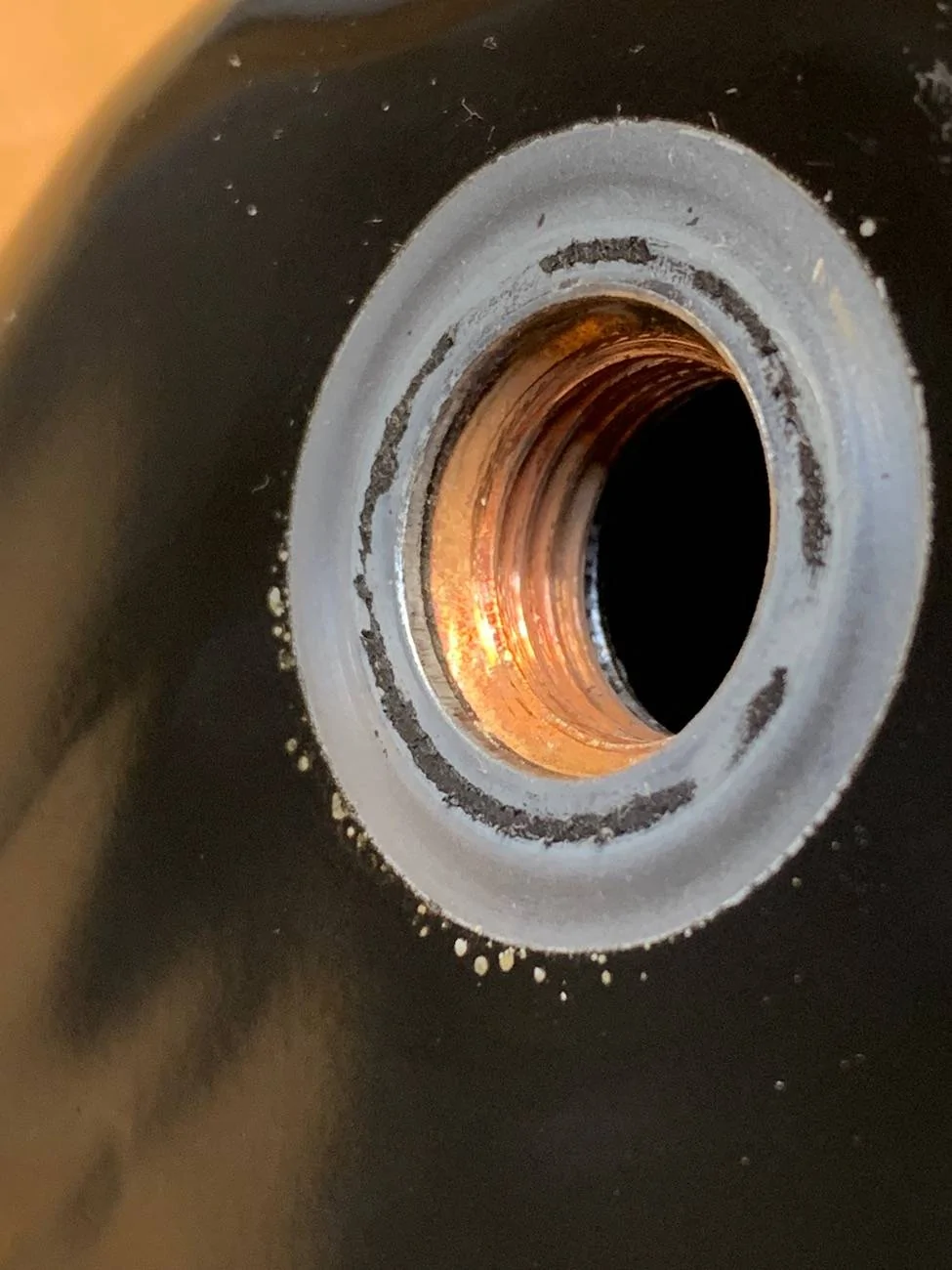

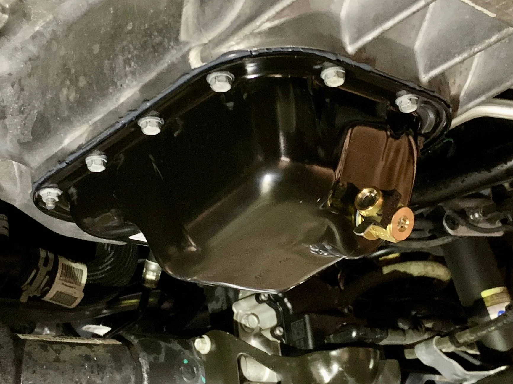

I’m staging my supplies for a lower oil pan replacement. Probably will do it this fall. The old cross threaded bolt seems to be sealing ok thanks to the generous rubber washer Mopar uses. On the new OEM female drain threads, it looks like copper.

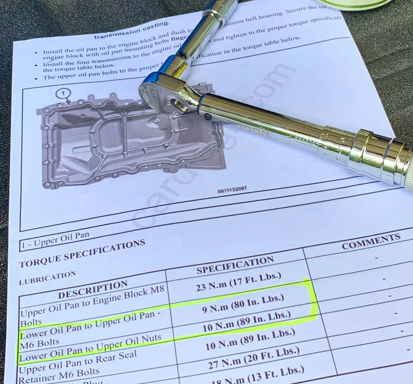

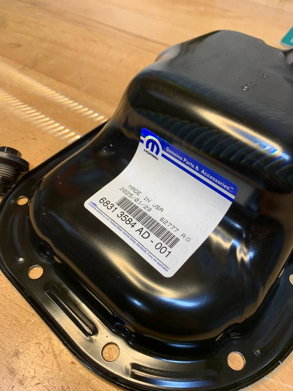

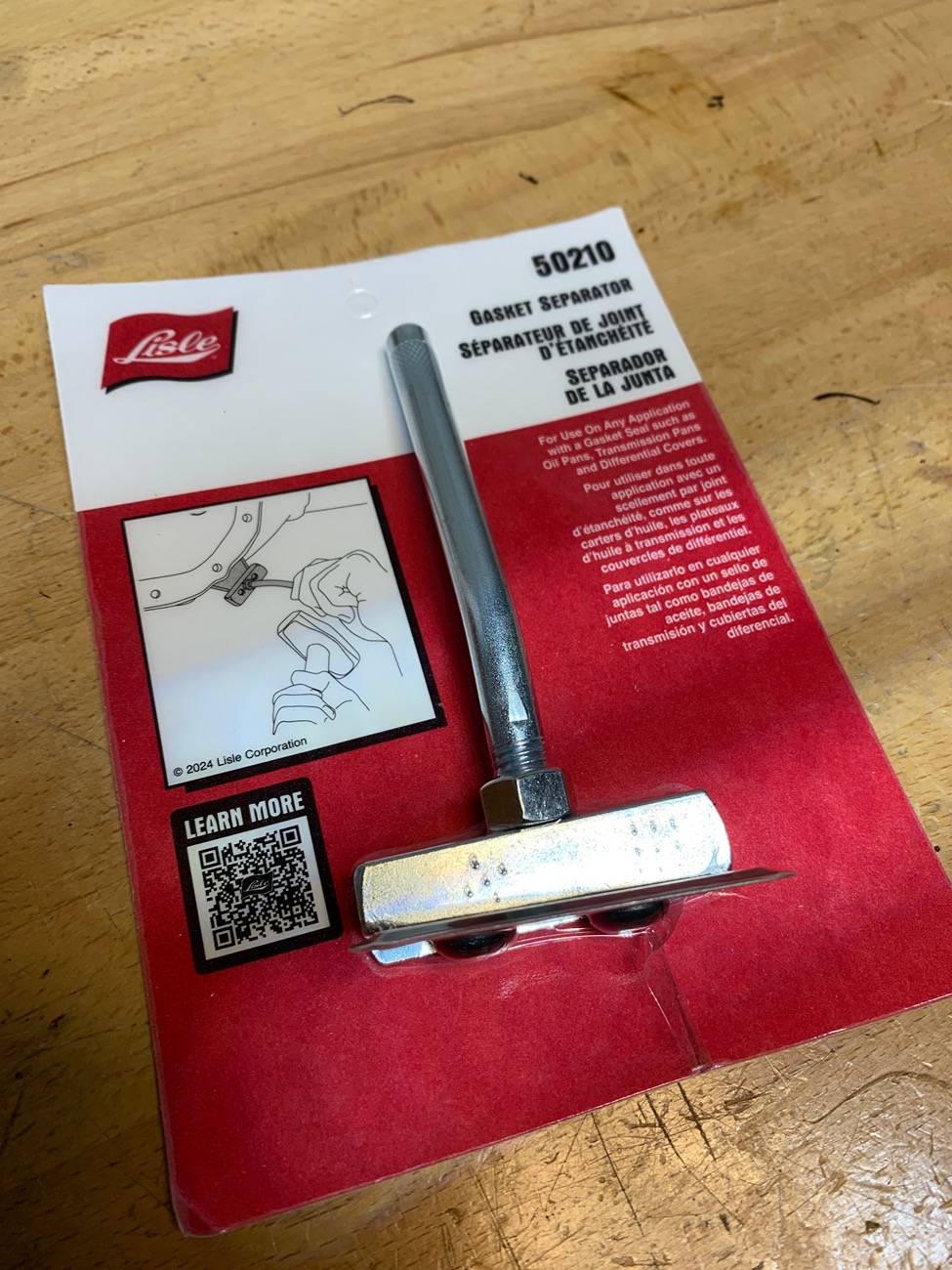

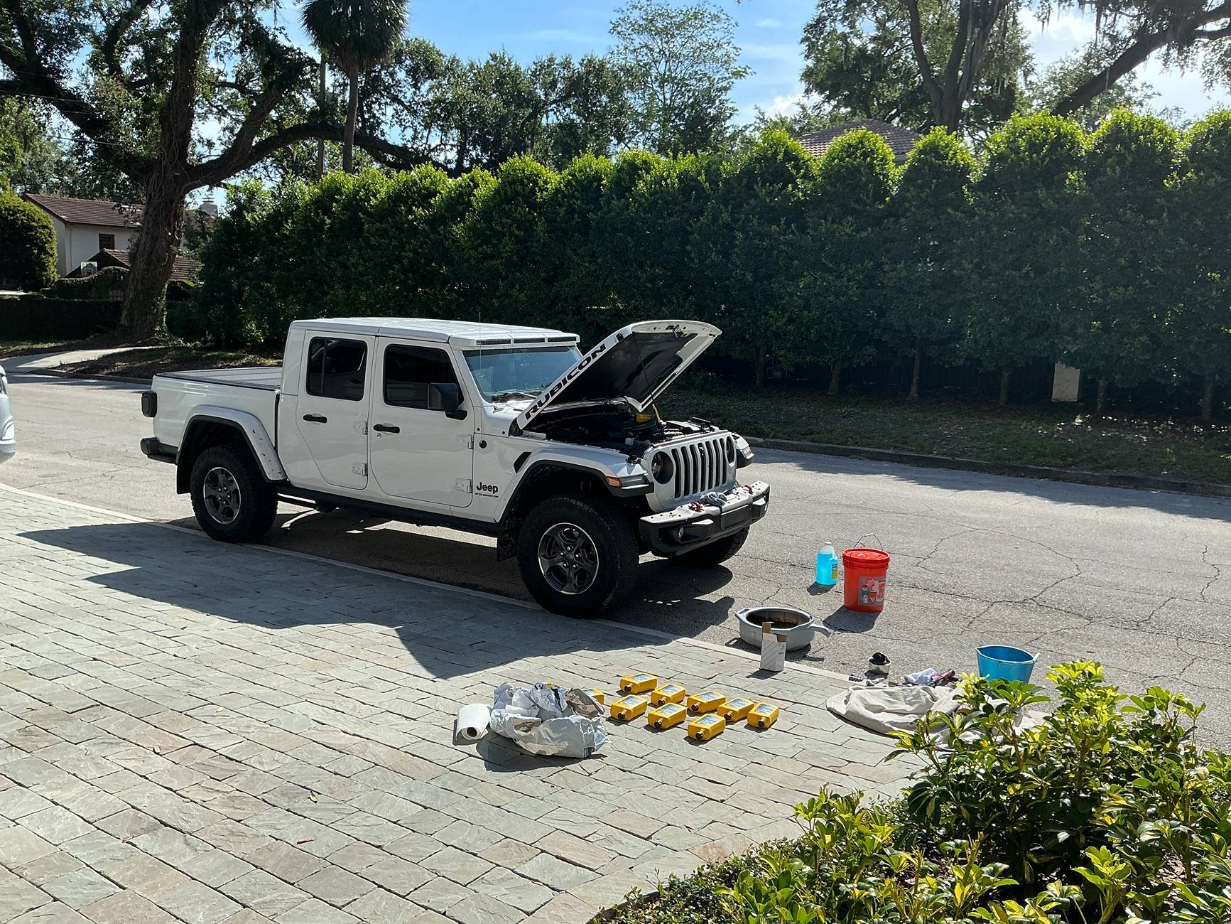

Went ahead and replaced the oil pan. Was going to wait until fall, but without having a heated garage, I thought the RTV application and curing would do better in the warmer weather. Had to make a quick trip to Harbor Freight (sigh) to get a Icon torque inch Lbs. wrench. My other torque wrenches would not that low. So far no leaks.

Does that new pan have a protective lip in front ahead of the plug hole to protect the plug !!!! When did they start doing that !!! 🤔
