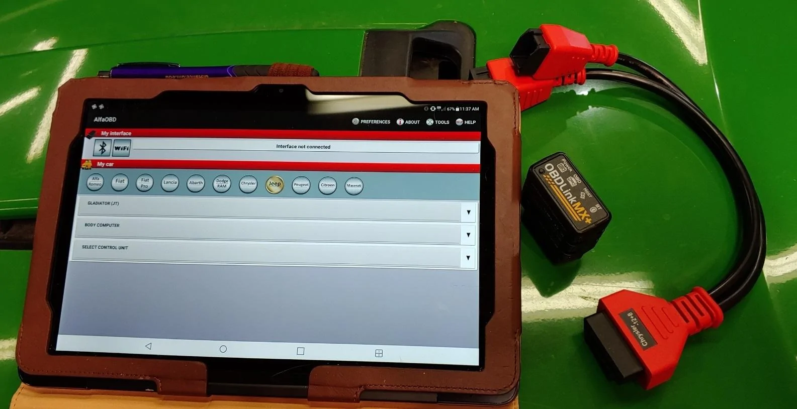

This is the security bypass cable. Without it you can only read things, you cannot actually change things. It bypasses the "firewall" up under the dash.
https://www.amazon.com/gp/product/B07S91VZXT
This is the OBDII bluetooth adapter I originally bought. It works for most things but some settings can't be changed without a higher speed device -
https://www.amazon.com/gp/product/B06XGB4873
I later bought this adapter to access other areas - my wife would smack me for not buying the very best I could buy the first time out but then I thought the other would do. Well, it would, but me being me, I wanted to access the far side of the universe...........
https://www.amazon.com/gp/product/B07JFRFJG6
You only need ONE of the above adapters. For most the cheaper one would do most things just fine.

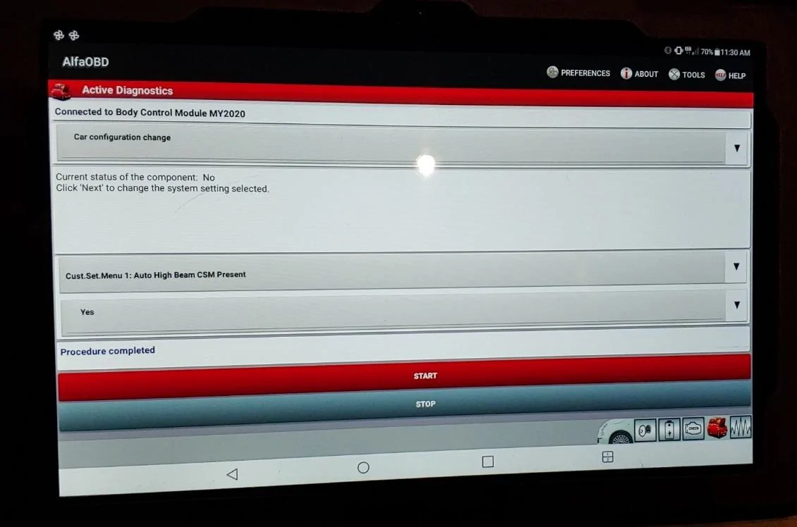

My dealership wanted to sell me a $100 "service contract" where they would add the custom tire size to my sales record in the FCA system. If they ever do a PCM flash/update, those settings are tied to the VIN (like sales codes)
They are finding more and more ways to make money...
Yep, been there, done that. Mine was $125. The service contract is with Chrysler, or rather Stellantis though, not the dealership. My tire size actually shows up on my vehicle specs now, as a dealer installed option. I have a tazer, but went ahead and paid the service fee anyway, because I wanted it officially recorded. Now it won't get overridden, and I don't have to worry about the tazer, losing my settings with updates, or any "unauthorized" modifications. I just wanted it officially sanctioned, and assurance that it wouldn't cause warranty issues later. I think that might be why some (not sure if all?) dealers are limiting to 35", for warranty purposes. I can imagine 37s breaking things, but these being engineered for up to 35" to stay within the margin of safety.
40,514
54,044
After I added the passive entry system to my JT, and I got all of the changes programmed in and it was working great, I went to the dealer for my WAVE services and asked them if it was possible to have them contact Jeep and have that sales code added to my VIN so any future flashes of that module wouldn't undo everything - meaning I'd have to reset the programming to make it work.
I said I'd be willing to pay for it. (I did explain that when I ordered the truck we told the sales guy we wanted the passive entry but he missed getting it ordered)
When my truck was done they had not only gotten that taken care of, they flashed the module with the new download from Jeep and it worked fine. And - no charge.
It does show up on the Jeep site when I lock in and choose my vehicle as a "dealer installed option" but that's fine, it didn't cost me a thing for them to do it. Let them take credit.

I can't recall what I couldn't get to with the lower cost adapter but it wasn't what most people would care about.
I have JSCAN on my phone and AlfaOBD on my phone and on my tablet. But then some might say I'm sort of a "nerd" and love to tinker and discover.

I am very curious, though - yes, you can read codes, yes you can reset them because it bypasses all vehicle security in itself, but question -
Does tazer show you specifics like this - and can you print them - in this case there's no code to read, no code to reset.........?
