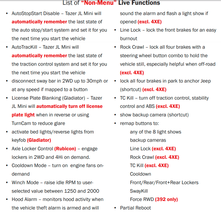

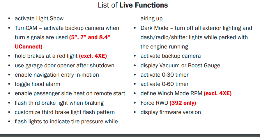

I see people saying that all the time but I have yet to see anything it does that I want or can't do otherwise.
Well, depends on what you want to do? :P
Here are basically all the things the Tazer can do that Jscan can not. Again, not everyone wants all of them, but if you want even ONE of them, there really are not other options, except for the Auto Start Stop.
I happen to like the ASS disable and the turn cam. I can't see the 3rd brake light strobe, but I know when I see it on other vehicles, it does get my attention, so that's a good thing. I occasionally use the easy activate backup cam, and I find myself using the feature to turn on the bed/reverse lights from the fob VERY handy. People who go to drive in movies seem to like the dark mode feature a lot too. And of course, turning off the license plate lights in reverse makes a HUGE diff using the reverse cam.
Those are all features you can't get with Jscan. For me, it was worth the extra $$$. For you it might not be.

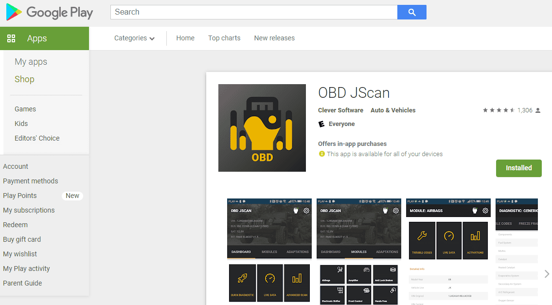

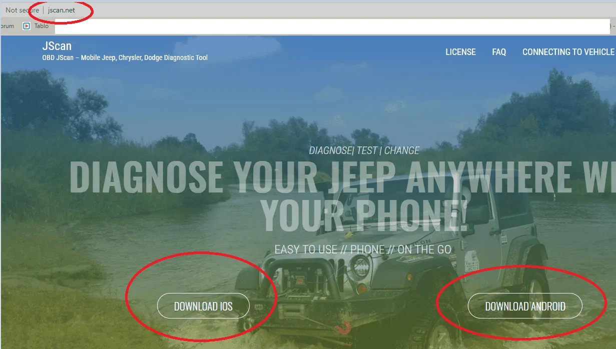

I don’t understand the jscan thing. I went on their website but there’s nothing there to buy.
JSCAN. NET (not COM)
Jscan is software and i believe you download it on their site or if Android, download it through the Google Play Store as I recall... Then yo buy the license for your VIN
