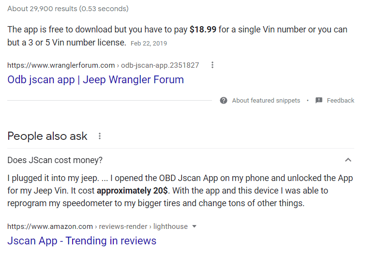

Like any app that is connected to Google Play Store, it will tell of "in app purchases" - but the only purchase needed is the license for the VIN you plan on using it with. That's it. So you can ignore that huge range of numbers. I think last I checked it was something like downloading the app itself is FREE, then you go into the app and make a purchase for the license for the VIN - about 21 bucks. IF you want to use it on a second Jeep, you buy another VIN license. You can download and play with the app for free as I recall, then buy the license as needed.
Any app that connects through the Google Play store for anything apparently has to include some disclaimer about in app purchases and that sort of thing. All you care about is the license for the VIN at about 21 last I knew. That's what I paid for the license for my JT VIN about 2 years ago.
I can't recall what I couldn't get to with the lower cost adapter but it wasn't what most people would care about.
I have JSCAN on my phone and AlfaOBD on my phone and on my tablet. But then some might say I'm sort of a "nerd" and love to tinker and discover.
Every other paid app I have, I knew in advance how much it cost before I installed it. AlphaOBD is clear on both it's website and on the Google Play install page how much it will cost before you download it. Jscan's website mentions it can be licensed for 1, 3 or 5 vehicles, but I can not find mention of what those costs are. The install page just tells me it's going to cost me somewhere between " $0.99 - $169.99 per item" with no description of what that buys. What does Jscan do for me if I only spend 99 cents? What does $169.99 get me? No idea. I'm not a fan of having to install a program to find out how much it's going to cost me to use. That seems shady right there. It's like going shopping, and nothing has a price tag, and you have to have the cashier ring it up, bag it, and have your credit card in hand before you know the price.
I decided to look at the Apple download page, even though the only ios device in the house is my wife's work issued phone. I see Apple lists the app as free, but "1 vin license costs 99,99 zł" which meant nothing to me until a google search says that zl is Polish Zloty and 99.99 of them currently equals $25.15 and that 3vins cost 259.99 zl or $65.39 at today's exchange rate. I'm guessing Android pricing will be the same.
Back to AlphaOBD. I believe you've said it's harder to use than Jscan, but also more powerful? And unlimited vins? Seems like even if I just use it on my 2 jOBDII enabled Jeeps, it comes out ahead of Jscan. If it works on my 2007 Ram 1500 (as I read the website, it currently doesnt? Only 2500 and up Rams of that generation?) even better. Best yet, AlphaOBD is very clear about offering a free demo, so I can see if the current adapter I have even works. Jscan seems to imply their demo is just of the app itself, and does not actually interact with the vehicle.
Of course, since I already have the Tazer, I would really only need it for the JK, but I still don't mind paying $24 extra for a better or more useful product.
40,514
54,044
The tazer does show all of that information, but you can't print it (I don't think). it shows up in the center stack. However, that's not app specific. Any Bluetooth reader will show that. I used to use the torque and carista on my VW. No reason it won't work on the jeep too. Tire size changes aside, the best thing about the tazer is the off-road functions. It's like an extension of off-road+ on Rubicons and Mojave (and of course, it adds them if you don't have Rubicon on Mojave, all displaying in the gauge cluster). Lock both diffs in high swaybar disconnect in high, etc. And like the jscan, you don't have to leave it plugged in. That's only for the live functions. I don't plug mine in any more unless I'm off-road, because I hate the license plate light blanking, which is a live feature you can't turn off, and I hate the light show, which I've accidentally enabled before.
Funny thing about OBDII - it's a standard, but there are so many OBD............ for example, I've tried multiple adapters and several pieces of software and dedicated handheld readers - none could read my WJ ABS.
I have Torque lite or whatever it's called - the free version. Nice gauges and such for a free app.
Like I said elsewhere - that's Google, not JSCAN. It tells you there are in-app purchases as a matter of policy and Google puts in the numbers as that's the range most in-app purchases are. But the JSCAN pages tell - or told - when I bought it was 21. I knew that before I even downloaded the app. Unfortunately what you see on Google Play is their generic "this app has in-app purchases" and their blurb on prices. That's not JSCAN talking.
There should be several threads here that mention specifics on the cost per VIN license.
There isn't anything shady really - that's a generic "your mileage may vary" from Google.
Download OBD JScan app from Google Play store or Apple Store – application is free to download, but license is required to change vehicle settings and access all available options on the app.
Purchase compatible an OBD2 adapter*
Connect to your vehicle
Purchase license for your vehicle VIN, license is not required to connect to a car. *
*list of recommended and supported OBD adapters can be found here:
http://jscan.net/supported-and-not-supported-obd-adapters/
* most of Chrysler/Dodge/Jeep cars 2017-2018+ will require bypass security gateway to allow any vehicle modifications. “Autel Chrysler 12+8 adapter" Read More
* license purchase options can be will be presented when you connect to a car or you can check available licenses under “Settings -> Manage Licenses" (connection is not required)

You have to download the app to get the correct price. Google gives you some random price range, but JSCAN gives you their actual price. I got the app and licenses for My JT, JKU, and charger for less than $200. But through the app. You don't use google on your car so don't trust them to know the actual price.
40,514
54,044
And going through Google Play Store to sell licenses and such - it's a convenience, otherwise the programmer/vendor has to have a "shopping cart" or a site that can handle such things. JSCAN pays Google to handle transactions, track sales, deal with credit card, fraud, security and all that stuff. So the guy who programmed/created/keeps current the JSCAN app can concentrate on the app and pay Google to deal with credit cards and such. Build an app and sell it on Google Play and they provide all the libraries and code to put into your app to sell licenses.
My son has built sites and code for sites such as cars dot com and Gannett and we talked about his work - Google provides a lot of libraries to deal with sales and commonly used things.
It costs the programmer to sell through Google but Apple and Google leave programmers little choice these days - want to sell or provide your apps to our devices and operating systems, you must sell through us and pay us for the privilege.
All you have to do is contact JSCAN and he'll let you know what to expect.
If you have multiple FCA or Jeep vehicles he does offer 3 and 5 VIN licenses bundles and may do other bundles, too.
