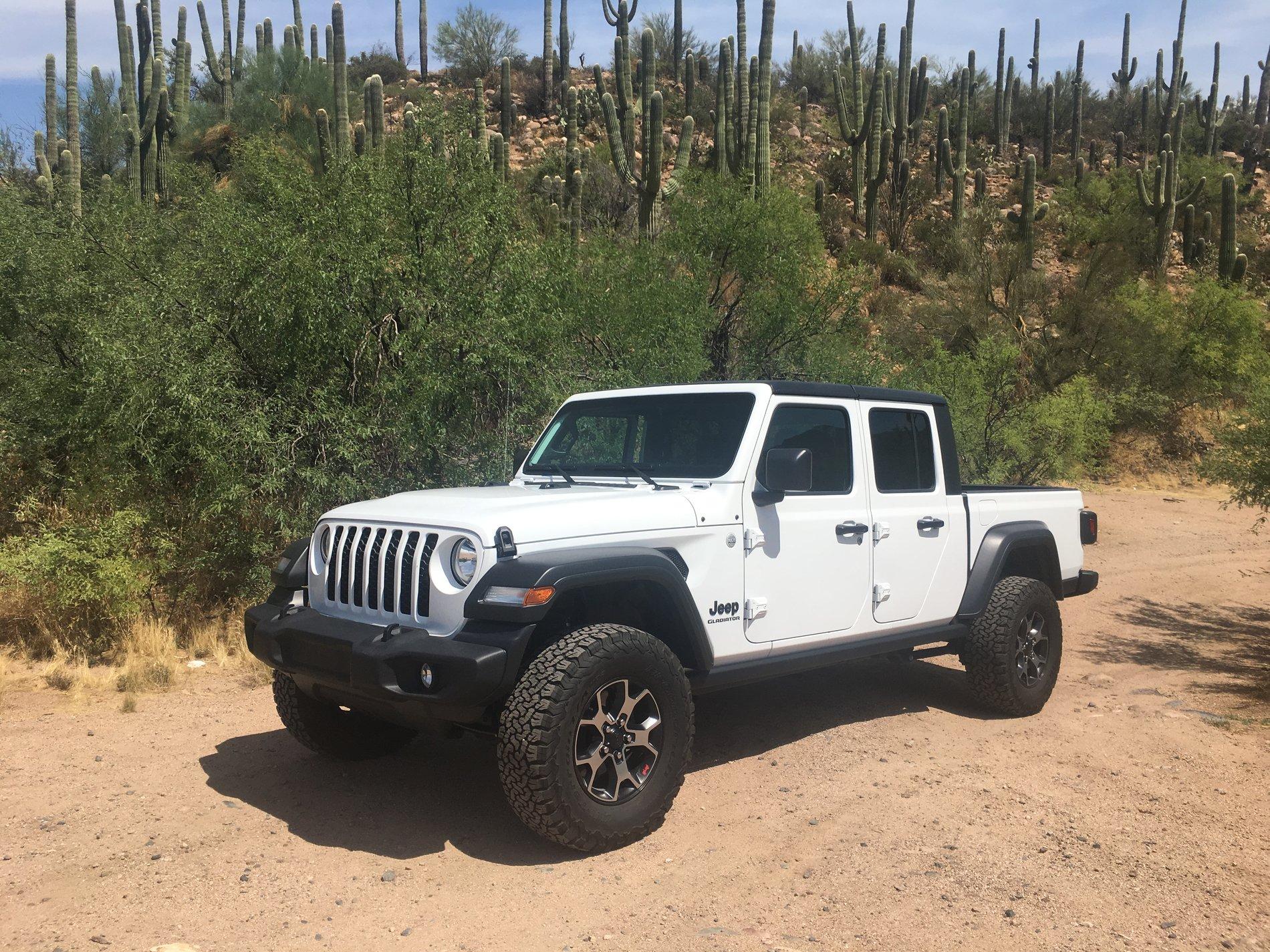

These are from the sports s with cheap tow package.
