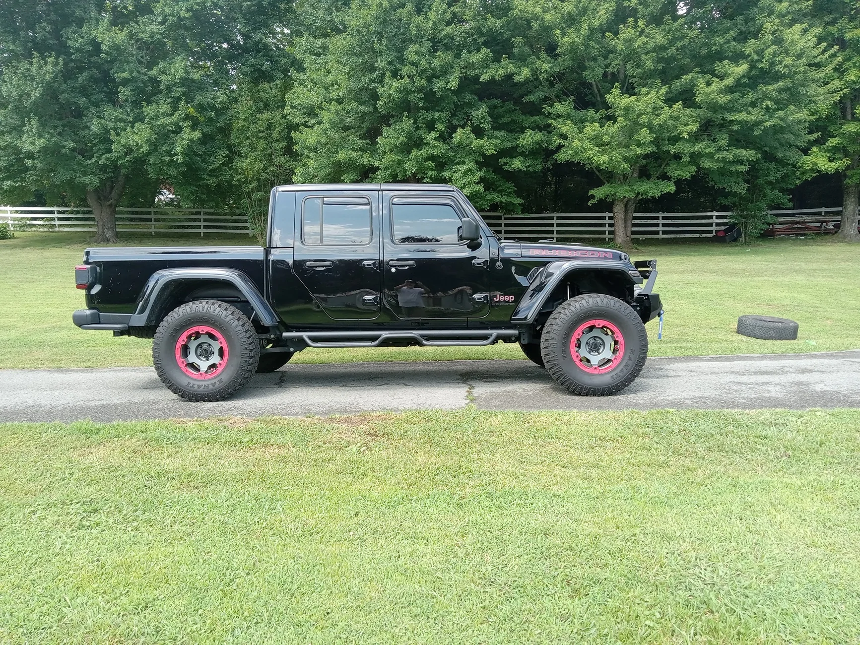

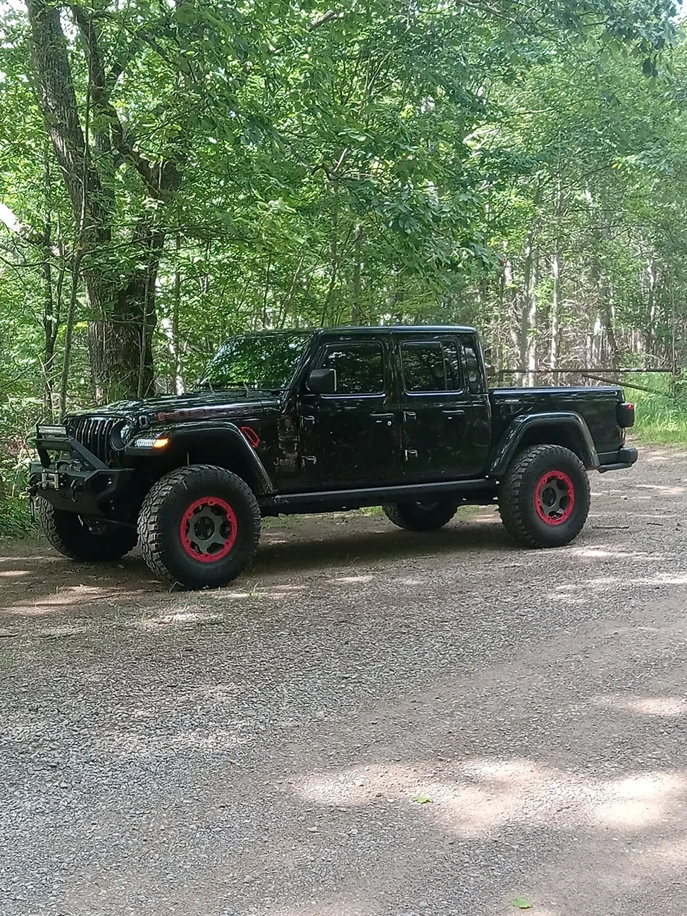

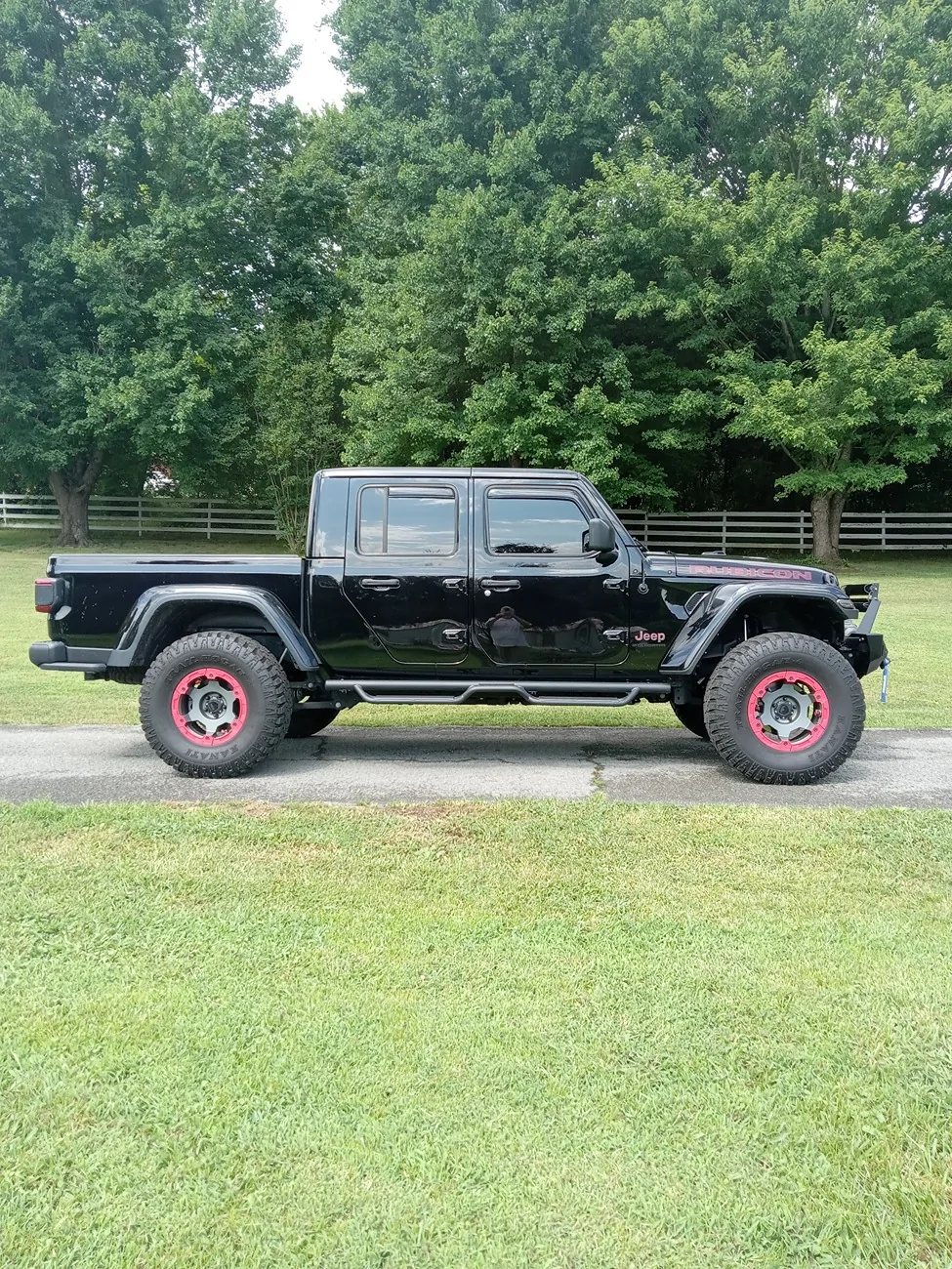

I have the same lift on my 2023 Rubicon, but with 37's. I believe that it comes with an adjustable track bar, but I am on the original control arms. I do have the upgrade of their N3 Nitrogen Shocks and I have no complaints. It rides/handles better than the stock Rubicon suspension. I am going to add either the geo correction brackets or longer/adjustable control arms just to see if additional caster improves either ride or handling. I did purchase a carrier bearing drop for it, as I believe it necessary for rear pinion angle. I have not installed it yet.
After a few thousand miles it still has enough lift that the 37's even appear small to me at times.
