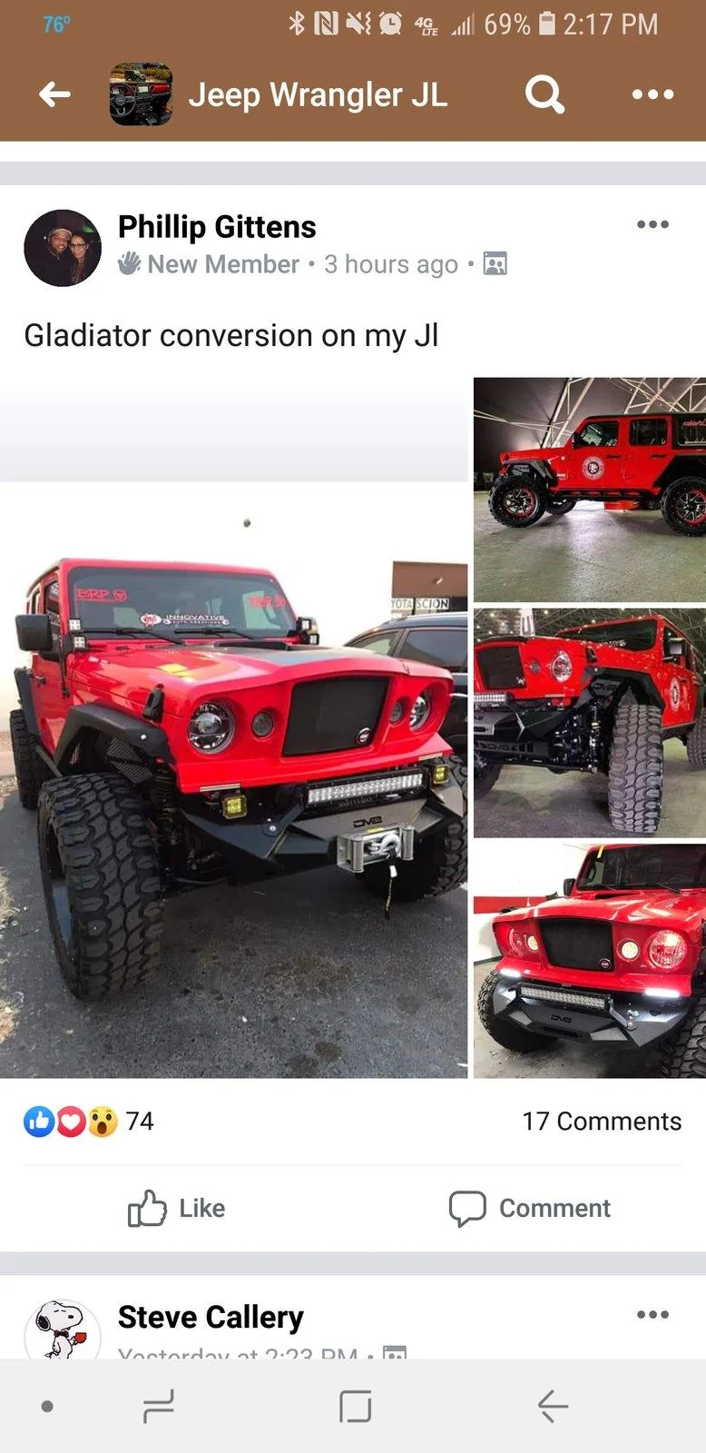

Chance for better cooling? Someone put it on a JL, kind of curious how it would look on a Gladiator.
