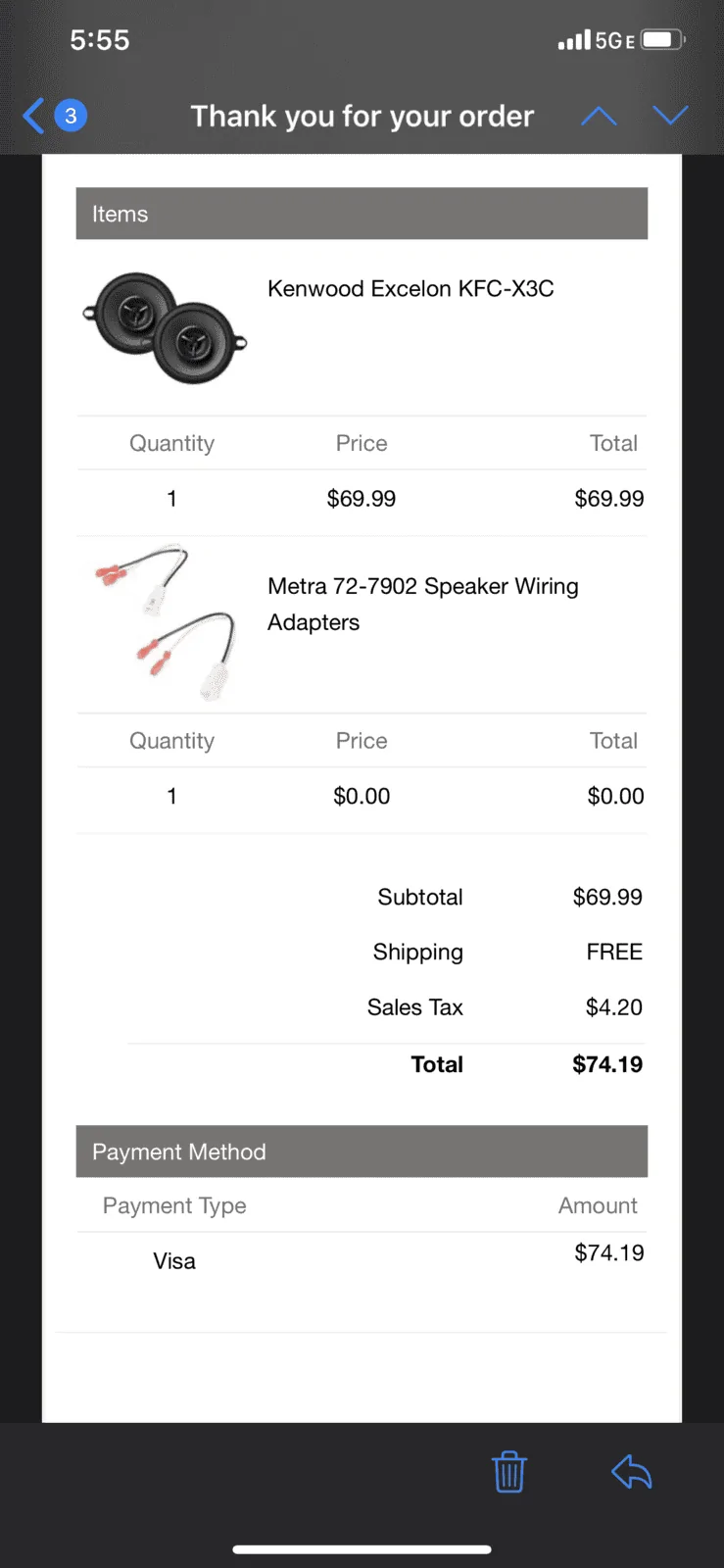

Thanks for this information! Just got my JT last week. It has the mid-range audio system. I don't know if it has a subwoofer, but I'm pretty happy with the bass. However, I was thinking it sounded a bit muted and some new corner speakers with good tweeters would help. Here's the answer.
I put an aftermarket Alpine sound system into my 2000 Cherokee. I installed small woofers in the doors and tweeters up high on the door panels. The tweeters are really spiffy and came with capacitors built into the factory cables. So, I'm wondering if Alpine makes a direct-fit speaker, with a really nice tweeter, for the JT. I suppose a call to Crutchfield would be worthwhile.
Klutch
May 25, 2019
818
1,005
Colorado Springs
1986 Jeep Comanche, 2000 Jeep Cherokee
I installed the Infinity REF-3032 speakers in my dash yesterday. I did not see anyone mention these speakers require capacitors to be installed on the positive side. The capacitors come in the box, but it's not obvious in the instructions. I called Crutchfield and they confirmed the capacitors are supposed to be installed and the warranty would be void I didn't install them.
The rep at Crutchfield said those capacitors prevent high sounds from getting to the speakers, but I think she is mistaken. As I understand it, in a crossover network, capacitors filter out low frequencies and inductors filter out high frequencies. (In a crossover network, you connect the tweeters to the capacitors, the woofers to the inductors, and the midranges get both.) Therefore, the extra capacitors likely filter very low frequencies to keep the speakers from clipping. The tweeters also have a very a small capacitor which is in place from the factory; likely to filter out all low frequencies.
Anyway, I really like these little speakers! While I thought my factory audio system sounded good, it was a little muddy. The Infinity tweeters up in the dash really brighten things up, but they're far from overwhelming. With the recent passing of Mr. Peart, I though it fitting to test the new speakers by cranking up some Rush. While I'm not the ultimate audiophile, I am somewhat of an audio snob. Wow, this system sounds great! Personally, I'm not impressed by car audio systems with multiple, massive subwoofers designed to rattle buildings. If that's your thing, cool. But the music I listen to, like Rush, is not supposed to sound that way. Right now, my JT sound system makes it seem like Neil Peart is hitting his double base drum right in the back seat and that's the way I like it.
So, I'm extremely happy with these little speakers. But again, be aware if you install them, you must install the included capacitors on the positive side. I soldered one end of the capacitor to the positive terminal on the speaker and soldered the other end to the positive clip on the little harness. It was a snug fit, but I got everything in the factory speakers holes just fine after grinding off the edges of the speaker mounting tabs.

Odd, I got the same speakers and the CAPs were already installed.
Jeep Gladiator Does the upgraded Alpine system include a subwoofer? upload_2020-1-13_8-25-17
Got mine from Crutchfield also.
