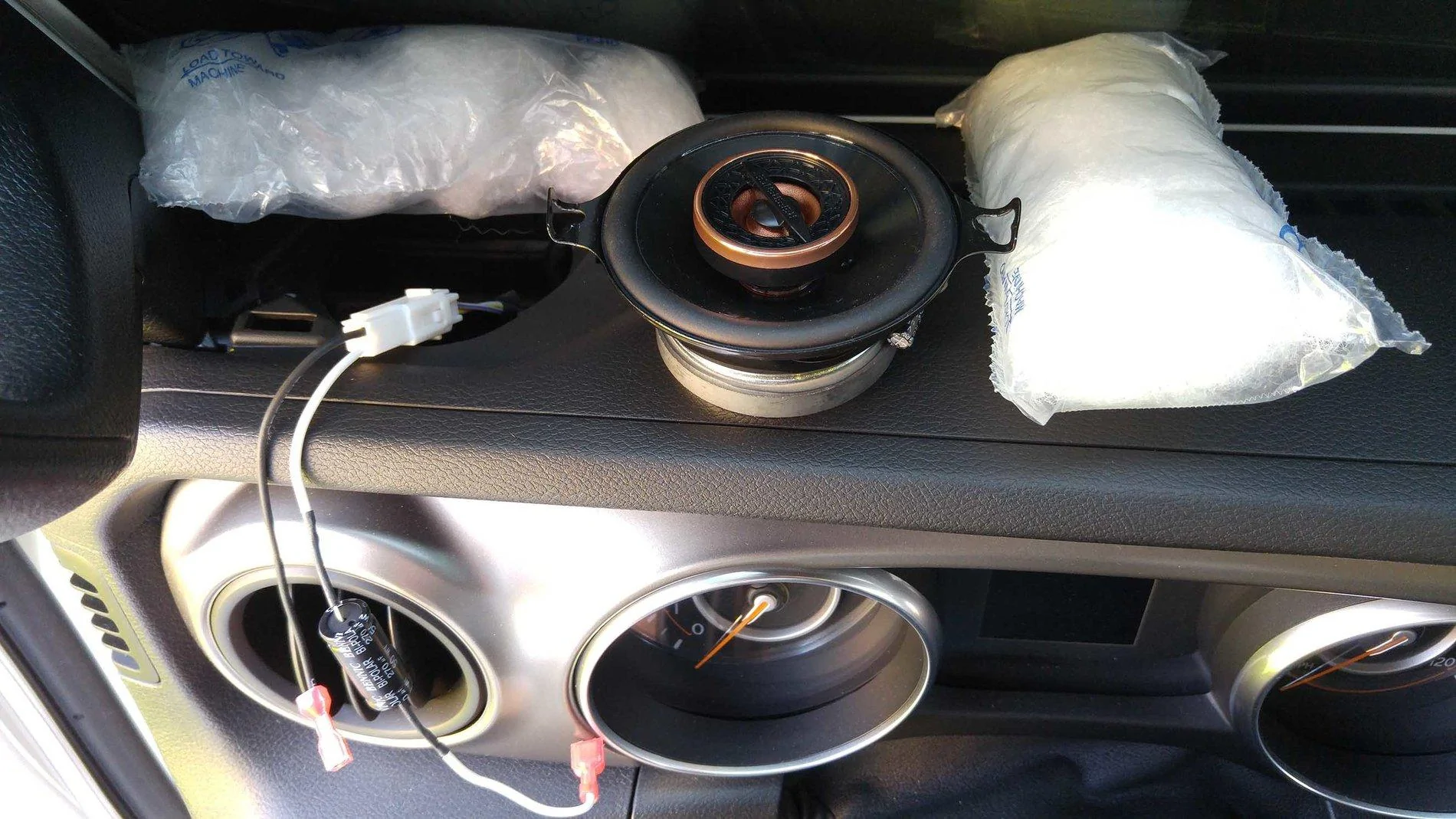

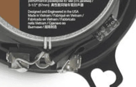

Those are the small capacitors for the tweeters which I mentioned are installed at the factory. There are two additional, larger capacitors in the box kind of hidden within a slot in the styrofoam. Sorry, I should have taken pictures of the larger capacitors. If you still have the box, check it. You will likely find the larger capacitors.
If your speakers are working fine, cool. I just wanted to share that there are two additional capacitors which the manufacturer wants us to install.

Here's a picture of one of the speakers with the capacitor installed. (This is from the Jeep Wrangler forum.)

Well now I'm going to check the box!!
And there they are!!! So dug through all the instructions that came with those and no mention of the caps...where did you see the info for the Gladiators/JLs that these are to be used?
Thanks!
So I see now what's going on. The capacitor that's on the speaker (the smaller one) is for the tweeter inside the cone. The larger capacitor is for the 3.5" cone driver. The 270uF cap according to Infinity is a cutoff at 196hz 6db/octive. According to other charts it's more like 150hz but maybe Infinity is accounting for the 6db rolloff starting point.
The bigger question is...does the stock Alpine amp already filter the low frequencies going to those dash speakers? Or did the stock speakers have a capacitor on them? If the Alpine system is acting as an active crossover you are better off leaving the larger caps off. If the Alipine system is NOT acting as an active crossover then the caps should absolutely be installed.
