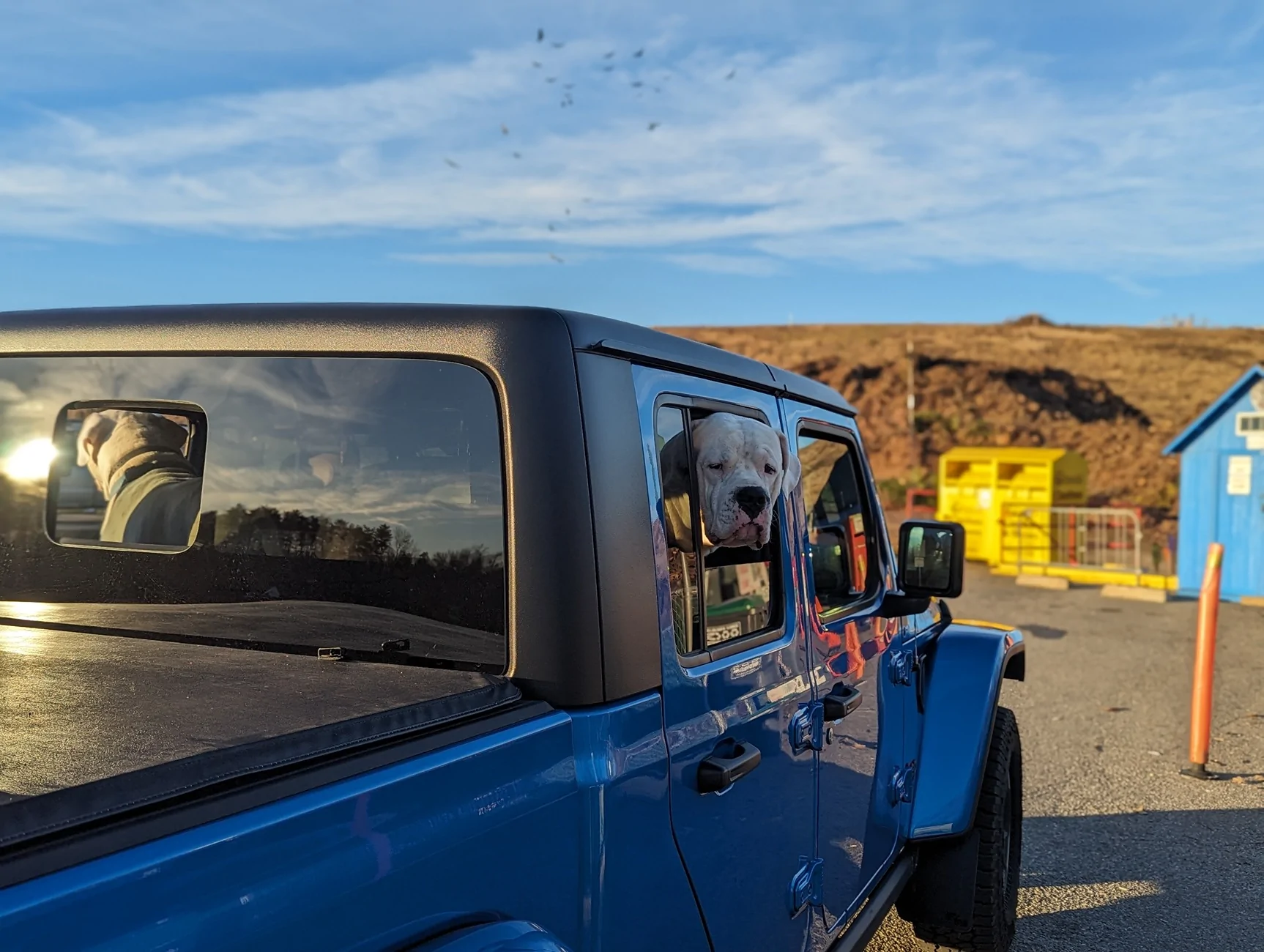

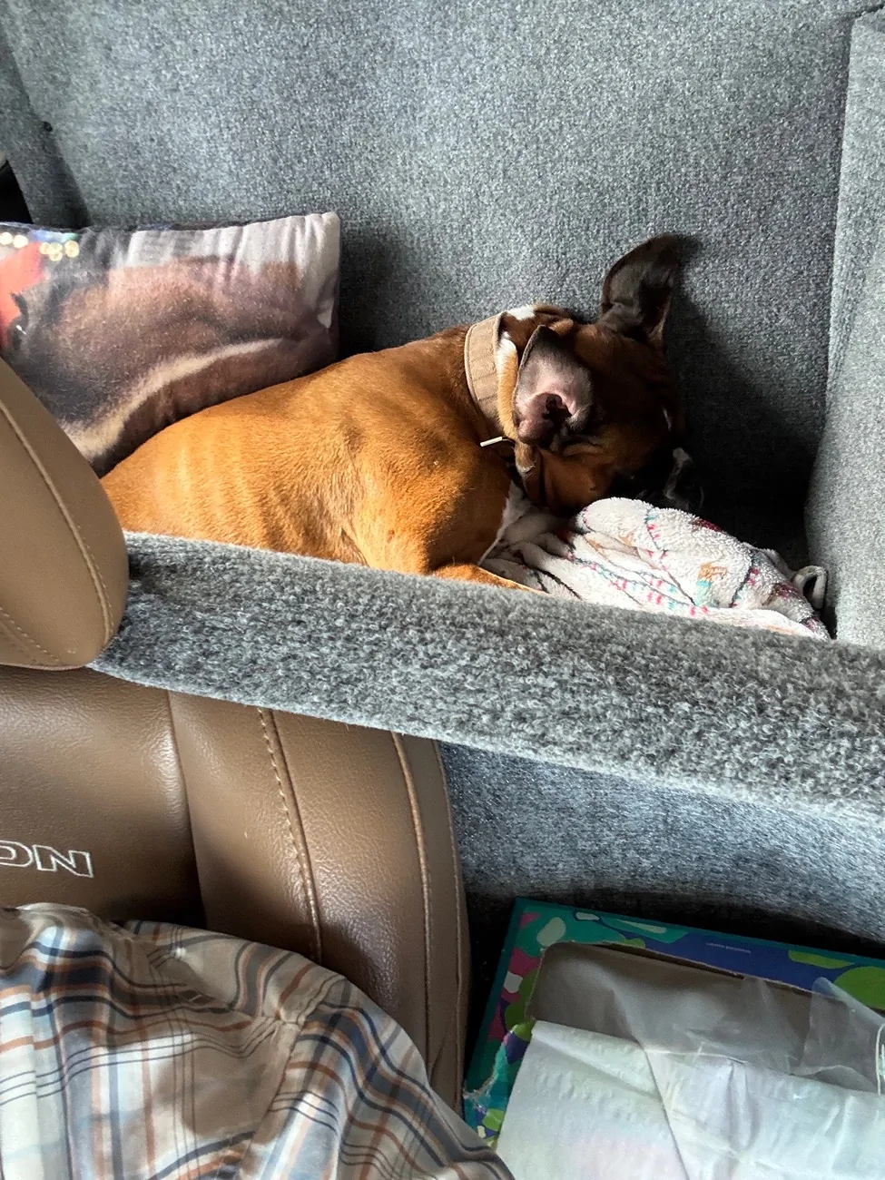

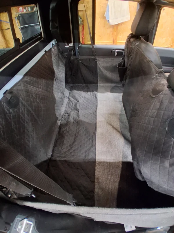

I've got a hunting pup, that loves mud, stickers, and anything really stinky she can shoulder roll in.
She is way too spoiled to ride in a crate in the bed of the truck though.
The build is how I attempt to keep the mess somewhat contained, while not taking away "payload capacity".
This is how it came out:
Jeep Gladiator Dog Mess Containment System (Home Made... mostly) Containment In Plac
Jeep Gladiator Dog Mess Containment System (Home Made... mostly) Hammock Shot

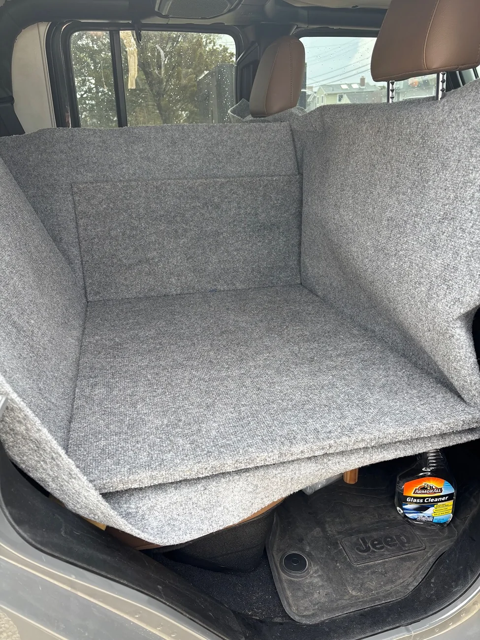

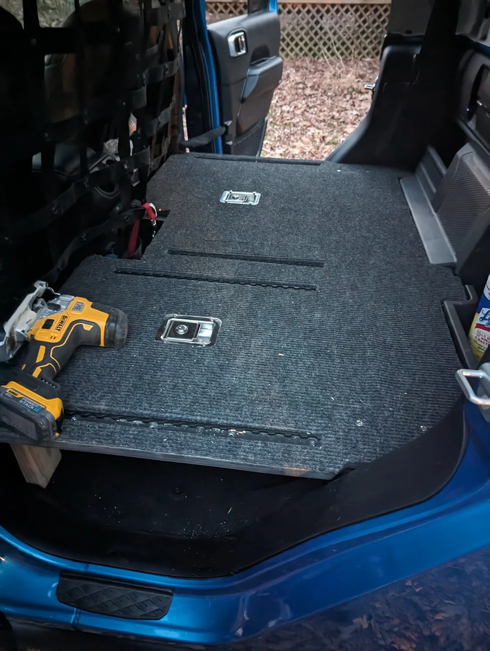

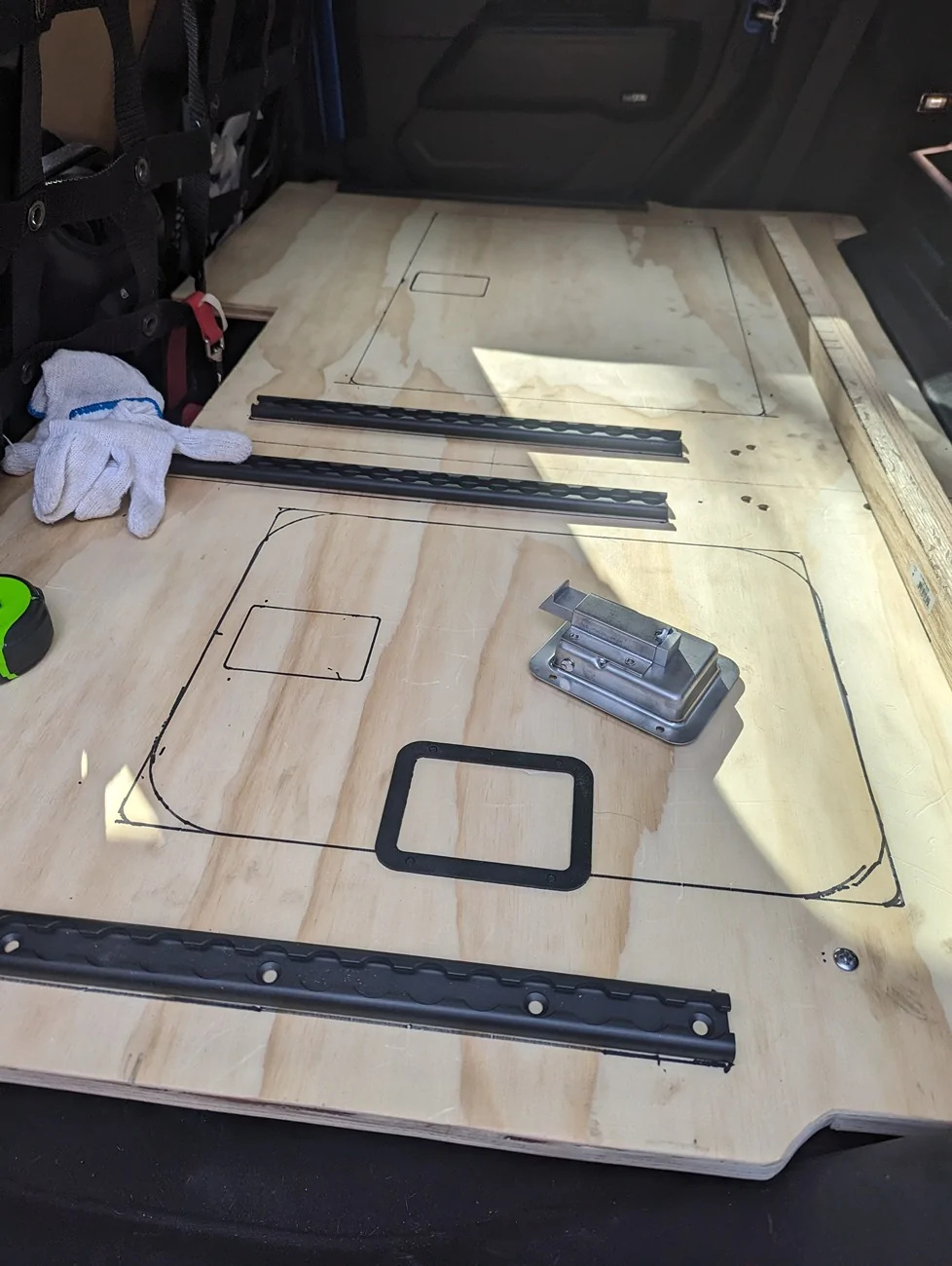

Removed the rear seats and made a lightweight flat floor:
https://www.jeepgladiatorforum.com/forum/threads/ultralight-rear-seat-delete-home-built.111164/
Added "coat hanger" hooks to support the dog hammock side straps:
https://www.jeepgladiatorforum.com/forum/threads/coat-hanger-hook-install-home-made.110937/
Made a rear window tray to hold the rear of the hammock:
https://www.jeepgladiatorforum.com/forum/threads/rear-window-tray-home-built.111167/

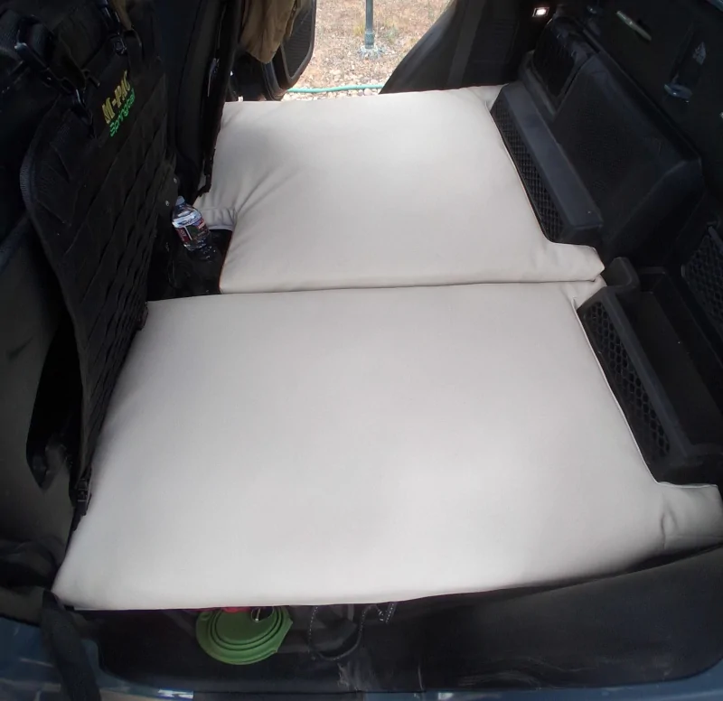

Went to an upholstery shop and had a couple cushions made to fit the floor. The Upholsterer recommended a specific kind of fill made from plastic filament material. Allowing for a lighter, thinner, more comfortable and durable cushion. They came out really nice. She had the vinyl material left over from another job and gave me a great deal on it (hence the color).
Jeep Gladiator Dog Mess Containment System (Home Made... mostly) Cushions

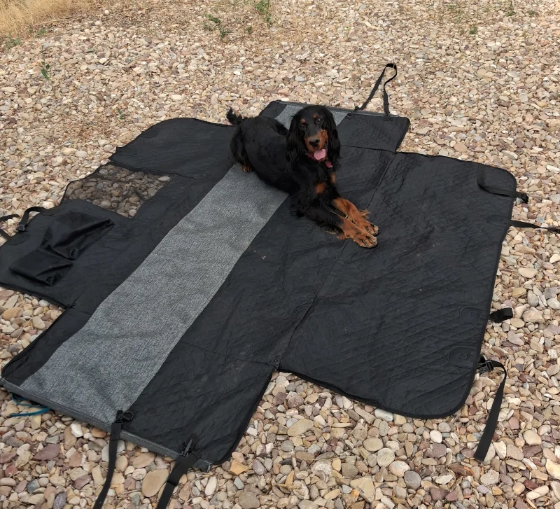

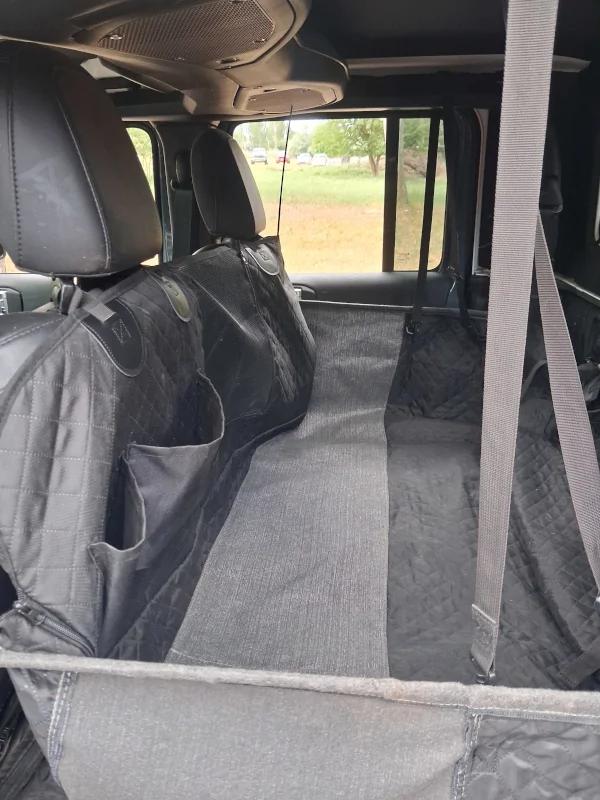

I had a dog hammock for a full size truck that she modified. It came with the center mesh which allows good airflow from the hvac outlets on the rear of the console. That helps blow the stink out the rear window.
The light gray material was added to make it wide enough to cover the whole floor. The bottom side is a rubberized material making it water resistant, but still washable.
She then sewed loops along the top edges of the two door panels ends.
I used a carbon fiber arrow shaft inserted in the loop on each end to stiffen the door side panels.
This allows keeping the support straps rearward of the window openings, so Super Spoiled Pup has the entire window openings to look out.
Jeep Gladiator Dog Mess Containment System (Home Made... mostly) Princess Glamor Shot
All projects in total, and the weight of Her Royal Highness come out to right about 60lbs. Which is less than the weight of the two seats that were removed.
Just a couple months until Hunting season, and we'll see how well this works... or doesn't.
Hope this is helpful to someone else considering something similar.

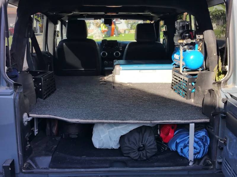

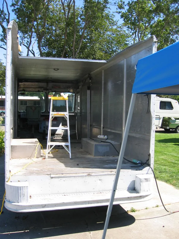

I did a raised floor in the back of the JKU-R made from aluminum sheet that was part of a side of an old retired Frito's Van (Grumman box van) that I de-constructed. That was 1/8" aluminum plate and worked so well both my German Shepherd and I could sleep on it.
Jeep Gladiator Dog Mess Containment System (Home Made... mostly) JKU Raised Floor
Bought the Frito van to get the 4BT Cummins engine for another project. The entire body was made from aluminum. Cut it up into the biggest pieces possible and used all the aluminum on other projects. What a treasure trove of great materials Grumman used in those vans. 🤩
Jeep Gladiator Dog Mess Containment System (Home Made... mostly) demo-5

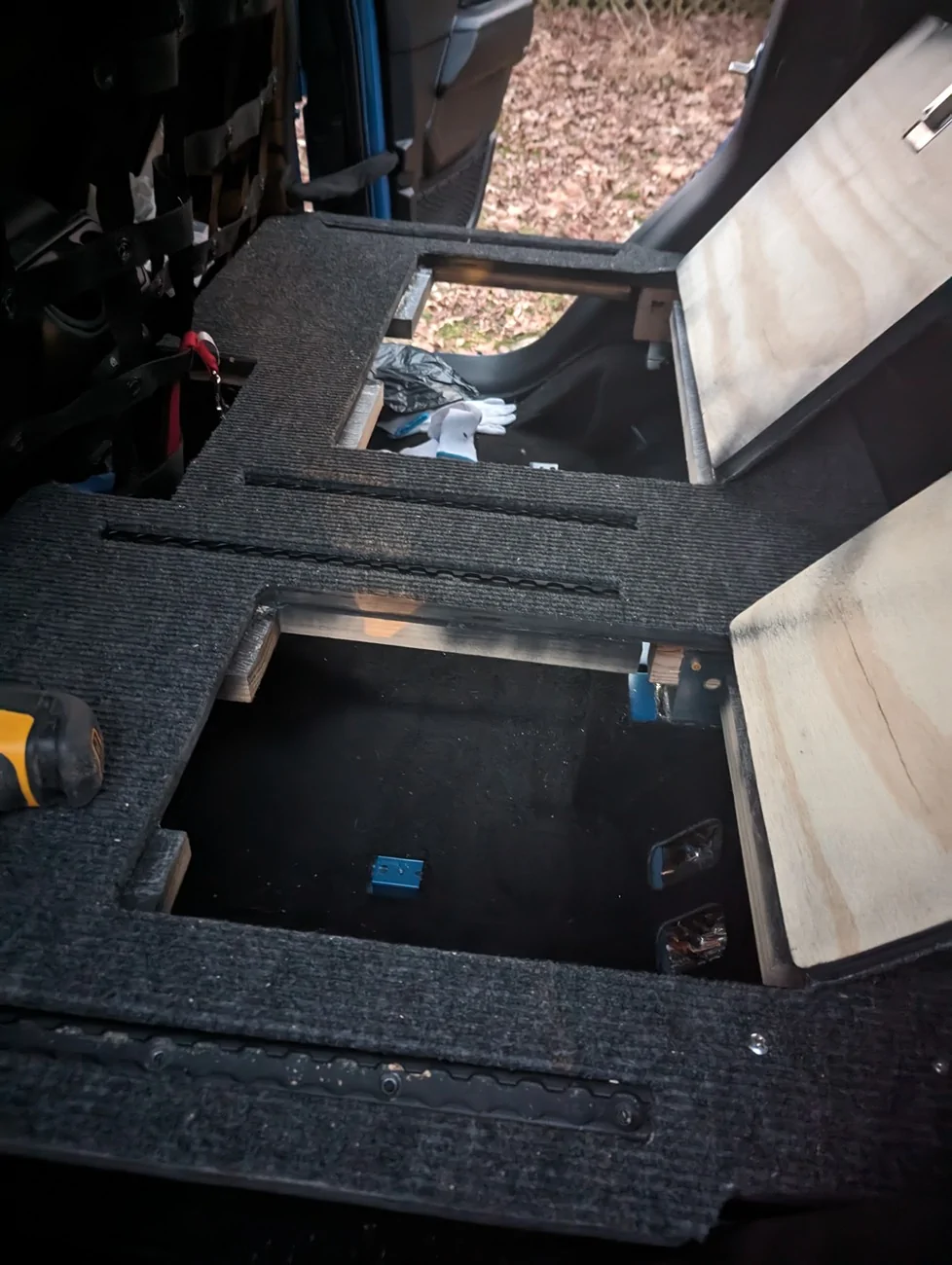

Jeep Gladiator Dog Mess Containment System (Home Made... mostly) 1000006331
Jeep Gladiator Dog Mess Containment System (Home Made... mostly) 1000006334
Jeep Gladiator Dog Mess Containment System (Home Made... mostly) 1000006329
built platform using 2x4 bases attached to L brackets using original seat mounting points. front of platform uses 2x4 supports to level platform. platforms have same 60/40 split and can be installed separately. I have door skins on inside to protect factory doors . Dirty dog net to separate front seat area so I don't have dogs up front assisting with driving. Indoor-outdoor carpet roll applied after building storage doors. 3 dogs ride in the back.... 2 120+ lb Dogos and 60 lb shepherd mix.
Jeep Gladiator Dog Mess Containment System (Home Made... mostly) 1000006333
Great work. Looks "pro built."
I'm envious of the hatches too.
