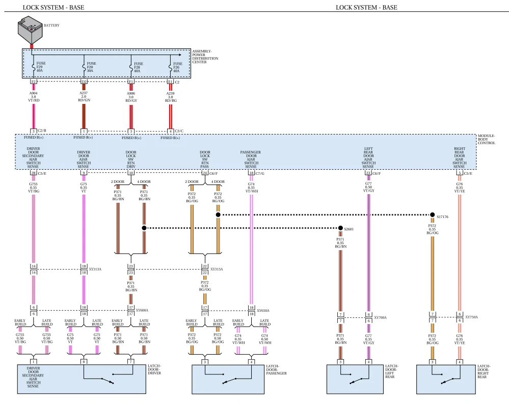

In this diagram... if it only cares about driver door; could I make a switch for connections #7 & #8?
did you check to see if the top four fuses at the top of the diagram are seated properly?

Not entirely sure if it would work on the gladiator but Should be able to wire a switch that connects to the door pin for door open/close that just grounds the position switch line. At least this is something I had to do to my jku when taking the doors off. I had power steps so it was how I made them work with no doors. Depending on the canbus system for the gladiator doors. May could do something similar.
