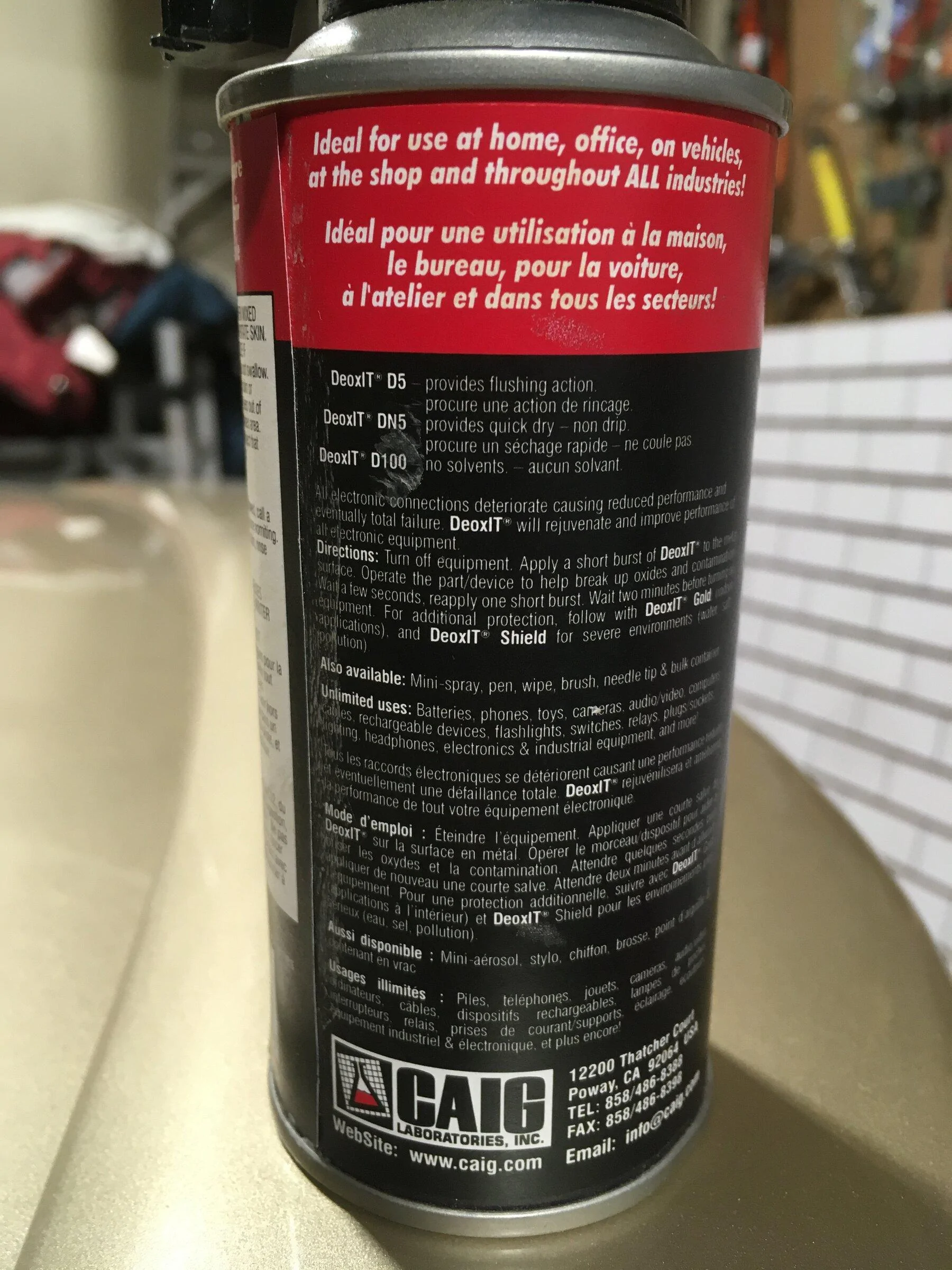

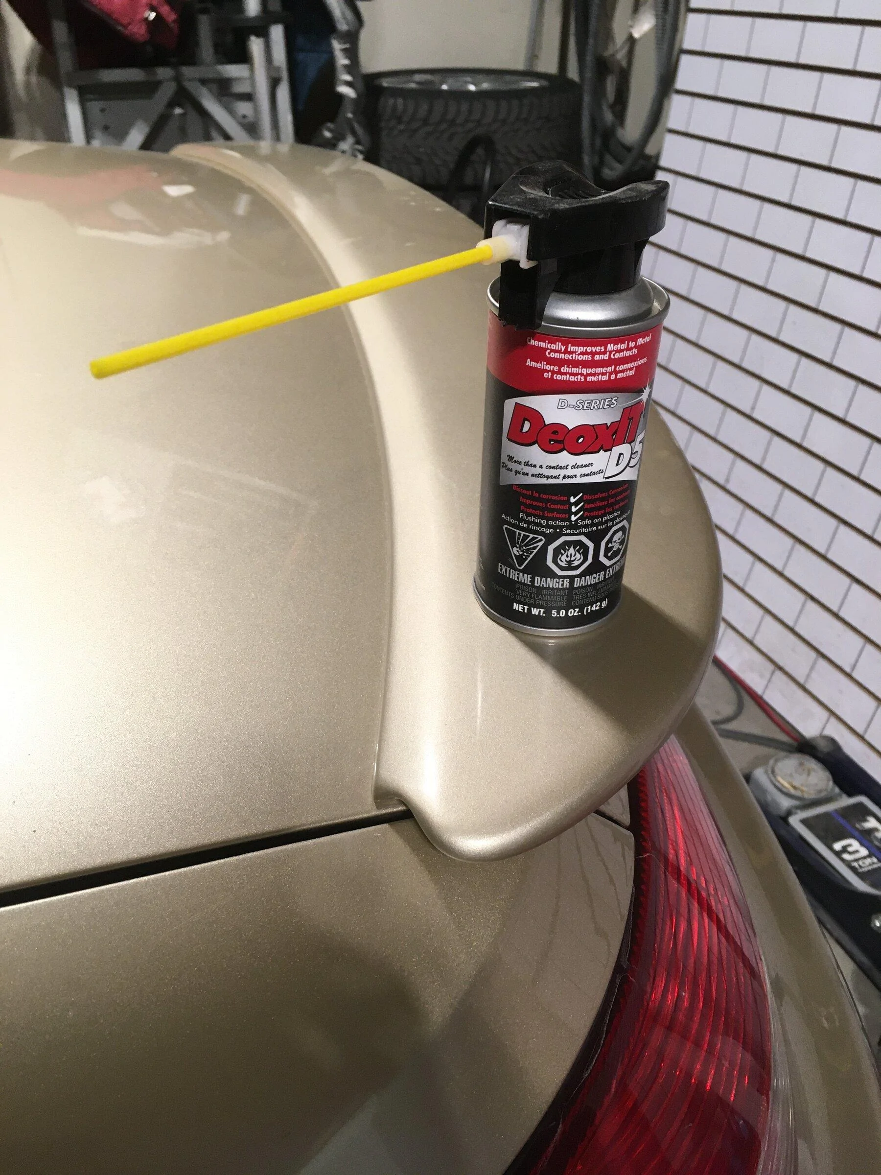

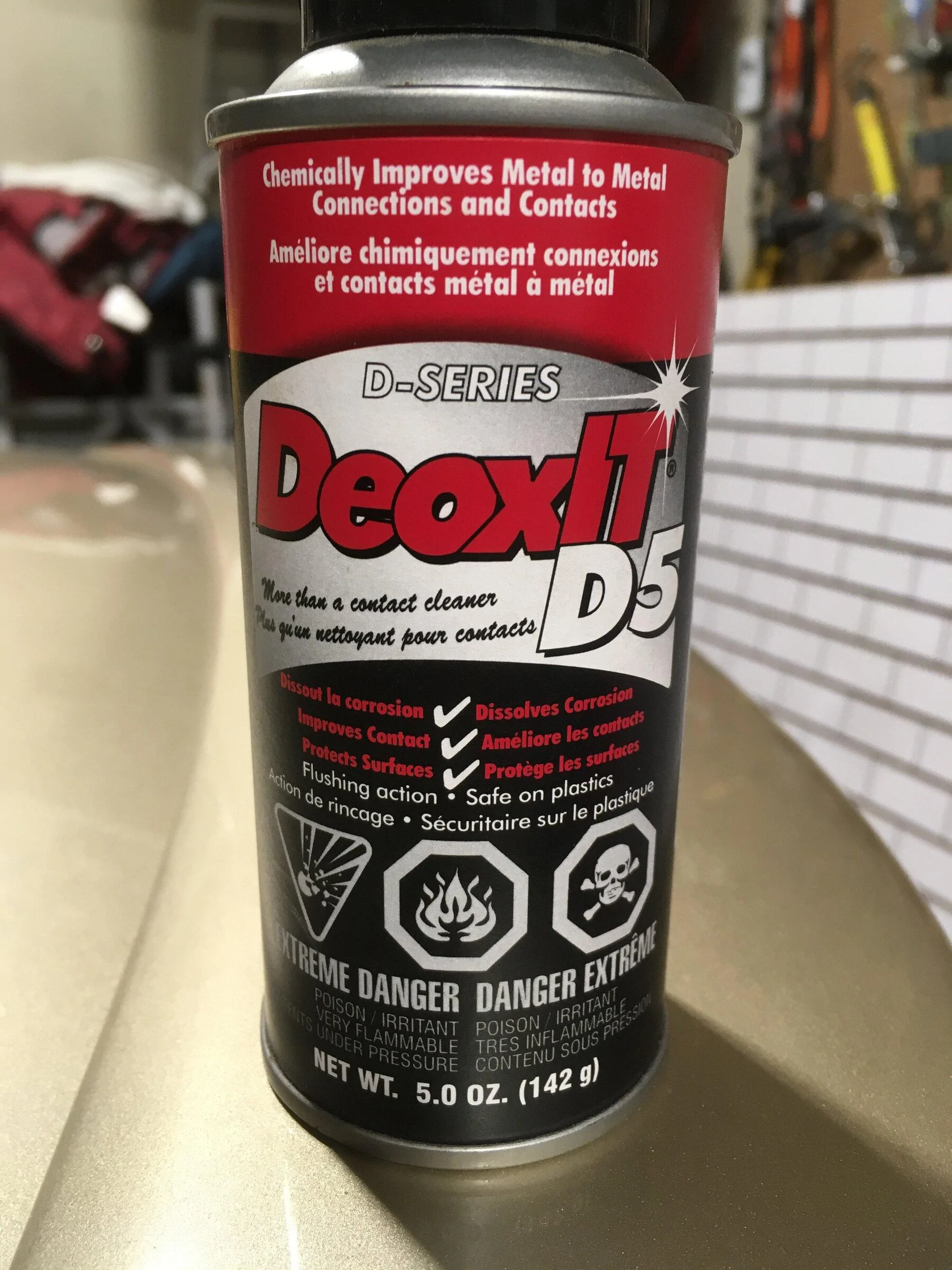

The pins both male and female ends need lube to work effortlessly. Use this and you’ll stop fighting fitment.
I see on the can that it cleans and flushes - but what about lube for the shells?
I have use a spray silicone lube on some things, keeping it off contacts. Works well for shells and plastic parts.
The problem with ordinary electric/contact cleaners is that they totally flush and wash all lube off of things, making things like plastic shells even worse because they are a drying agent, removing all lube. so I use contact cleaners carefully and try to keep them off the plastic as it removes the natural oils and any lube off the connector shells.

As far as the cleaners, I never use electrical connector cleaner on the plastic - it leeches out all lubes and dries the plastics making them dry. Connector/contact cleaner doesn't lube unless it states it lubricates. It's more akin to acetone, MEK and so on - very drying.
You want something that actually lubricates the plastic parts. Cleaner removes lube. (I work on electrical connectors in my restoration business........ learned the hard way what cleaners do to plastics)

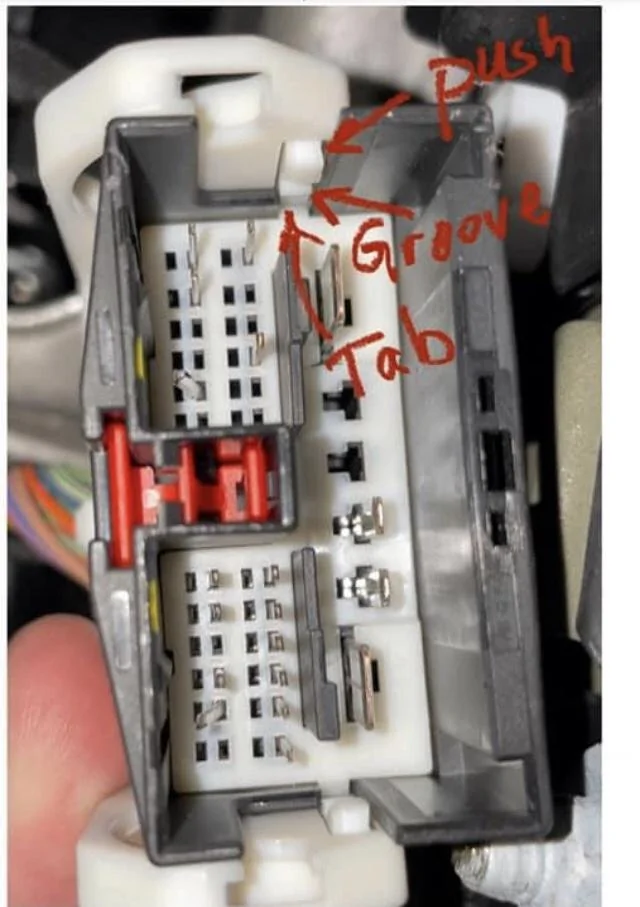

Somehow the tab keeps popping out of the notch. Not sure if it’s occurring during assembly or reassembly. Will try some silicone spray….I think these connectors are made by yazaki.
