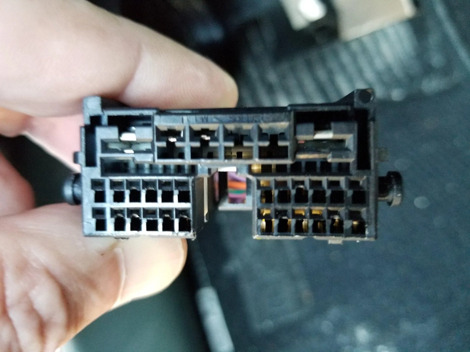

I’ve spent close to 2 hours playing with the pins. They all appear straight. This is so frustrating! ?
I had to look at the connector to see where it was damaged from the bent pins.
There is a little scallop that happens to the bottom of the pin hole guide area.
On some of them I had to slightly over correct the bend to be sure the pin got into the right hole. The way the connector gets damaged it wants to push them into the hole below where it should.
Also as the connector gets more and more damaged (from each failed attempt to fix), the pins bend less and its harder to notice the bend.
On some I opened up the correct hole as the damage can close them up a bit too.
Lower left side were some of the worse ones on mine.

Exactly what Ogre_FL said. I cleaned up the opening as best I could.
If it persists, I wonder if we can fill in the hole in with something?
With my plug it's hard to be gentle with it. Nothing wants to move easily. It's just a terrible design all around.

Thinking out loud and looking at that picture....
what if I just cut off the two pieces sticking out from each side? (trunnions?) I'm not really worried about the plug slipping out on its own.

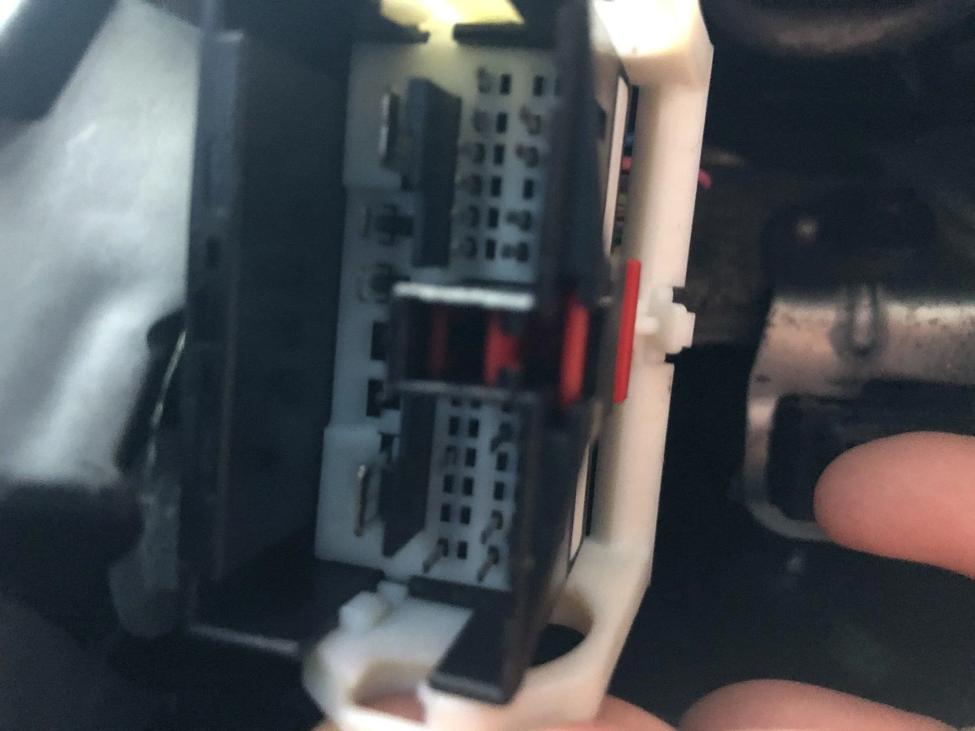

SOLVED (at least on my plugs)! The bent pins aren't the actual problem.... They are the first symptom of the problem.
The REAL problem is that the male plug doesn't function correctly.
With the plugs disconnected, you should barely see the top of the pins on the male plug. The real problem, then, is that the white piece inside the male plug should extend over the pins as you remove the female plug, offering both protection and guidance to the pins.
If you see the full pins, the inside white piece has failed to extend (hence, faulty plug) over the pins, and that's why the pins can get bent: as you reinsert the female plug, the pins aren't guided back to where they need to be by that white sliding piece.
So no, not user error. Faulty plugs.

I think you are right.
Was noted earlier in this thread. You can see the difference between the side he wasn't having issues with.
Is that part spring loaded or does it move with the closing arm?

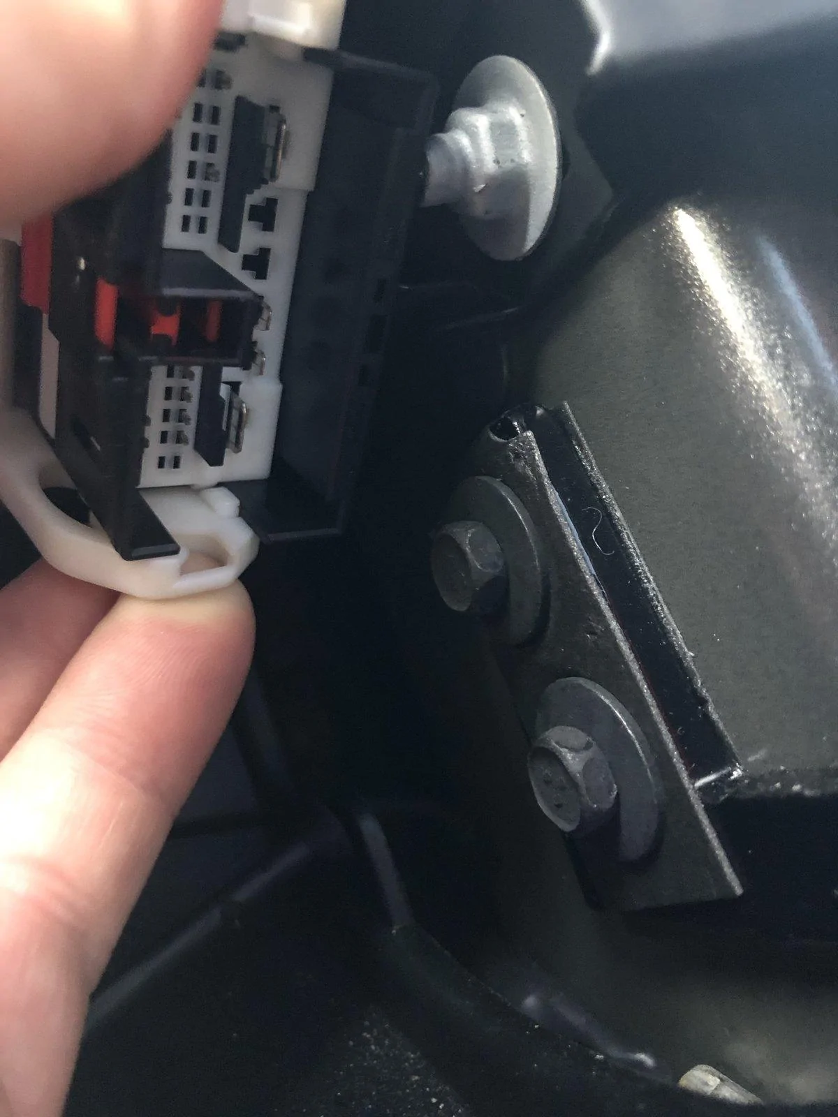

Here are pictures of the harnesses. The one with my hand is the passenger side. Can you see that there are less of the pins exposed than the other? Is other JTs the same as mine where the drivers side pins are exposed more?
FYI I did take the doors off and put them back and had the same issue. Bent them ever so slightly back and everything worked. Going to be very frustrating if I have to do this every time I remove the doors.

Ah. Didn't see that post. Looks like we are in violent agreement.
I've told my dealer and they will look at it when I take it in for a quick early oil change

Interesting. You can see the white part is aligned in two different notches on the lever.
I think we may have some sort of proof after all.
