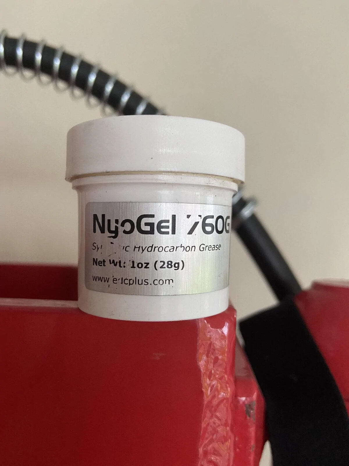

What type of lube will you use, bulb grease?
This is what I have been using after the bend pins problem so far has not happen again. By the way I am using it in any of the connectors that I have to remove for any reason.
Jeep Gladiator Driver's Door Electrical Connection greas
