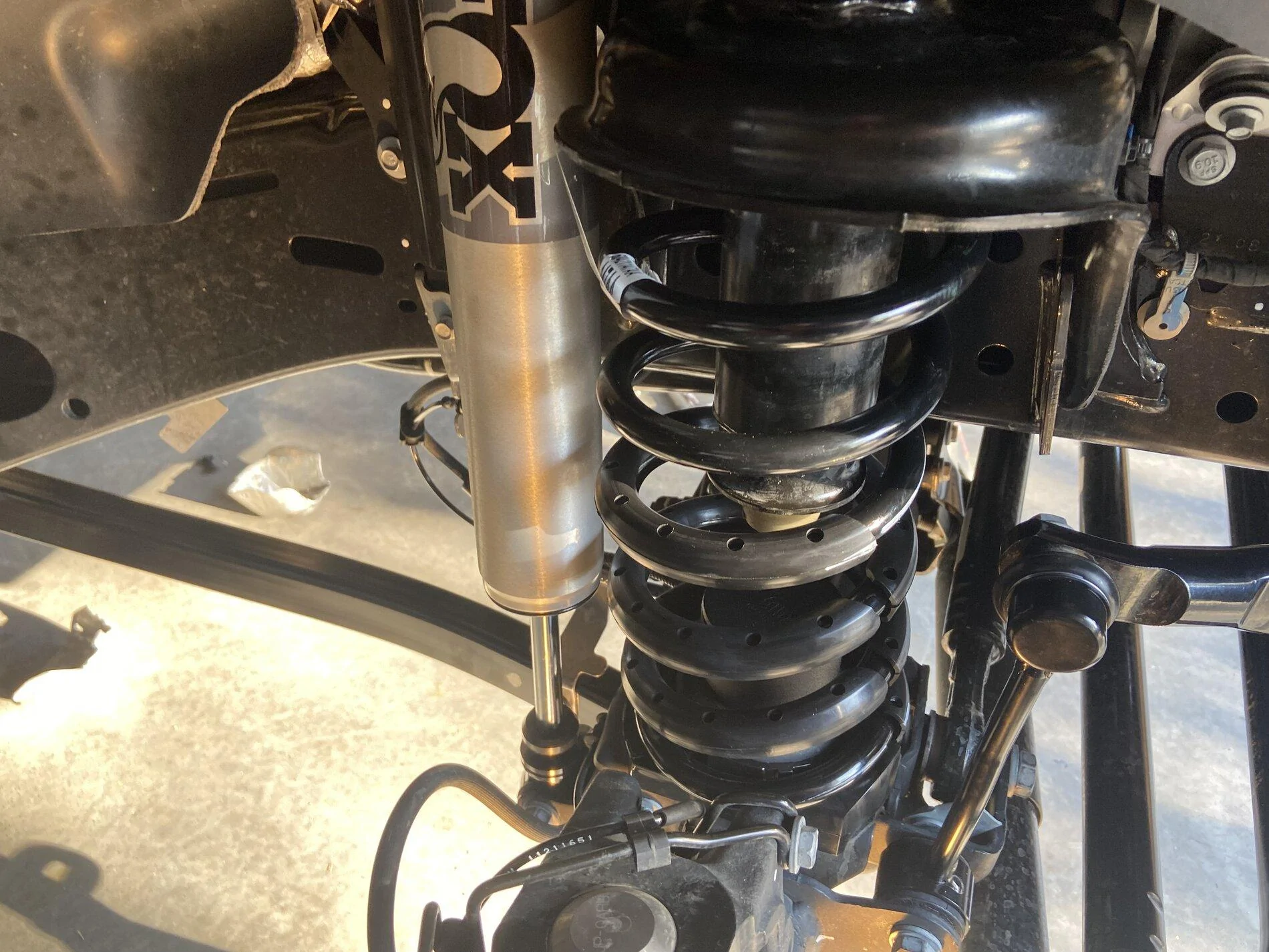

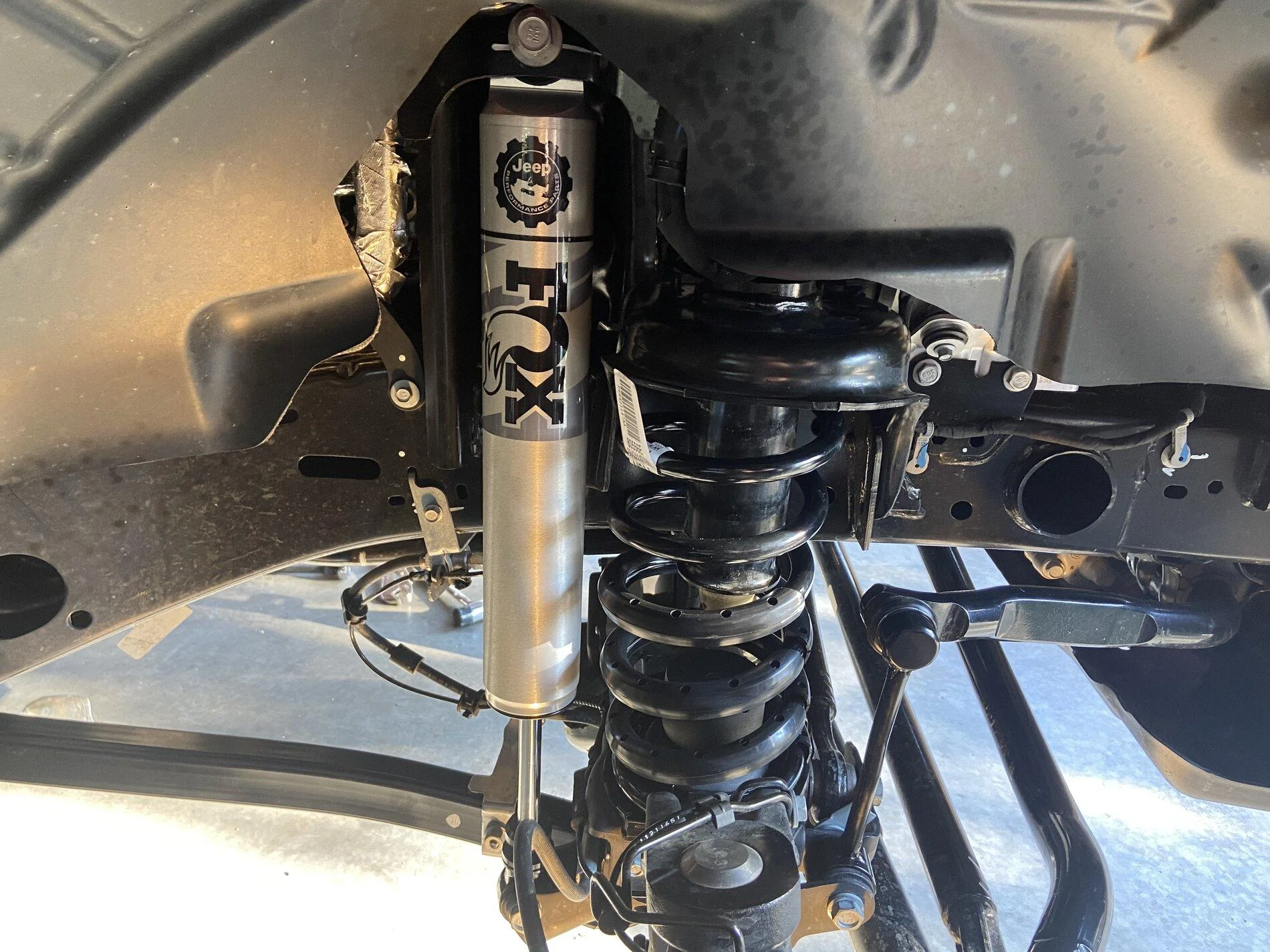

Hmmm... need some help here.
I have the springs on the correct sides, coil isolators are on the correct sides, but passanger side spring bow looks really bad.... Driver side sits in there fine.
Top isolator is in the correct position, bottom isolator as well, spring is fully clocked into the seat.
Do i have a defective spring? it looks straight when it's not in the vehicle...
Jeep Gladiator Eco diesel Suspension bottoming out on normal roads IMG_2250
I haven't torqued anything down yet.
Jeep Gladiator Eco diesel Suspension bottoming out on normal roads IMG_2249
Are both sides like that?
https://www.jeepgladiatorforum.com/forum/threads/i-am-assuming-this-is-a-bad-thing.47500/
This guy had the same problem, lunch break is over or I'd find out if they figured it out.
