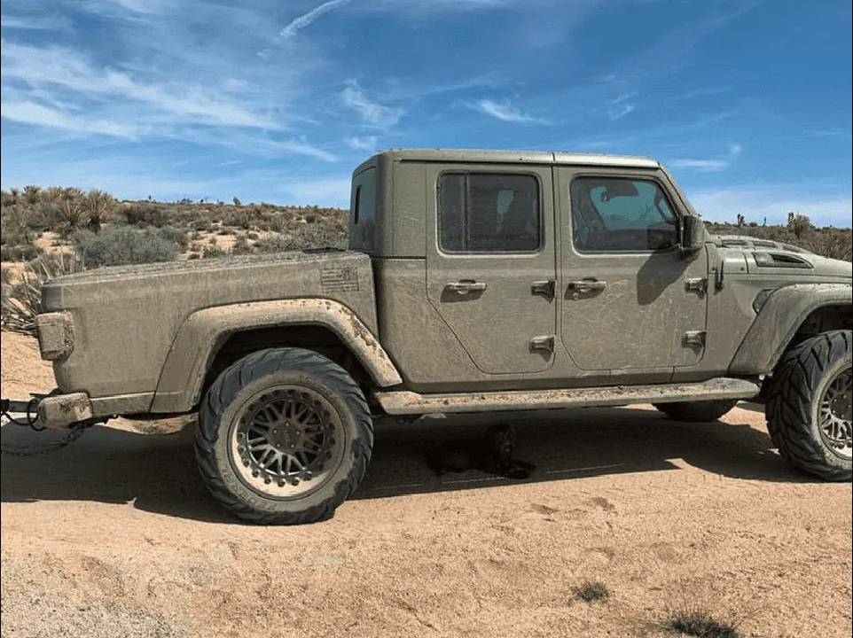

Edit: I think I recognize the problem. I’m using the term GVWR. Really what I mean is the load rating which isn’t the same thing. I think you can carry more weight in the JTRD than the ~900 pounds under the right circumstances. That’s not necessarily the same as exceeding the GVWR. Jeeps differences in load/tow and GVWR between configurations is a confusing mess.
Shadow,
Look you’ve seen a lot of stuff I post. Maybe there’s a misunderstanding about just what I’m saying. I have no reason to lie about my mileage. Carrying loads has had a negligible effect on mileage. The only change I’ve seen is going from 33 to 37 inch tires. I went from mileage in the 31 to 33 range on the highway to about 27. I can’t seem to do anything to change my combined mileage from about 23 to 24. I thought adding the awning would affect things. Nope. I thought the Front Runner rack and ROAM boxes would. Nope. When I drive up to the mountains in VA or WV or PA, I lose about 1 MPG on the interstate. This strikes me a pretty typical diesel performance. Terrain, load and towing just done have much of an effect.
I worked as an outside machinist, and then a mechanical engineer on nuclear submarines. I’m well aware of the effect of center of gravity and the moment of inertia of systems. I’ve spent a lot of time doing dynamic analysis of components and systems to determine the performance and survivability. I understand that you can’t just throw “more” at stuff to make it better without deleterious effects. You’re absolutely right that it’s more than just springs and tires. I’m not saying it isn’t.
I’m not making the claim that you can just put heavier springs on anything and it will perform better. This truck has a maximum payload of 1600 pounds in certain configurations and there are a number of factors that reduce that, e.g., the weight of the 3.0L. It’s also true that the truck is designed to tow 6500 pounds which means the cooling system and brakes are designed to handle that. That maximum obviously decreases with the weight of the vehicle and other configurations. Lifted vehicles, have a higher center of gravity. They’re more prone to roll over. There is increased wear on all the parts. Increased loading in the EGR system, etc. All that has to be taken into consideration.
That all being said, it’s been my experience that the stock suspension on my Rubicon ecodiesel is so radically under sprung, and under damped that it verges on dangerous. I’m not the only one who’s observed this. My vehicle would routinely bottom out on the road. Driving home from the dealership when I bought it I had to fight it to keep it in the lane and my vehicle does not have the steering box problem. I’ve never owned a vehicle that drove this poorly, truck or Jeep. I come from a family of auto mechanics, and my father, who’s worked on cars his entire life and has a visceral hatred of modified vehicles rode in this truck and the first thing he said to my shock was “you’ve got to replace the stock suspension on this thing”. When I put a winch on it, oddly enough that had the effect of seeming to dampen the effect of the wandering. However, the truck would bottom out constantly, and then would bounce. It was dangerous.
I’m pretty skeptical of the aftermarket. Most aftermarket stuff is shit. It seems like every lift kit manufacturer claims that their lift improves on road handling. I’m skeptical of that and stiffer isn’t necessarily better. However, in this case, the stock suspension is so bad they are probably right. Personally I’m a fan of AEV, because if you’ve ever talked to Dave Harrinton, the owner, you’ll find that he’s pretty skeptical of the aftermarket and aims for OEM quality. There’s a video of him at SEMA a few years back talking about how bad the stock tuning is. He’s absolutely spot on. They actually have invested millions in testing and advanced manufacturing. This is probably why they are one of the only small aftermarket companies in this market that manufacture OEM parts for GM and FCA.
My experience with my lift is that this completely changed the truck. I don’t mean it made it bad ass. It made it safe to drive. Yes the center of gravity is higher. Yes, the moment of inertia is different. Yes, more weight will have a quantitative affect on braking and load on the cooling system. Yes, it usually will negatively affect emergency handling. If you lift your truck, just like if you tow with your truck and just like if you carry a load in your truck, you should drive accordingly. However, in my experience, the road handling, including the emergency handling, which I have unfortunately had to rely on is vastly improved with this particular lift kit. Even with a full load, the truck handles better than unladen stock. Yes, that’s subjective but I don’t have accelerometers placed all over my vehicle to pull quantitative data. Let me put it this way. It no longer scares the shit out of me when I drive it. When I add up all the gear I’m using it exceeds the original JTRD cargo rating of approximately 900 pounds. I can tell you I would never put 900 pounds in the stock truck. I put 5, 80 pound bags of concrete in the back and it was like driving an old Cadillac with worn out shock absorbers. I don’t need to start solving dynamics problems to know that this lift has improved/increased carrying capacity of this truck in this configuration. That doesn’t mean you can put a lift kit on the configuration that carries 1600 pounds and now carry 2500. The OP taking about the diesel, I am saying there is room to improve this specific configuration’s load rating within limits. And nine months of driving it has borne that out. There is zero chance I would ever own another stock JTRD or maybe any Gladiator. I hear that the other configurations are better, I’d have to get some serious time outside of rose colored lens of a test drive.
With all more weight is there increased risk or decreased margin of safety? Absolutely, just like anybody towing a trailer that isn’t running duellies is rolling the dice that a blowout doesn’t happen, which at highway speeds is likely to lead to a jackknife and roll over. Again, a lifted truck has to be driven differently. A loaded truck has to be driven differently. A lifted and loaded truck absolutely has to be driven differently.
With regards to brakes and cooling what I’m simply saying is the trucks systems are designed for towing and carrying heavy loads. Speaking from my experience after having driven this truck in stock form for nine months on and off road and now post-lift for another nine months on and off road, the cooling system hasn’t had any issues. The braking system consistently works as well as I would expect. I haven’t quantified the delta here between laden an unladen braking performance, but I am very comfortable driving it, including emergency braking. In my experience, with other Jeeps (JK and TJ), when I load the interior with gear, and people, the braking will be sketchy. The truck is designed to tow heavy loads and it has the additional braking and cooling capacity associated with that. If you’re not towing, that additional capacity also improves performance when carrying a load. I don’t think there’s anything even remotely controversial about that.
Lastly, with regards to tires. This is one that particularly bothers me. OEMs put tires on vehicles often with only a passing regard to performance or safety. They choose tires based on cost. Consistently you can find examples from every maker on numerous models where they spec’d a tire that was garbage. You can absolutely positively improve the performance of a vehicle by changing its tires. I have owned multiple vehicles where changing a tire was a difference between something that was sketchy and good performance. Take a Bridgestone and replace it with a Michelin. Take a Firestone and replace it with a GoodYear. you can absolutely achieve better mileage, lower noise, better wet weather handling, better dry weather handling and better towing by changing tires. You can improve the way a vehicle responds to tires. Tire compounds and design directly affect hysteresis. And hysteresis has a profound effect on performance under load.
The stock Falken Wildpeak are garbage. I found the tires to be noisy, they contributed to the wandering, and they had poor wet weather performance and poor loaded performance. FCA chose them for the simple reason that they had the best contract price. They’re also load range C. While it’s not true that switching from a load range C to a load range D tire allows you magically carry more weight. It is absolutely true that if you carry more weight you may have to run a higher load range tire and possible that you will see performance improvements even if you don’t have to. Both tires being mud terrains, with all the singing that entails, my BFG KM3s, which are a load range D, were a shocking improvement on the road from the Falkens. They handle wet weather better, they not more noisy despite being more aggressive and bigger. I also notice that their pressure is more stable as they heat up. I went from 33 inch tires on stock rims to 37s on true beadlock wheels and this combination required probably 1/3 the weight to balance them. It’s shocking just now much weight was on my stock rims. I don’t think these BFGs and AEV rims are that good. I think the stock tires and perhaps the stock rims are just that terrible. So yeah you can improve performance including towing or carrying a load by changing tires. Again, I don’t think that’s very controversial either.

My mentioning the beadlocks reminds me of another trope; that beadlocks are inherently dangerous or hard to maintain. Mine have 24 bolts each. I made a pattern template for tightening them, so it takes me about 10 minutes to check the 4 mounted ones. I do this every few weeks unless I’m feeling lazy. I had these wheels about 9 months. So far, after the first month, I haven’t had any bolt back off of its torque at all. That includes checking the spare after rotating it back in, and reinflating it after months of riding under the bed. I’m still trying to understand why these things are such a supposed maintenance nightmare, ticking time bomb or balance issue in people’s minds. Maybe I just got a good set.
