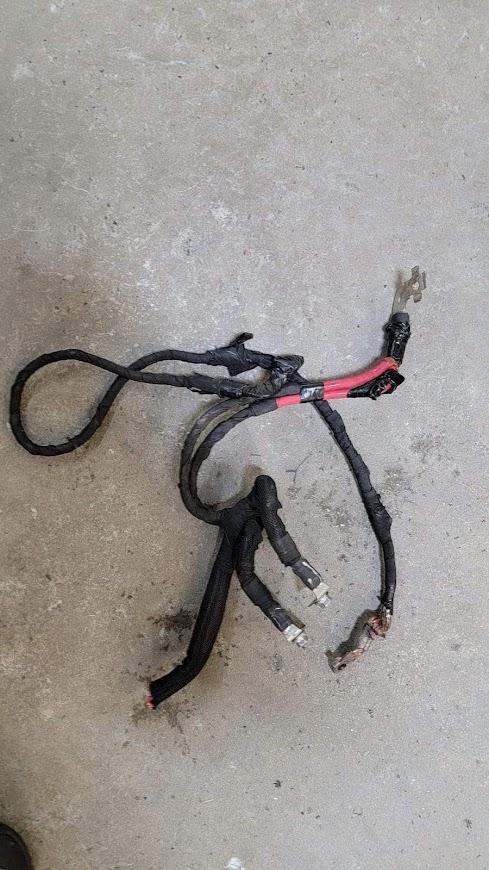

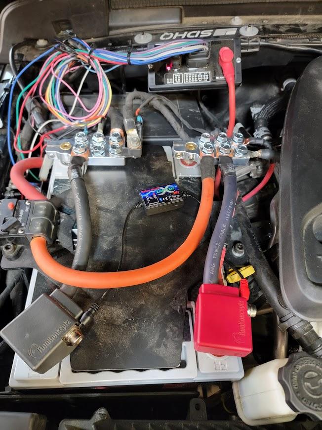

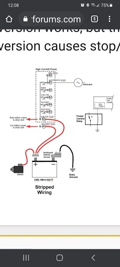

I deleted all the ESS wiring. I bought an extra harness to pull apart without having to cut up my stock harness. You can unwrap all of the harness and pull out the wires you need. I wanted to make sure everything was functioning properly before cleaning up all the wiring. This also fixed random codes that used to pop up as well. I am going to clean up the wiring now that everything has been trouble free.

Removing the ESS battery doesn't disable auto stop/start, it will still kick in 6 times per power cycle before detecting an issue and shutting off.
Also for anyone interested in eliminating the ESS battery cables, I think (but havent verified) that the factory e-torque battery cable harness might be an option. E-torque systems don't have the ESS battery.
