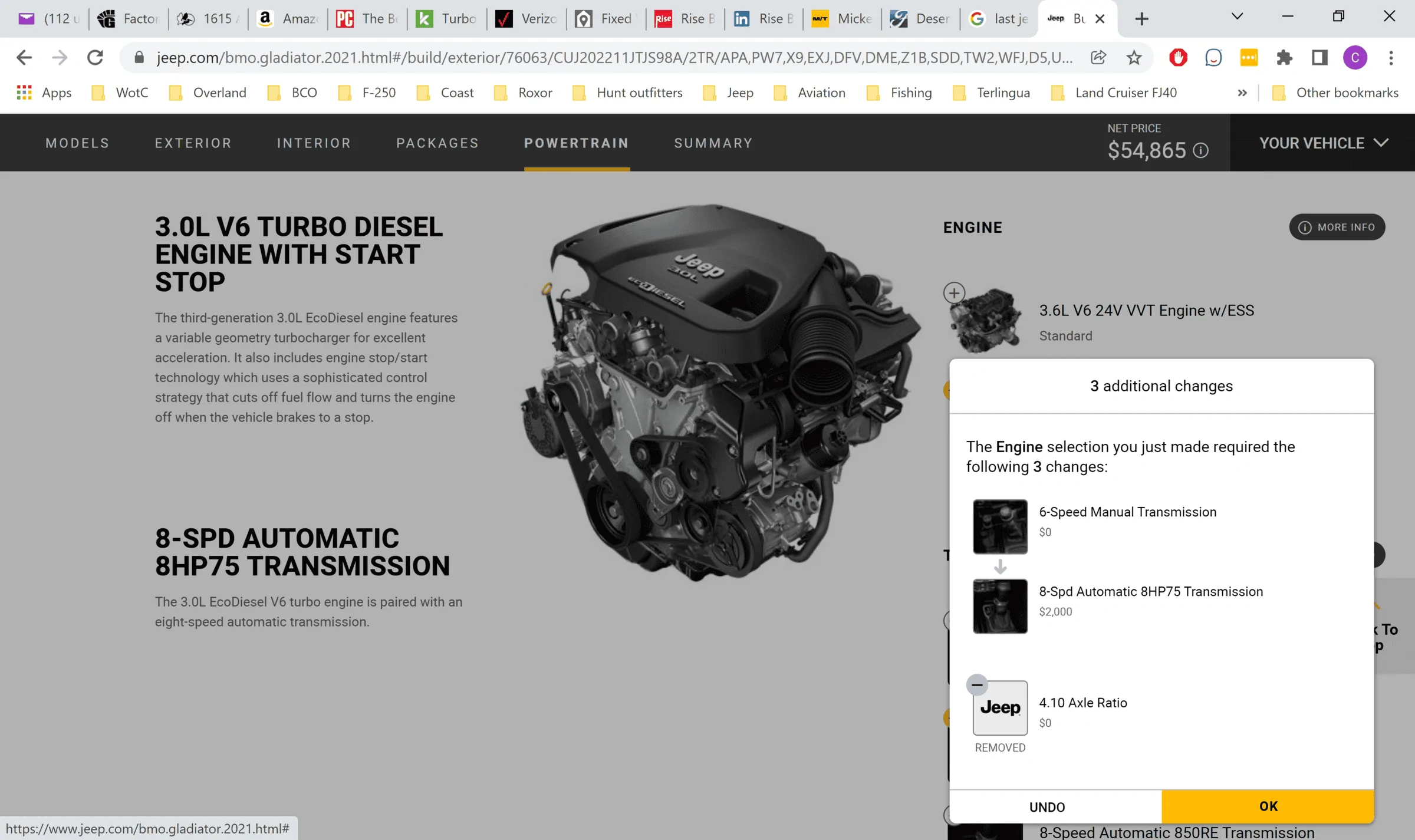

I just did a build and price on the website. I started with a Rubicon that defaults to 4.1 gears and gas engine. The only thing I changed was selecting the 3.0 Turbo Diesel which immediately and automatically changes "3 things":
- Deletes manual transmission
- Adds Auto transmission
- Deletes 4.10 axle ratio
