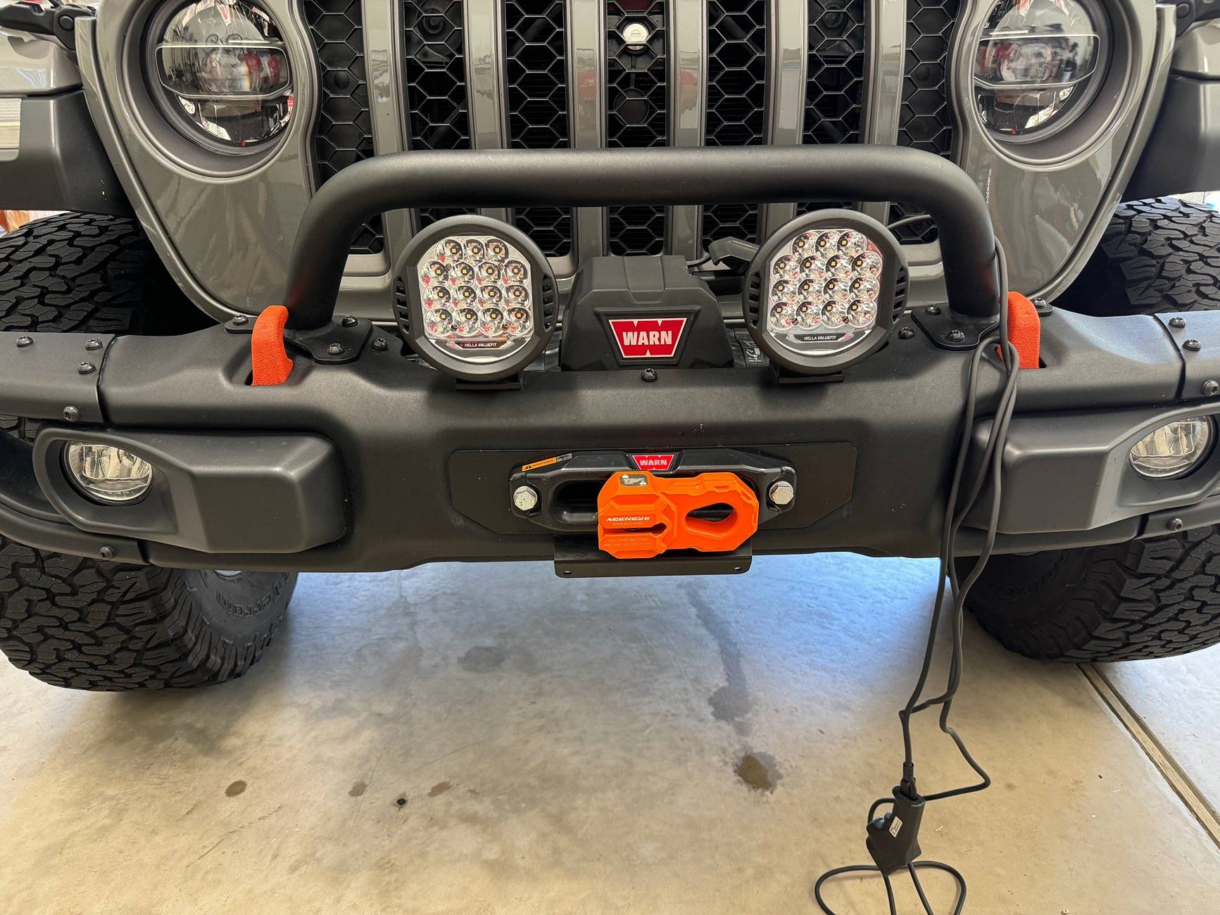

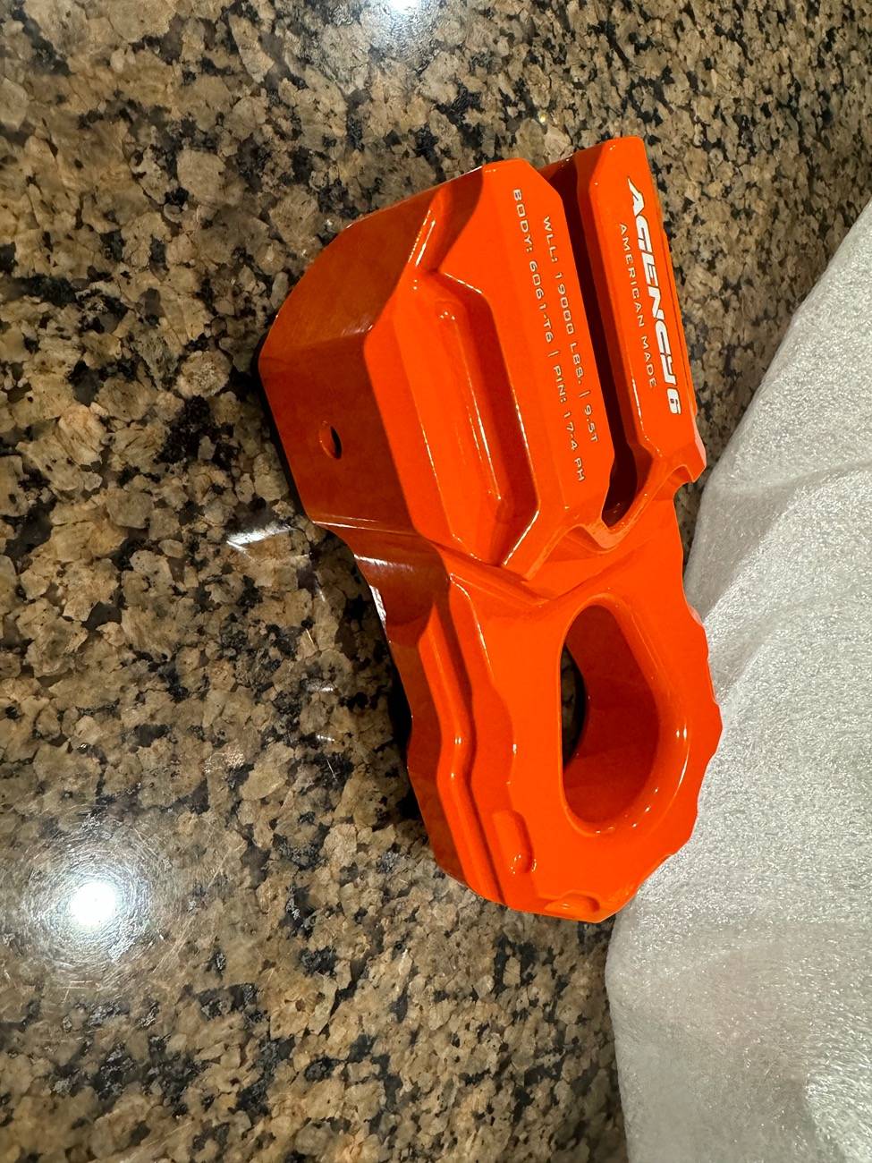

I took the Warn hook off and used the existing loop. This is Agency6. I looked at the Factor55 but for the money I think this does at least as good a job *and* shields the line really well.

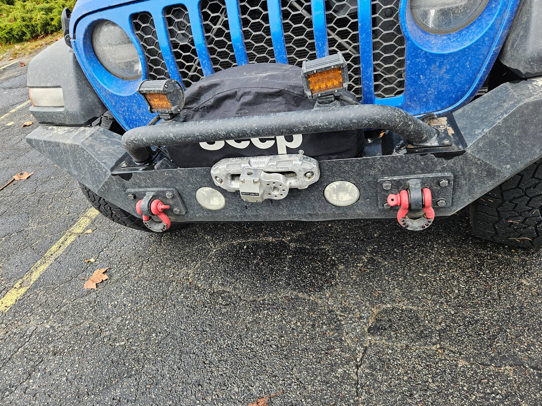

Seems like little or no metal in the winch line is better.

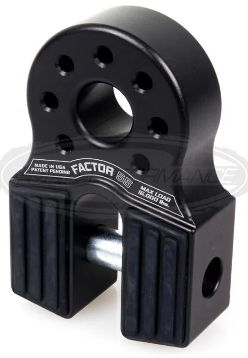

That is why I went with a Yankum fairlead on a Warn Evo VR 8S. I cut the winch line just below the factory loop (it was metal) and spliced a new loop. Lots of videos on how to do it. It took me about 30 min total. I did use a Facto55 Fast Fid which made pulling the rope back through itself a lot easier!

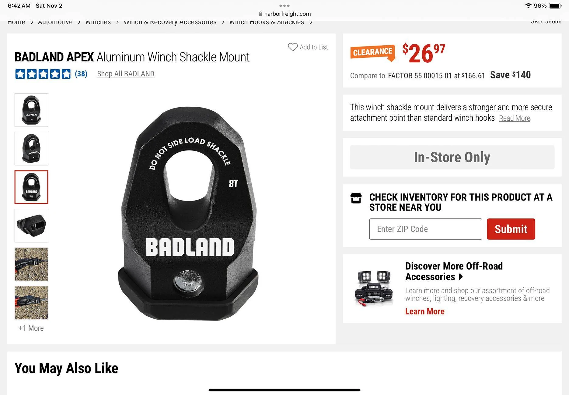

I have a Warn Sidewinder because I didn't want any of my line exposed to UV unnecessarily and it rests pretty flat up against the fairlead. I had a Badlands/Apex thimble and It always made me think my Jeep was sucking in a pacifier (no offense intended to anyone with a thimble. It's just my weird sense of humor).

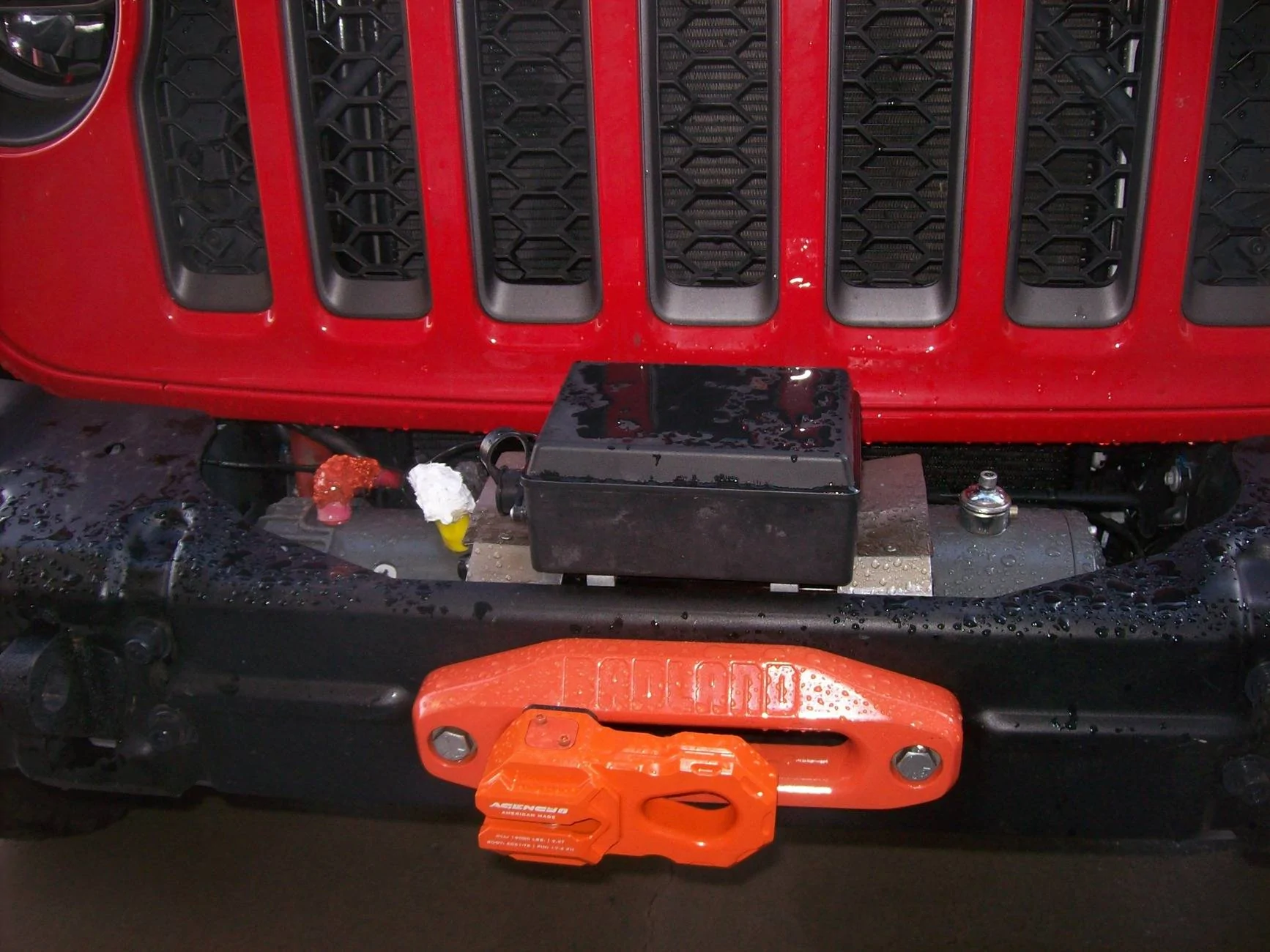

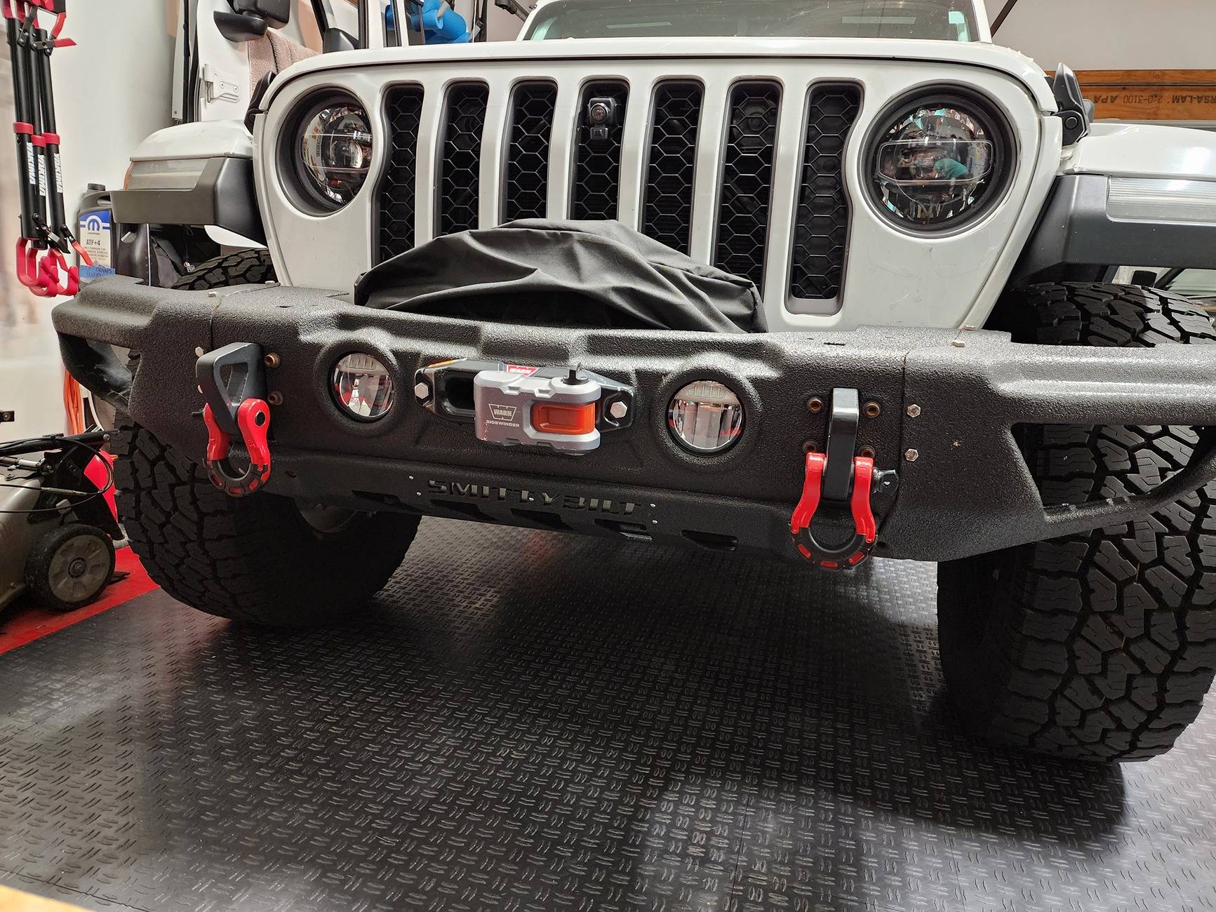

Got the factor 55 and shield. Got them only because of aftermarket double coupon thing that effectively gave them to me like 52% off. The fairlead was caught on clearance for like 30. Not sure if would have bought them at full retail but I like the setup

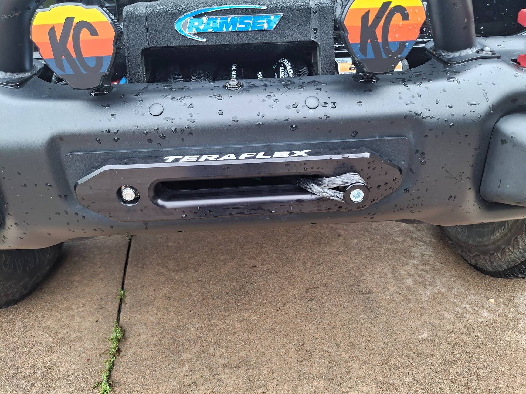

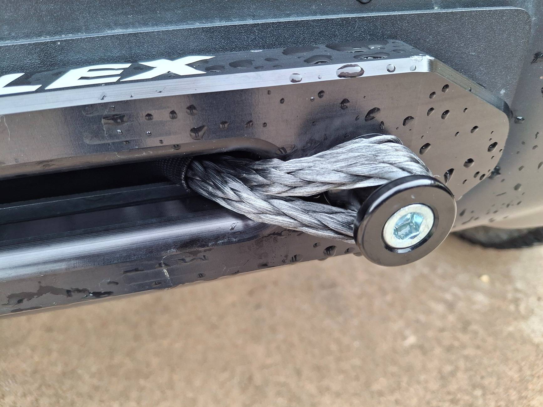

I did this on a Rhino USA rope. Cut off the end then did a locking brumell loop. If the uv's get to it just cut it off and do it again. Not a big deal.
That's what I had in mind to do! Nice! I thought about another option, having the end of the rope just go around the left or right side of the fairlead, if you were to groove out a little channel for it. Kinda like the Yankum one, but just a once sided deal, not necessary to have both sides, its just a rope holder and you've only got one!
I was concerned about the end being exposed to uv's all the time, but it can be trimmed easily or put a sleeve on it. The radius it's taken around the stud shouldn't be a problem either. The stud is about $12 on Amazon, so adding another is no big deal. Very simple and effective I think.
