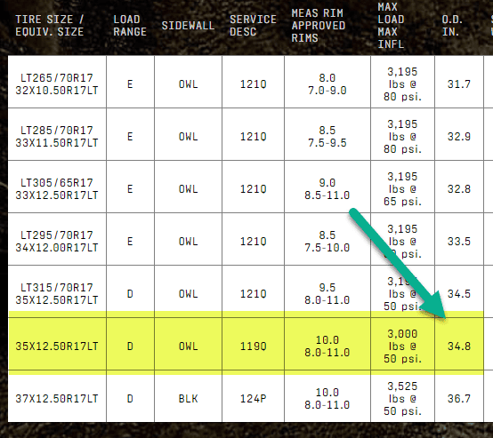

gain an inch in tire height after taking weight off; man I didn’t think it would flex that much. I feel lot better at 34.5 I still do not like the fact they at 35 inch’s on the floor aired up and all. Next buy will be true to size.

You are pissing up a rope if you think you are going to get anything for this sudden discovery that many already know about with off road tires in general.
Dick Cepek lists that size OD at 34.5" in their spec charts and as previously mentioned is unloaded and probably at the max PSI rating.
https://dickcepek.com/tires/extreme-country
Yeah ur right I just realized this lol. Next time I shop for tires I will know better

They can name it whatever they want, they can name it a 42x12.5x17. What matters is their listed spec size which is 34.8. You get 34.5, maybe they used max 50 psi for the other .3 inches.

Summit even lists the actual height at the 34.5 you measured. In the product spec and details on most tire sites you can find the actual nominal size.

I don't think any current tires that someone would install on a Jeep are true to size. If it makes you feel better a 2x4 isn't 2 by 4.
