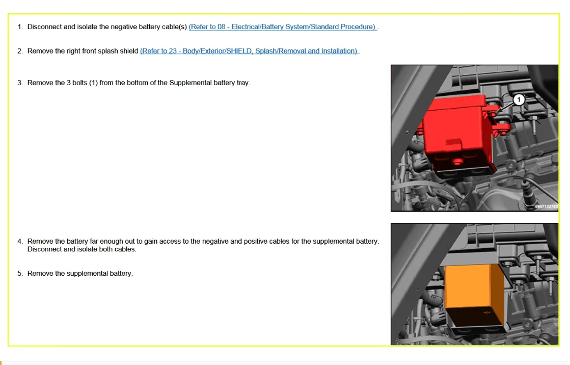

I am pretty sure I know what happened. The batteries are separated by a run relay. You start is and drive away and this relay keeps the batteries separated, when you come to a stop the relay will remain open, until you take off again. Then the relay closes and allows the alternator to charge both batteries. My guess is the bottom battery was hooked up backwards and when the relay closed it went nuclear. If he was 2 to 5 minutes from a stop and go, that would be a pretty strong correlation. I wondered about this situation when I had mine all apart. Easy to do and catastrophic.
I'm not positive, but I believe it would not be possible to hook up the small battery in reverse. I don't think the cables would reach.
However, when I replaced both batteries after experiencing all the 'classic' signs of a failure - ESS Not ready and Auxiliary switches not working, I was shocked at the procedure to accomplish the task. I can't believe that an auto manufacturer would design something so that you have to disconnect EVERY electrical connection at the power distribution block in order to access the lower battery. It seems ripe for problems or failure. I don't care if it's a Master Technician, an 18 year old auto parts store clerk or a shade tree DIY'er, I would not want anybody touching, moving or disconnecting the very heart of the electric system. I know there is little space available under the hood, but it all seemed a bit much for a "simple" battery swap.
OP - Sorry for the horrible experience. I'm not surprised the dealership is not offering you much for apologies, their lawyers don't want them to say a single word. As much as I detest EVERY dealer in which I have experience, I doubt it's worth your time or sanity to go "scorched earth" or "sue the pants off" as some suggest.

You can spin the battery 180 when you drop it back in and the cables fit pretty good. I almost did it when I was replacing my cams.

BTW, removing the PDC wasn't really a big deal as long as you have good attention to detail. I did it when running Aux wires through the firewall nipple. 0 problems.

I have a feeling thats what happened. That would put the batteries in series and send 24v to the drive accessories but still send 12v to everything else like the radio. After cycling a few times it would be melt down!
Easy to prove. Before anyone takes the truck document that.
