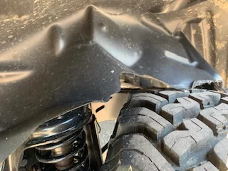

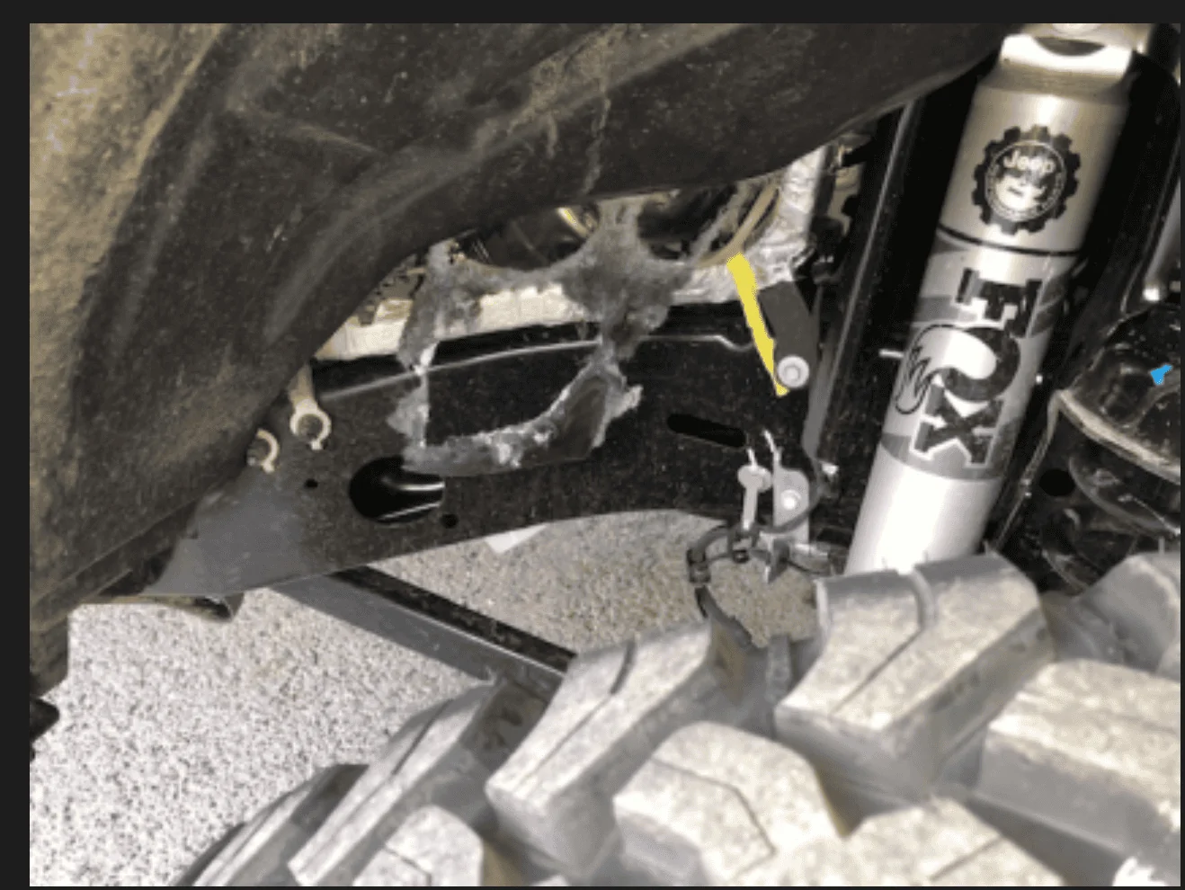

Edit to my earlier post, just completed a 2 day drive to Florida, and this exact issue just occurred on the passenger side, not the driver side at all. It actually appears to have gotten "burned" by the engine behind it versus the tire. I have MT tires, not windy at all....@JeepCares
Yes... exactly the same... Looks to be the same...
What resolution has Jeep offered you... ?
discovered... today...What about heat under the drivers right foot... ?
Holy Cow!!! The engine heat debacle has a new chapter. All kidding aside, glad you and all JT people are safe. But this makes me wonder if other plastics have weakened. Anyone look under the hood to see if anything else is goofy?

Cherokee, Trackhawk, RAM DT,
Mine melted as well, right front with A/T tires. Jeep has daily conferences that are JT specific will countless dealer techs who are hands on with the Gladiators that are on the ground. They will get the issue squared away I'm sure.
