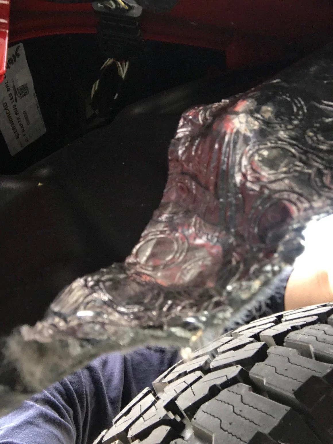

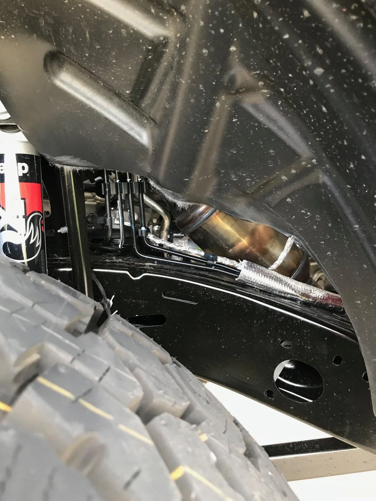

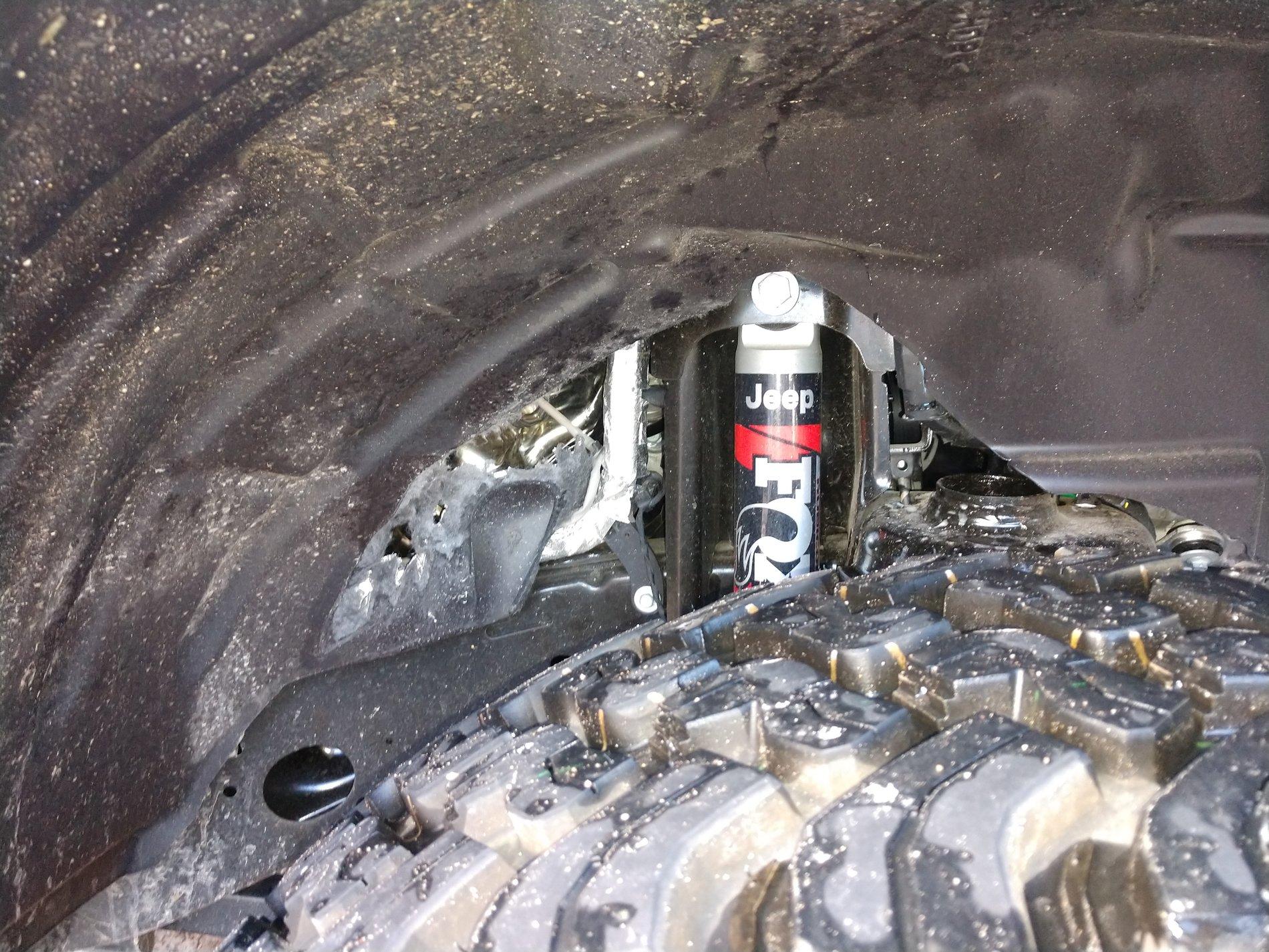

Drove my LE home 84 miles on Monday in a pretty stiff wind. Driver's side inner fender caught on tire when I got home and was torn up a bit. Sent pix to dealer. He is reporting too.
So much for my theory of it only being a M/T tire issue. This sucks
Yep. Disappointing that QA would let this go through. They had to have experienced this in their mules...... I'm sure they'll come up with a fix but in the mean time there could be a lot of stuff thrown up in the engine bay....

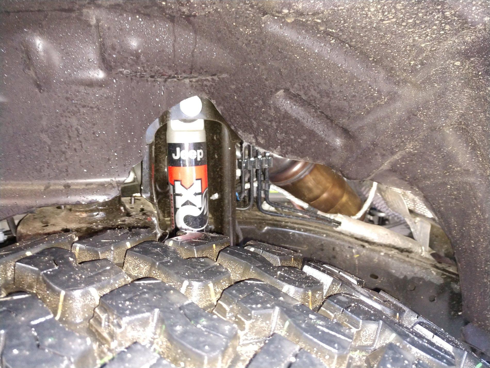

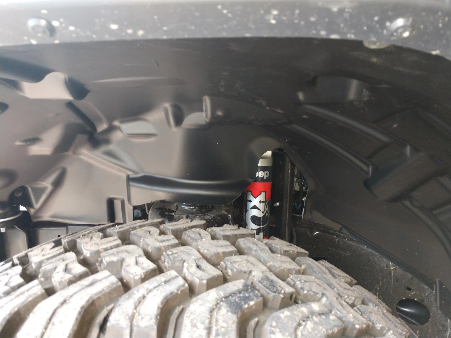

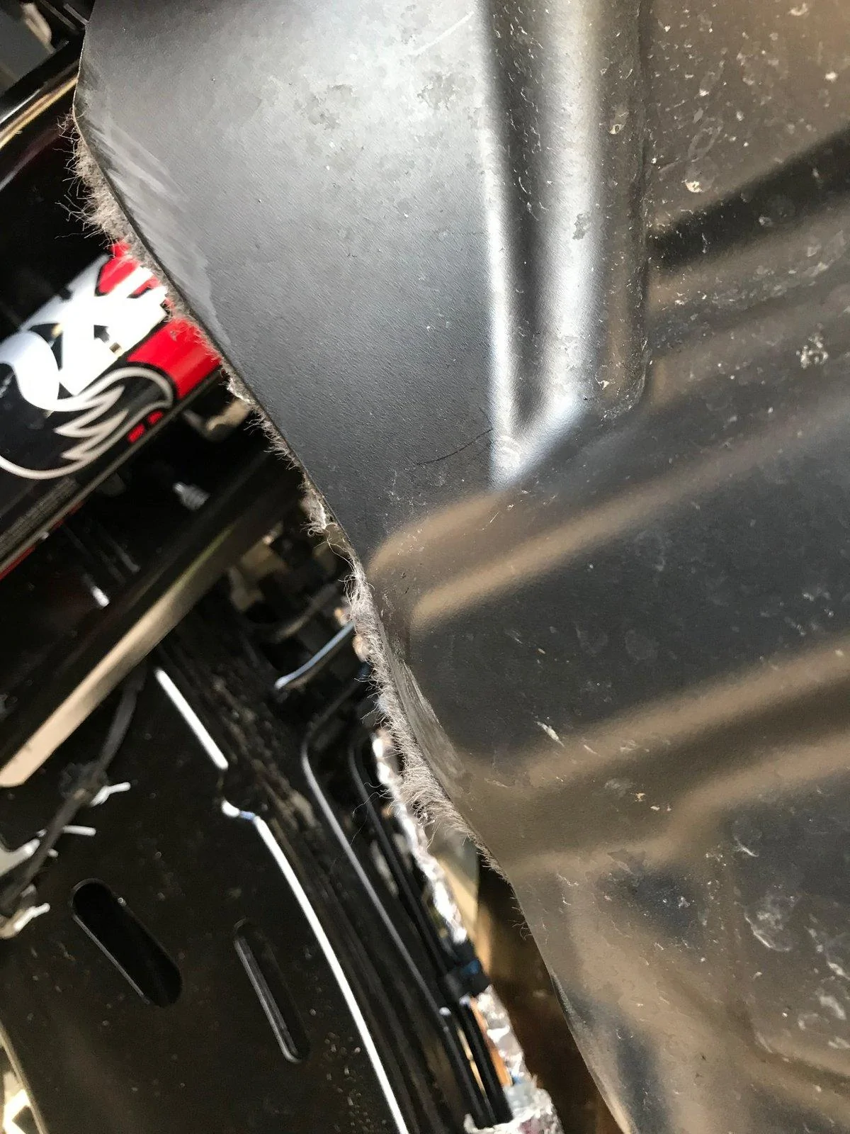

Update: Dealer replaced parts that Jeep sent them. Looks like the same exact flimsy parts. Time will tell I guess.
