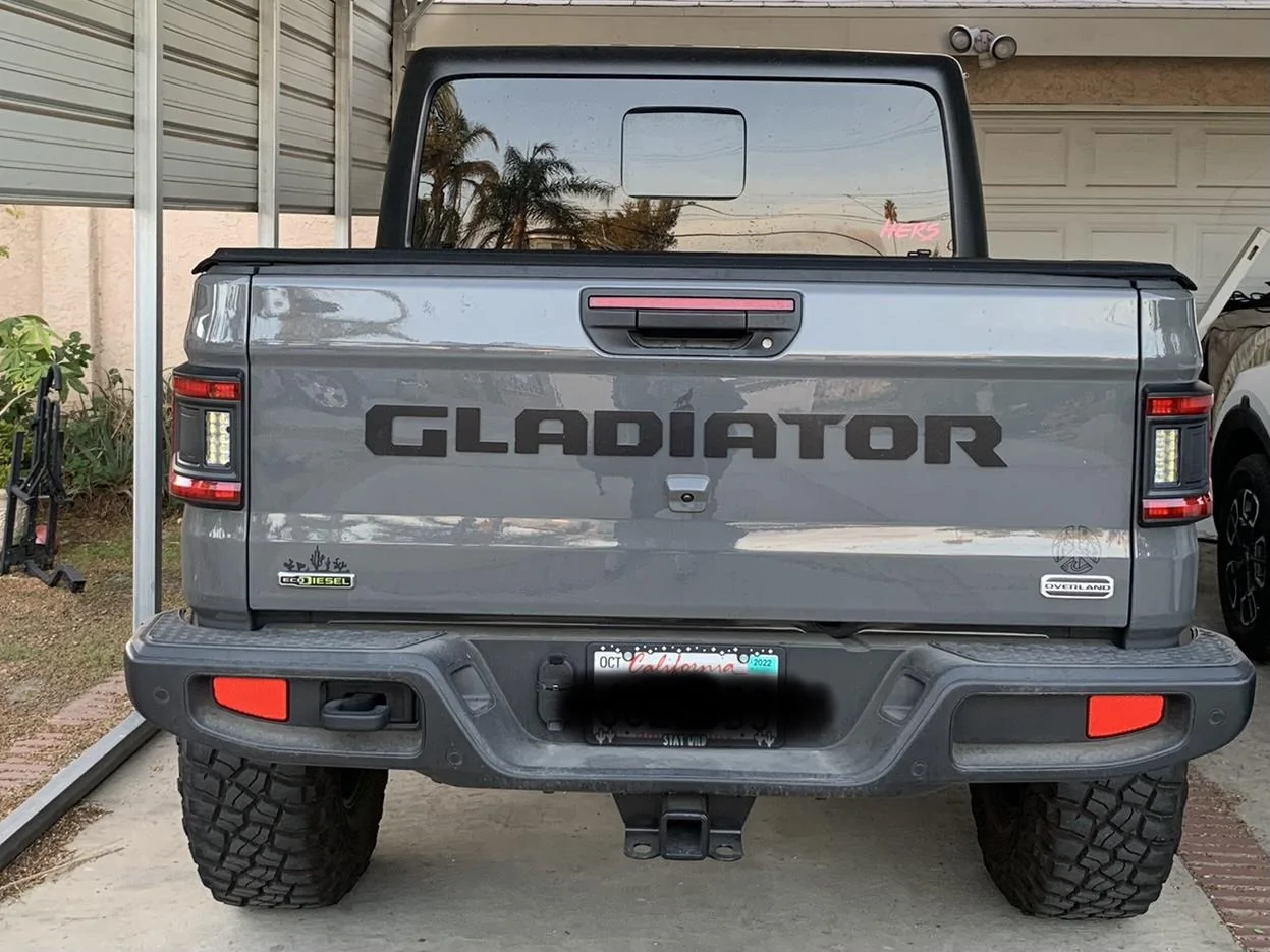

Installed mine today on a 21 diesel overland with Led and safety equipped sensors. I have a tazer but did not need to adjust for the new tail light. So far seems pretty plug and play. No flickering. ??Hoping it stays good.
I just drove 50 miles and everything functioned appropriately.

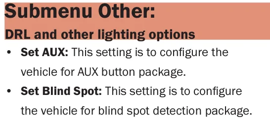

i did what you suggested and the turn signals work great but the blind spot monitor is unavailable. i am going to run wire on each tail light tomorrow afternoon to see if there is a wire misplaced. i also like the Racetrack lighting.
thank you for your time.

JP_Oracle
Bryan K. Lay
According to the Tazer manual, there is a "Set Blind Spot" setting in "Submenu Other" - Try making sure that is enabled.

yes i did check that to make sure that was set to yes as well. i am going to go into the body config today and compare to the body config of 9/ 20/2020 to see if there is any difference. i am doing this because both the front and rear cameras are not operational. this happened when i did the unmarried the Tazer and remarried to the vehicle.
Very strange but definitely sounds related. Perhaps there is a firmware update avail for the Tazer? Might be a good idea to check into that also.
