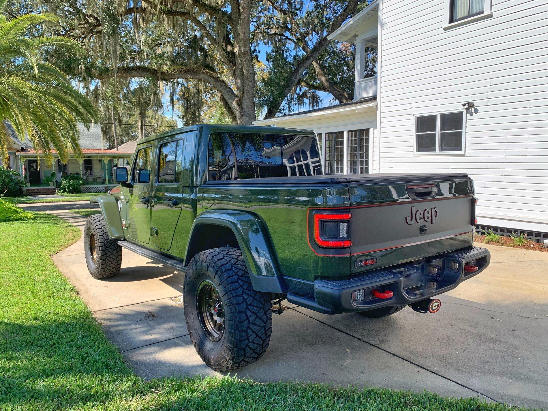

Is your truck black? Can you send me a pic of the entire thing? I want to see how you did the rear. Really digging the stripe. Some info on that would be great
No my Jeep is Sarge Green. I added the tail light and tailgate decal in black with red outline.
Jeep Gladiator Flush Mount Tail Lights 72453515-0801-41ED-A025-7451F4DCA027
