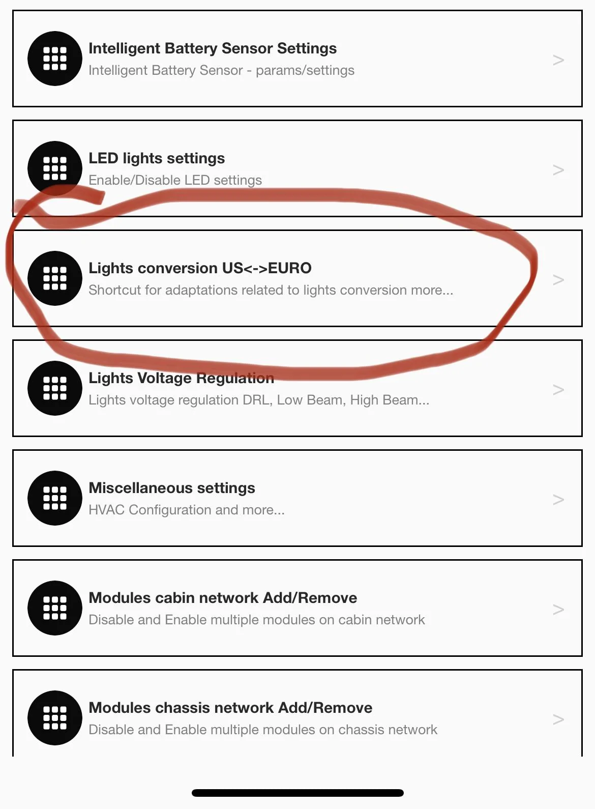

I ended up breaking down and getting JSCAN. I have a factory LED and you need to do this process to fix the hyper flash and stuff:
Load up JSCAN, go into Adaptions. Go to “Lights Conversion -> US to EURO”
Jeep Gladiator Flush Mount Tail Lights 5EBFA5F3-819C-4468-BE4E-96763A1377F0

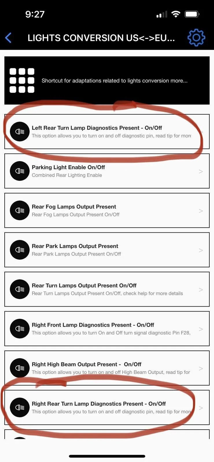

Then find the left and right rear diagnostic settings:
Jeep Gladiator Flush Mount Tail Lights 507863DA-9DDC-4F2F-89D7-9C18ECC4D55F
Start with one side, set the value to deactivate then Hit Go. Once you get the confirmation, turn on that blinker until the hyper flash stops.
Then repeat for the other side.
I did not change any other settings than these ones. I left all the tail lamp led things active. They don’t need to be changed for Factory LED trucks.
I have not had any issue since.
