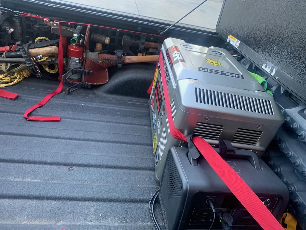

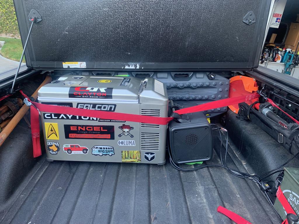

I put my Engel in the bed with a lifepo4 bluetti battery. The Engel fits under my hard folding tonneau cover. I need my fridge removable, since we use the bed once in a while. It has been like that almost a year now, and tons of trails with no problem. The 115V plug in the bed charges the battery (200watts) and runs the fridge (35 watts) when the truck is running. When the truck shuts off, the Engel pulls DC from the Bluetti.

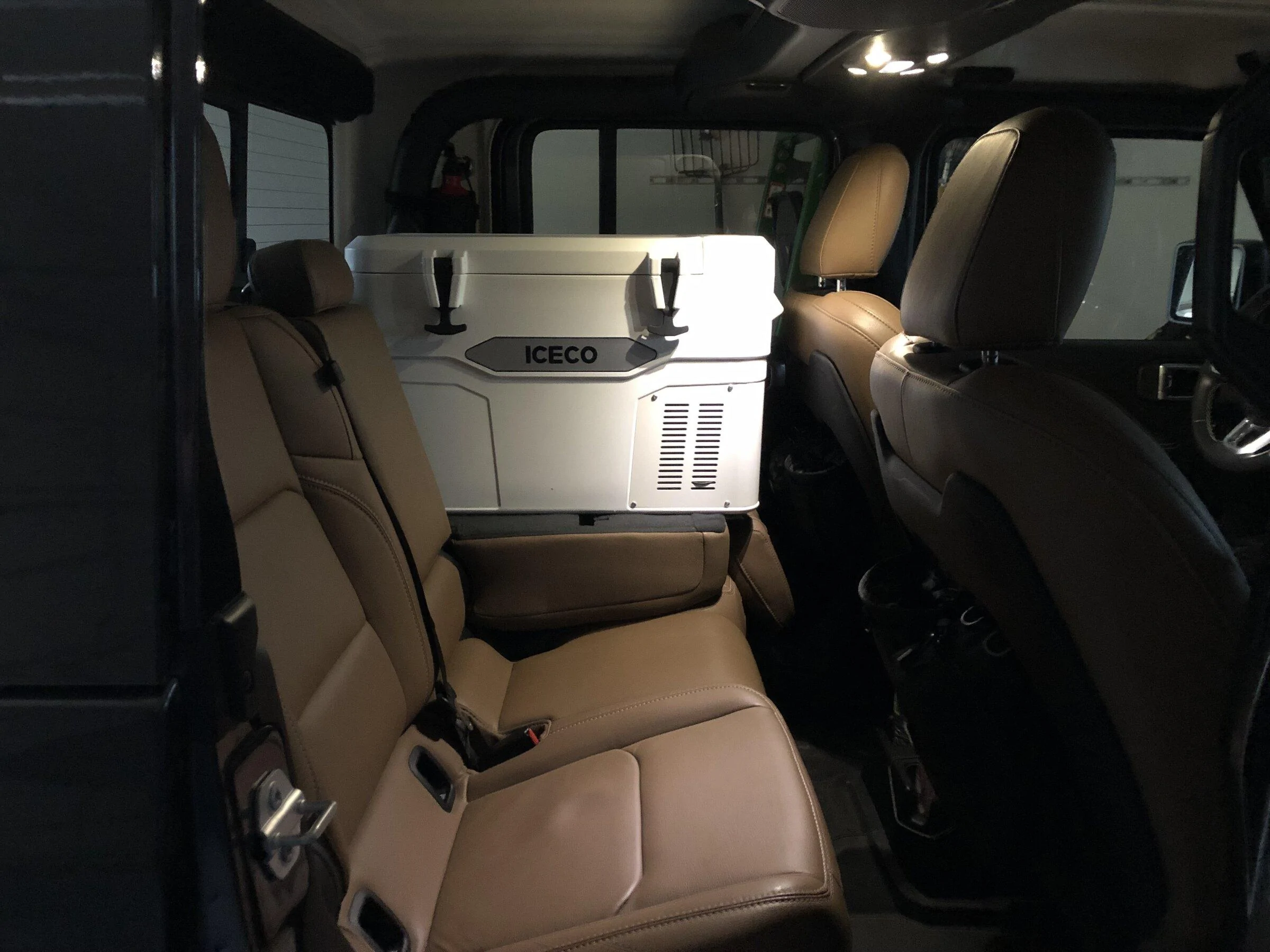

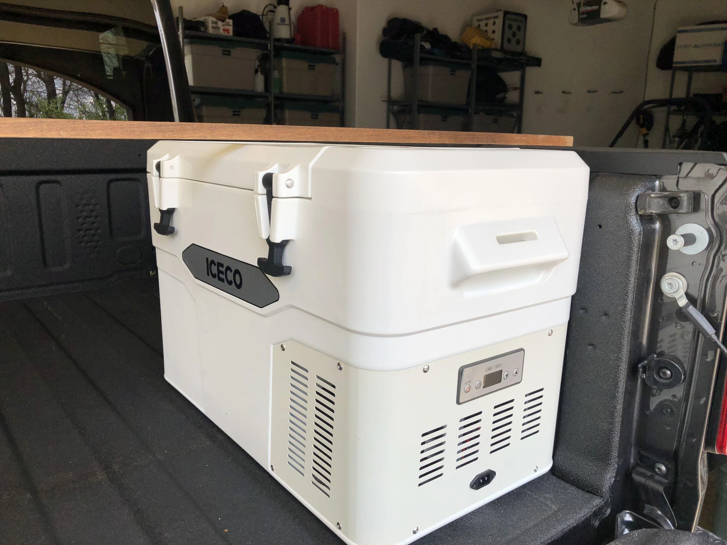

Thanks for starting this thread. I couldn't decide where to mount my Iceco JP42, so I decided for two ways. I measured both spots, before buying a fridge that would fit.
When I have my hardtop on, I like it on top of the back seat. There's just enough room to open the top, and I can plug it in the cigarette lighter. I'm planning to upgrade to an Antigravity LiPO starter battery which should keep the fridge running for a few days without starting the truck. The battery also has protection from running dry. Most people opt for a dual battery system or an axillary battery like a Jackery to power the fridge. I'll give this a try since it's simple and lighter than original battery. I also installed a bypass to keep my cigarette lighter socket powered, when the truck is off.
Jeep Gladiator Fridge in the bed or the cab ? IMG_6471
Jeep Gladiator Fridge in the bed or the cab ? IMG_6472
When I eventually finish my camper (check out my build), the fridge will go in the bed back corner. Looks like it will be a perfect fit, under the bench I'll make.

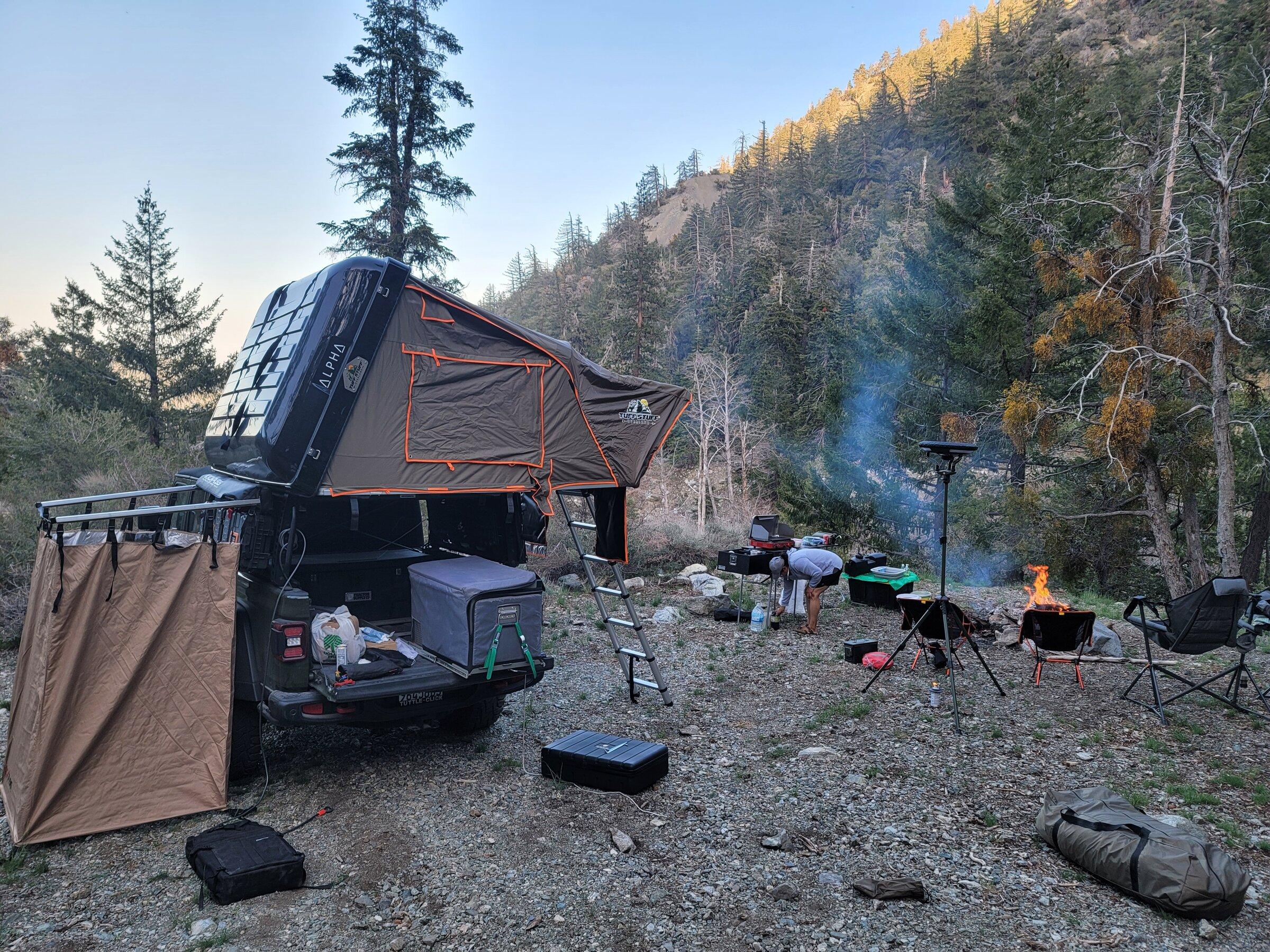

I have mine in the bed. Keep in mind when it's exposed to direct sun in hot summer's day, it may have problems keep up, even with iceco fridge cover. I've now added an rtt and that made a world of difference.

I have the Bluetti EB70s with the stable LiFePO4 battery chemistry,2500+ life cycles. The Refrigerator does all the switching automatically. You need an octopus for the 115v AC connector in the bed. You need to run two AC cords from that AC outlet. One for the Bluetti and one for the Refrig. . Then, you need to run a DC cord from the Bluetti to the Refrig. . The Fridge priority should be AC first.... If no AC is avalialable, then, the Fridge should draw DC from the Bluetti. When the truck is running, it is charging the Bluetti and also running the Fridge. DC is only used when the Truck is off and there is no AC running.

If you try to charge the bluetti and discharge it at the same time, it is not as efficient. It will get hotter, etc.... The way I described the setup, the Bluetti is never charging and discharging at the same time. When the truck is running, the Bluetti should never be discharging, only charging. When the truck is off, then, then that should be the only time the Bluetti is discharging using DC to run the Fridge. For this to work properly, the fridge should have a priority of AC power, then, switch to DC power when AC power is not available. Make sure your fridge has that capability.
