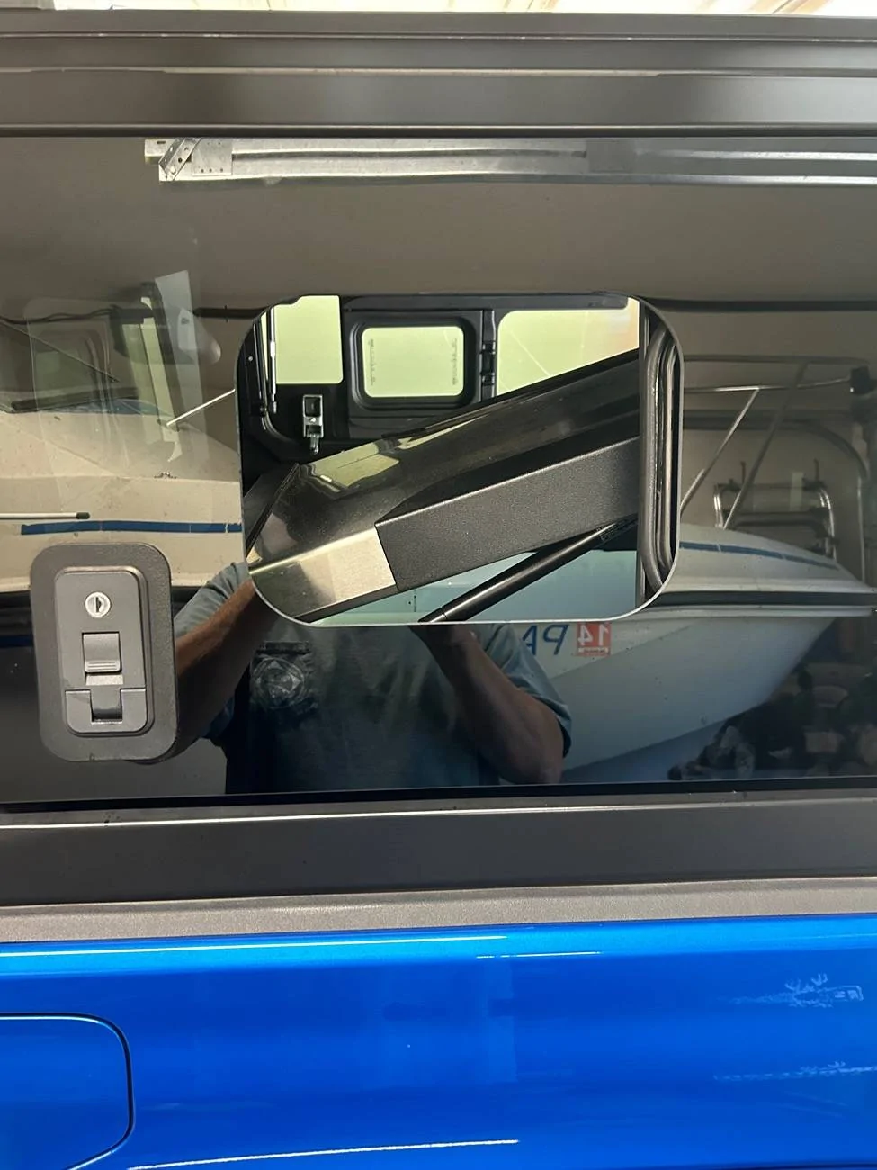

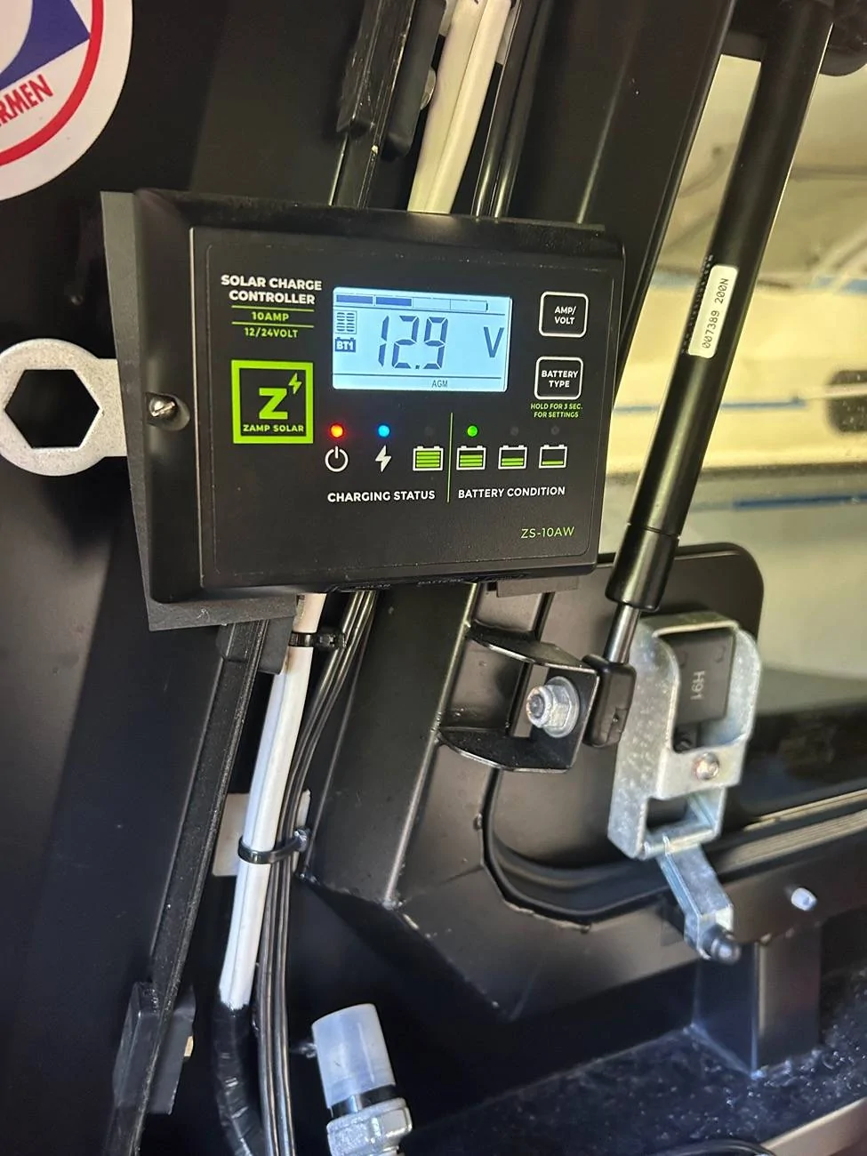

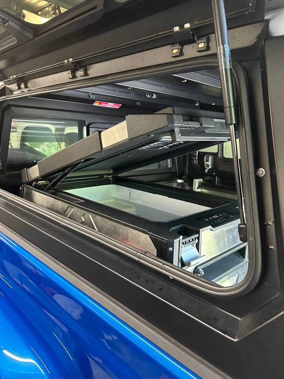

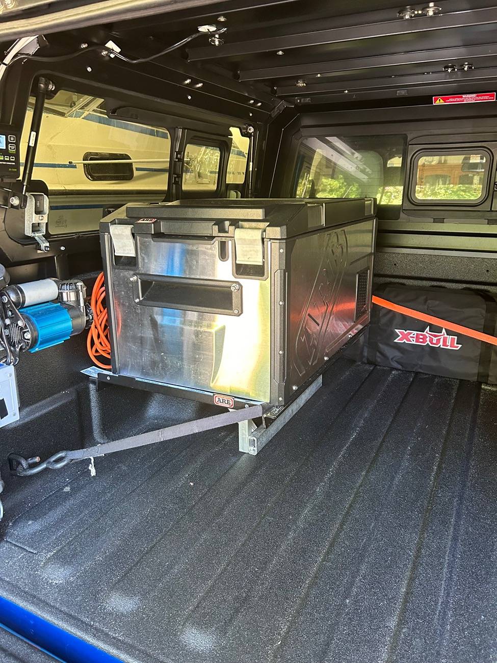

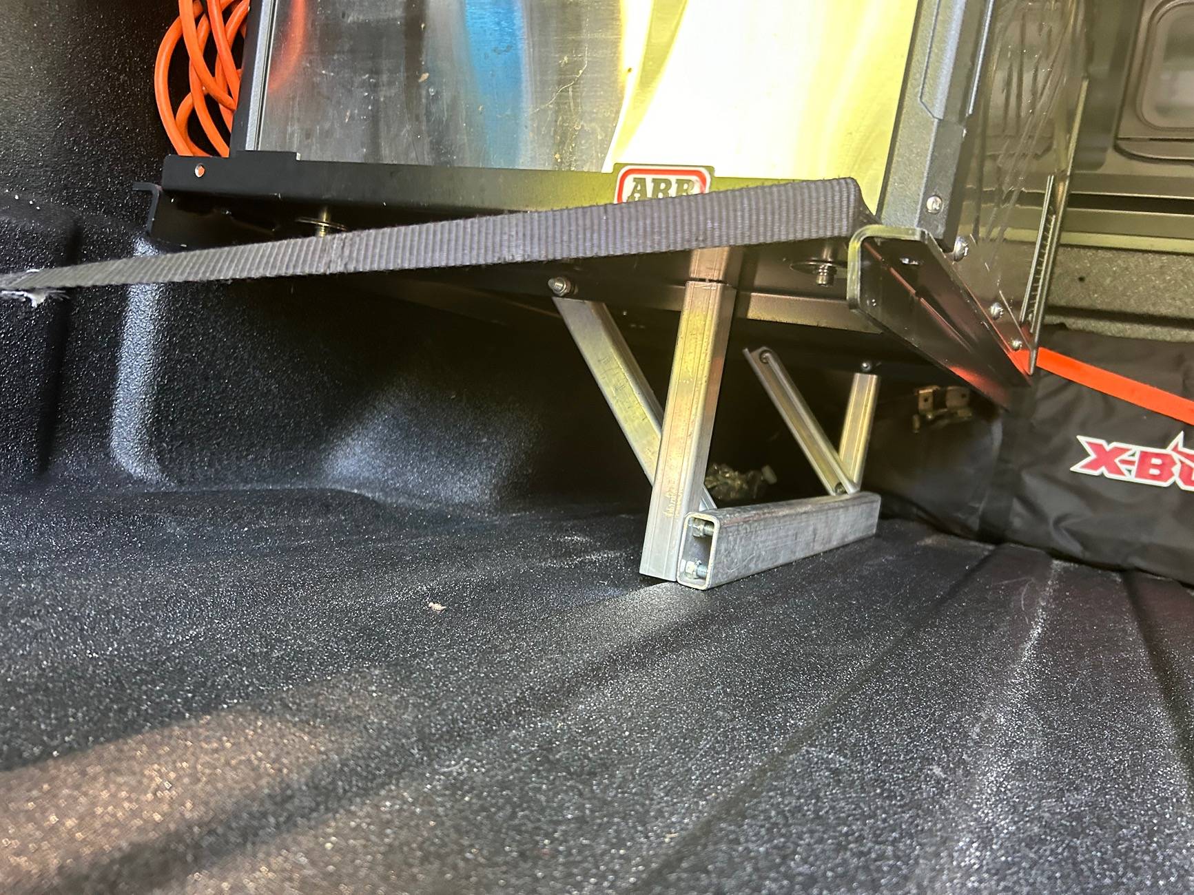

And for a whole new spin on options !
How about in the bed raised up so can store under it and very easily accessed through side door in RSI or any caps! It’s a ARB 63 elements with parts of an ARB slide, I got the fridge and slide used from a member here for real good price including slide, wanted a smaller fridge but now realize I can fill it up quick, so very happy. Ratchet strap holds it down but planning on putting two or three Nutserts in bed and bolt it down. Have Zamp 100 watt solar panel on top with Genesis dual battery under hood works great for me. Side slider window opening is right above exhaust vent of fridge leave it open when it is hot out. Very happy with setup!….Jack
Jeep Gladiator Fridge in the bed or the cab ? IMG_1724
Jeep Gladiator Fridge in the bed or the cab ? IMG_1723
Jeep Gladiator Fridge in the bed or the cab ? IMG_1720
Jeep Gladiator Fridge in the bed or the cab ? IMG_1719
Jeep Gladiator Fridge in the bed or the cab ? IMG_1718

I like that idea also.
Might have to mock that up and see if my fridge will open in my Smart cap.

Mine does not open all the way and I took out the basket cause that would not come out. So height of wheel well and how close you can be to top of cap as RSI slopes down, Aluma cab doesn't me thinks. I also got the top of the refrigerator box with lid open even with bottom of window edge. I had the slide which cost me about $50, and put a 1"x1" angle mounted to side of bed as low to fender well as I could get.....Jack
Gary mine is an ARB Elements 63 fridge you could check specs and compare to yours also it yours opens that would be a game changer big time.

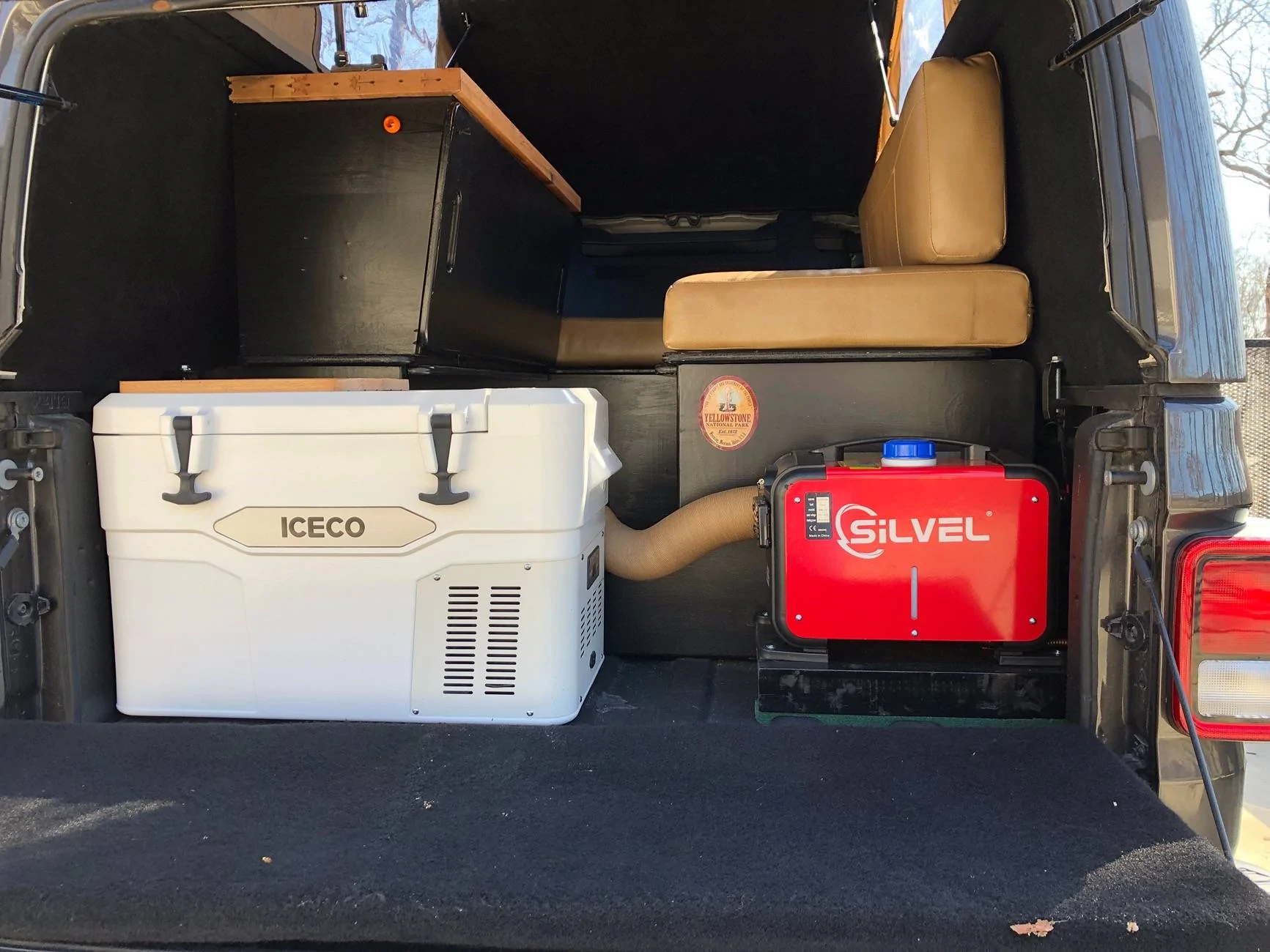

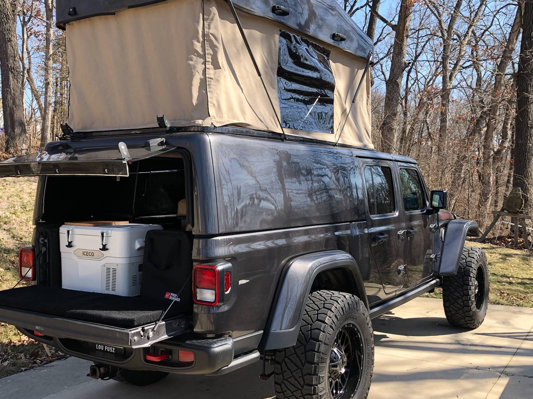

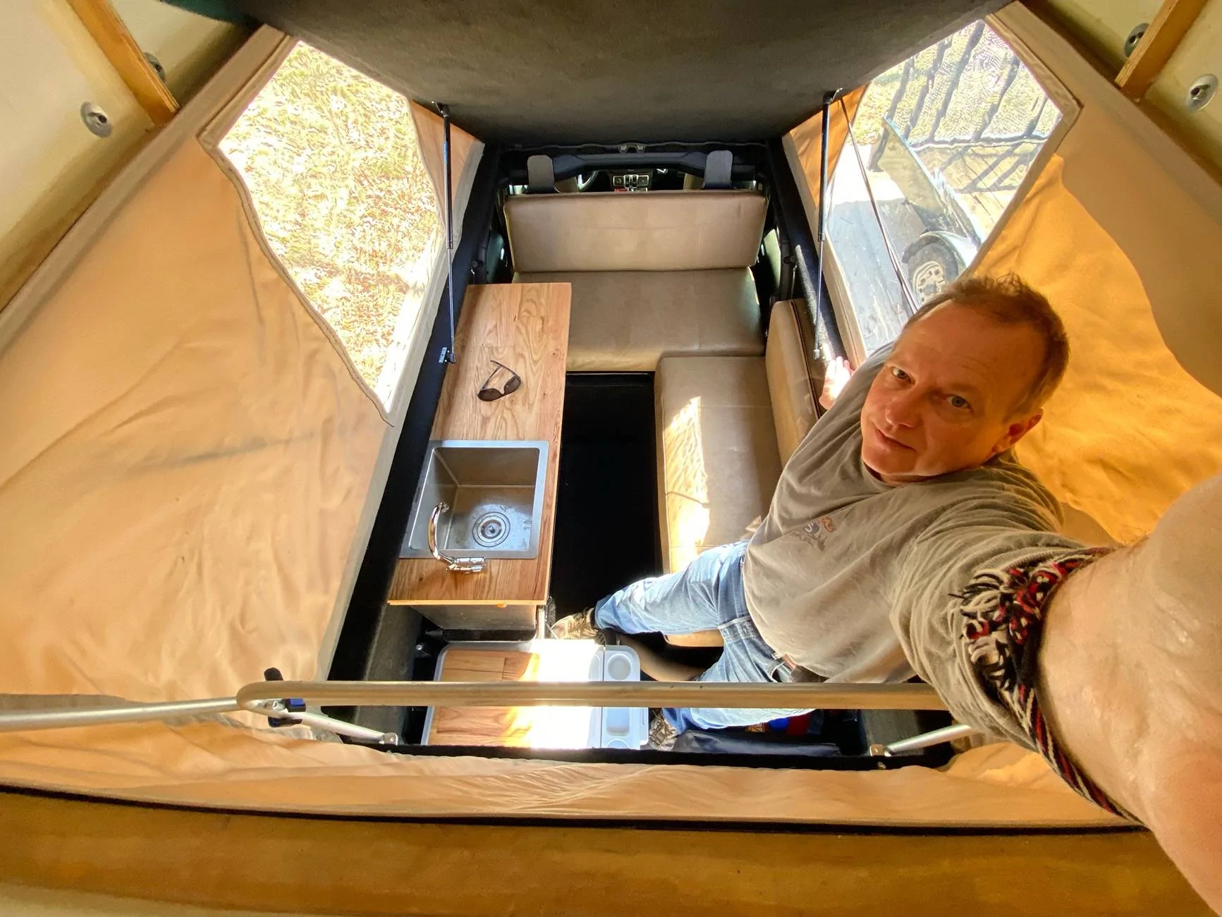

I move the fridge around, but I tend to like it by the tailgate. I can get to it from outside or inside the camper.
Jeep Gladiator Fridge in the bed or the cab ? IMG_9657
Jeep Gladiator Fridge in the bed or the cab ? IMG_5048 3
