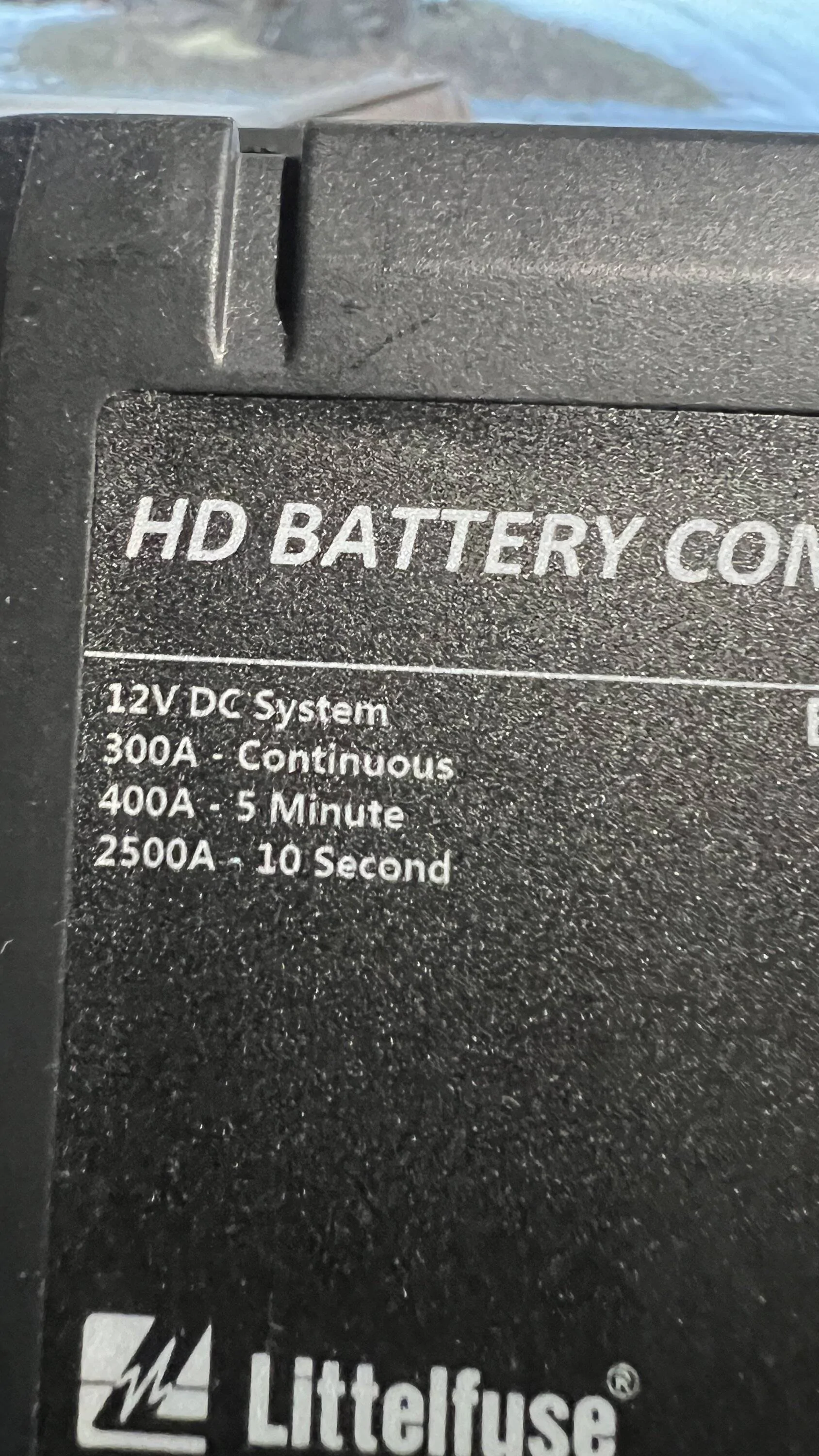

For anyone curious of the spec of the battery combiner, here ya go. I was curious about this myself. For those doing extensive and consistent winch pulls it might provide another option. im sure this part can be sourced independently somewhere
Jeep Gladiator Genesis batteries - lets do some math C5966E4D-D341-4A8C-8737-A6FAD2FB4471

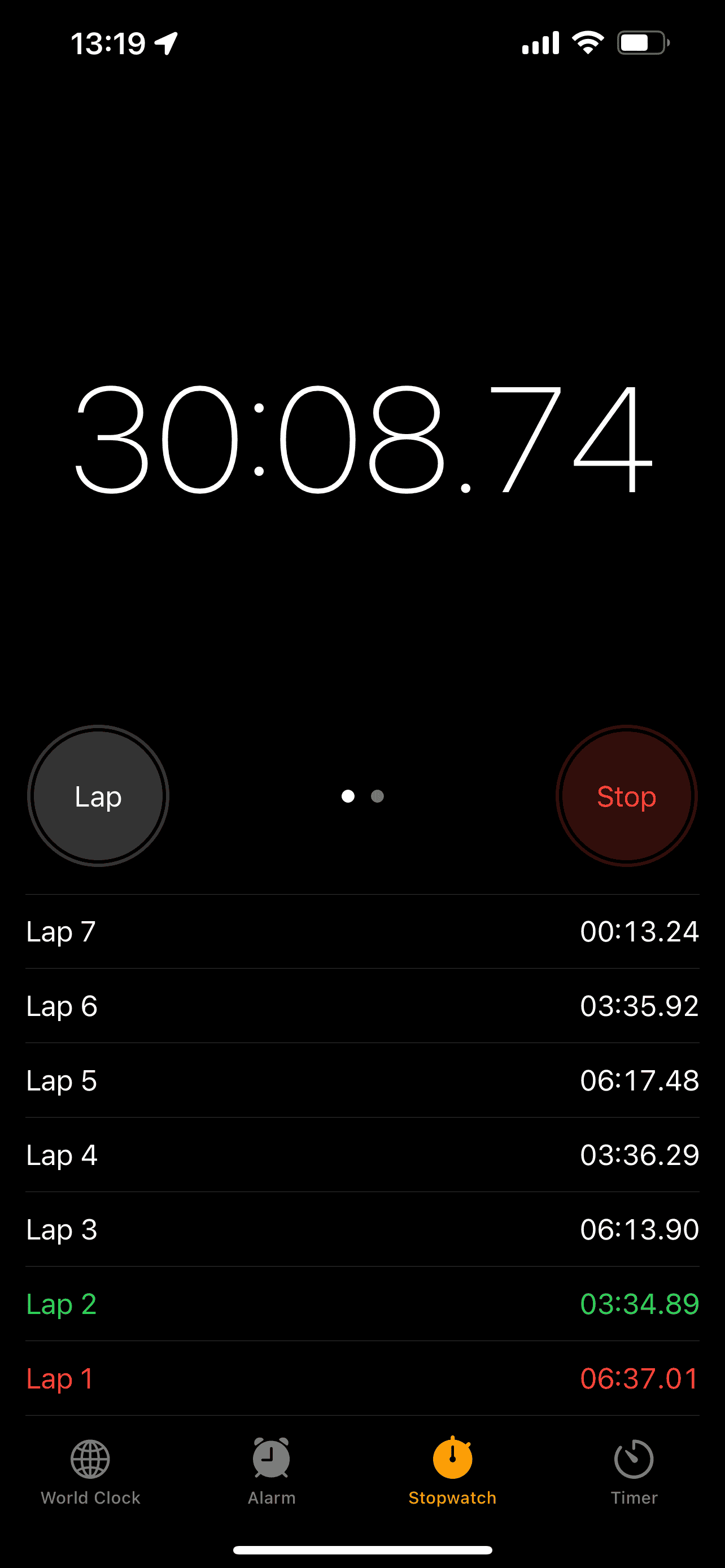

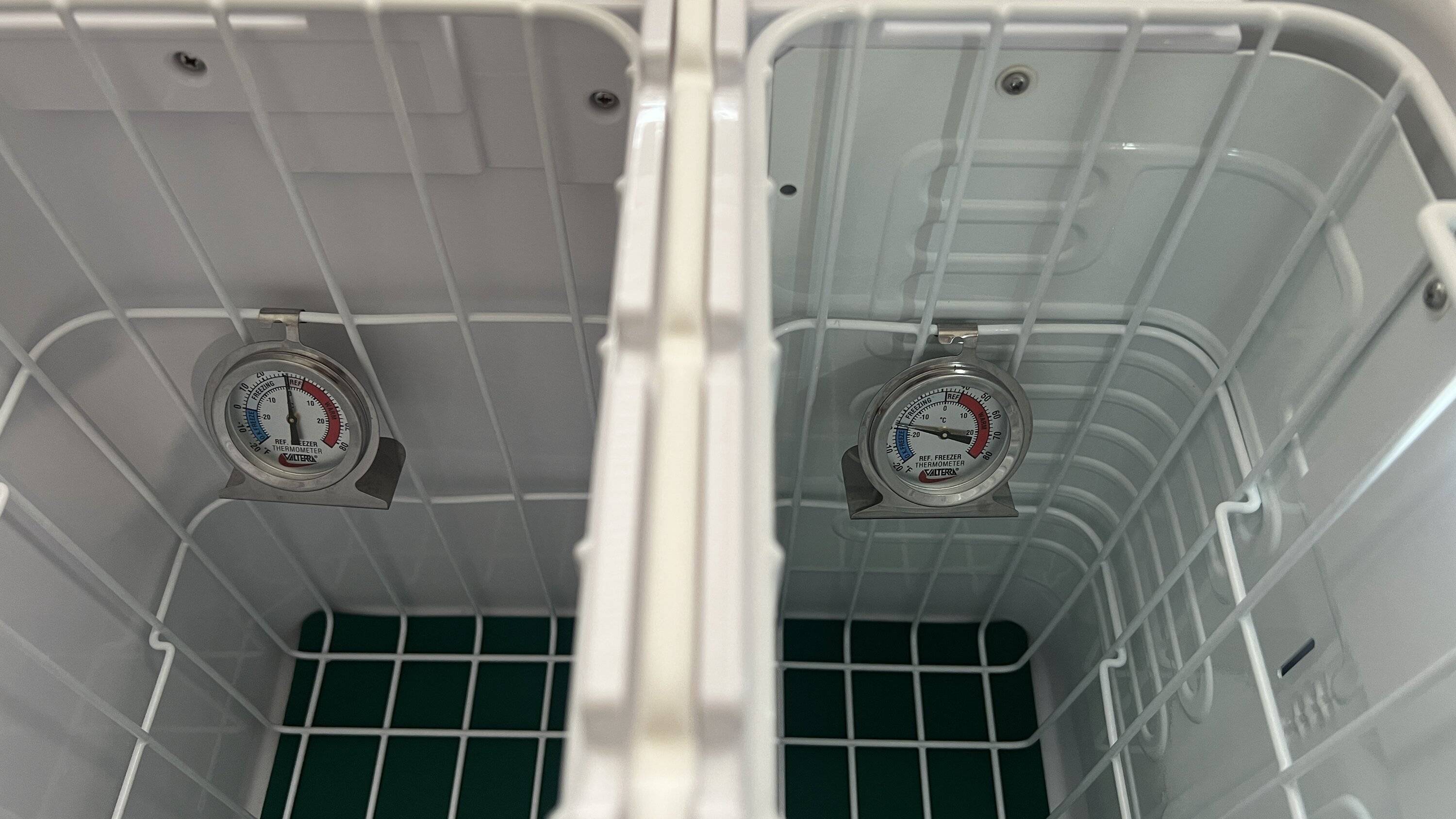

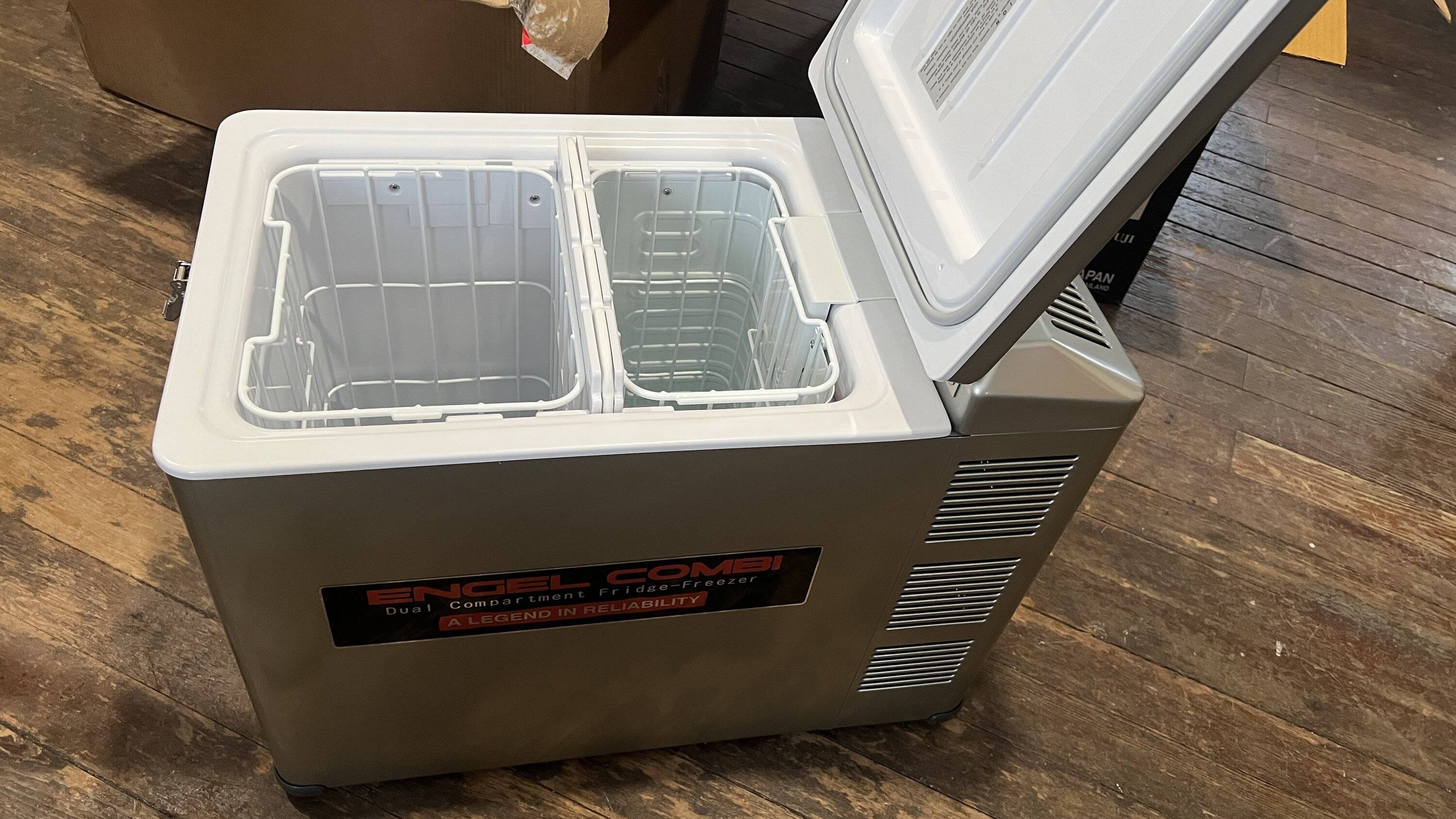

So as the fridge arrived today I have turned it on just to make sure all works ok. Its nice and quiet compared to the snomaster.
with it on the coldest setting (0 deg F in freezer and 30 F in the fridge compartment), it is running approximately 75%. This is running on AC in the house with inside ambient temp at 71 currently.
No doubt it will run more often when full and less often when I lower the temp so that the fridge is hovering around 35 F
Just to show that duty cycles are usually longer than anticipated.
it is interesting to note that the duty cycles are pretty consistent. this is also after the fridge being on for 2 hours to equalize
Jeep Gladiator Genesis batteries - lets do some math 42D74C75-71EC-4DF3-9C45-16B0FFE40E6C
Jeep Gladiator Genesis batteries - lets do some math 3CE7C16B-6710-487E-992D-CF5B4D9F0BC4
Jeep Gladiator Genesis batteries - lets do some math F9DF2F40-3989-43D1-A2DE-17894249D52F
so this calculates to 26.1 amps used in 24 hours. If you recall in post 14 that at 70% soc the genesis aux battery has 23.04 amps available. So this fridge, at the current temps, would run for just shy of one full day with the engine off and no additional loads or charging.
