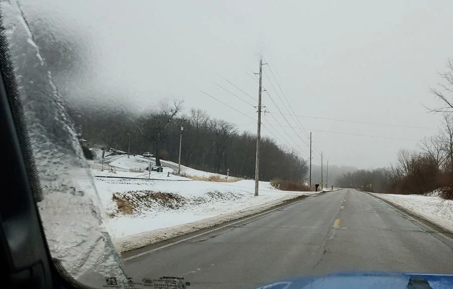

I have a post somewhere in the forum about my experiences with it - and decided it's really not any worse than anything else I've owned, and better than many.
I do what you suggest - I set heat way up, turn off AUTO mode and change to windshield defrost mode, turn the fan up - and it works.
Like many other cars and trucks, the trick is turning the heat temp up and the fan high.
Further - a trick I learned years ago on other vehicles, lower the visors. It traps that warmer air against the windshield. Years ago my wife asked me why I kept lowering the visors each time I hit defrost. I told her next time she needed defrost in her vehicle, lower the visors. She reported back -I see, the windshield seems to clear a bit faster.
Maybe it just feels that way but it sure feels like it works.
This is the worst mine ever got in the middle of one of Iowa's frequent ice storms. It was moments after turning up the heat and fan speed. And before I put those plastic plugs in. If this was as bad as it got - it's at least as good as many other vehicles I've owned.
Most other things I've owned over the years, I got in and my gloves went up onto the center defrost section. I guess I was just used to it.

You can literally see on yours that ice has built up where the wipers still clear. That will cause the wipers to ice up and on any long trip will stop clearing the windows and require you to pull over and clear everytni g manually.
