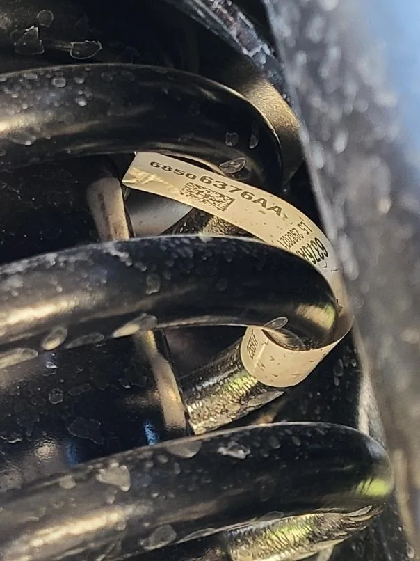

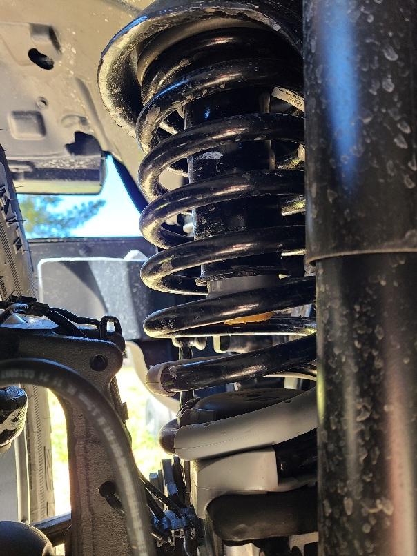

Should throw up a photo of your shock tower and post your spring tag part number. I've seen some photos of a new bump stop collar and would've curious.
My rubicon was an eoy 2021 delivery and still does it.

Should throw up a photo of your shock tower and post your spring tag part number. I've seen some photos of a new bump stop collar and would've curious. My rubicon was an eoy 2021 delivery and still does it.
Hope this helps.

almost looks like the bumpstop tower that holds the bumpstop and new cup may be shorter, like a non diesel model.

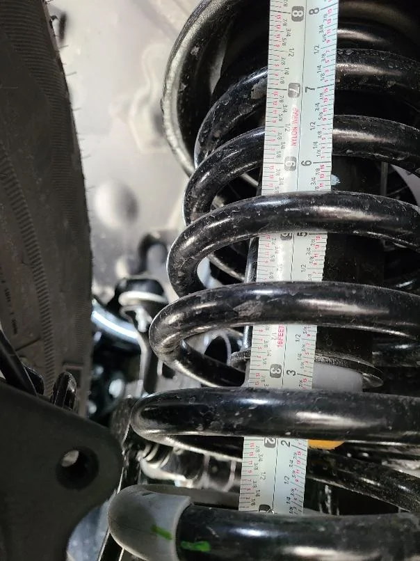

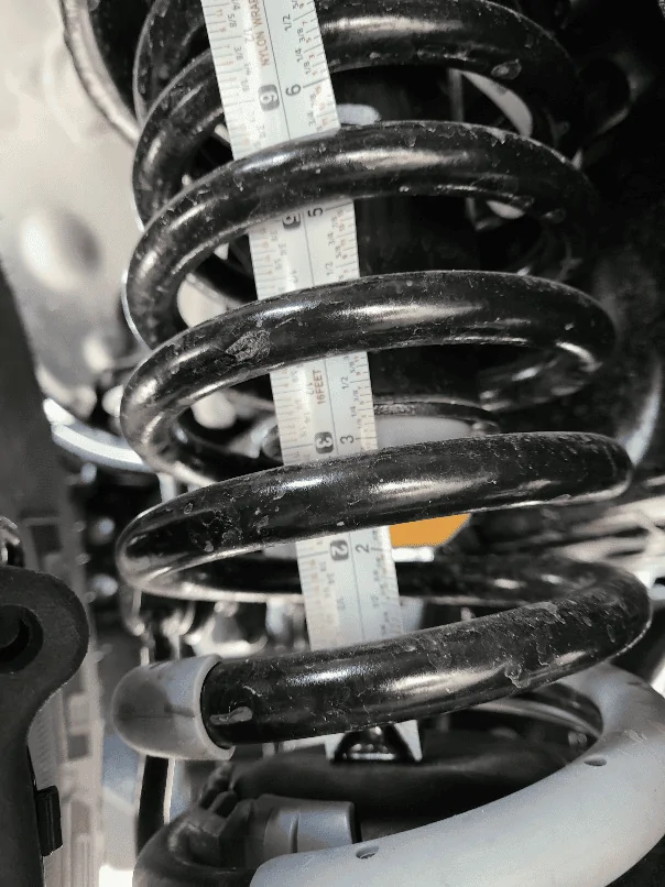

Thanks Bananaman!!! Great Pics!! How many inches between the yellow bump stop and the pad below? Is the distance from the black steel bumpstop holder to the end of the yellow bumpstop about 1 inch?
I'll try to get those today sometime. My wife keeps "borrowing" my new Jeep!
Any update? Would also be nice to know the distance between the bottom plate and where it actually contacts the metal up top. Mine is like 2 inches, but in your pic it looks to be a much bigger gap.

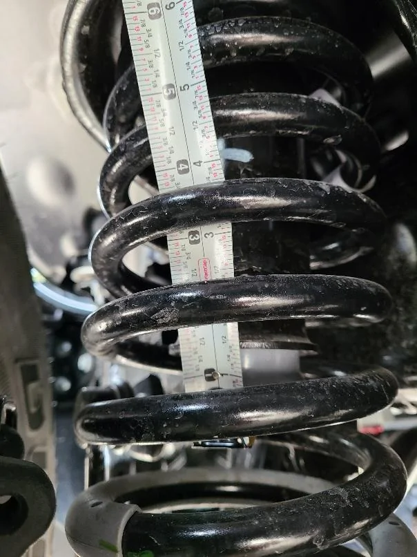

So about 2" from bottom to bump stop and 3 1/4" from bottom to metal lip holding the cup and stop. Also, I think I said my build date was mid December but that was a brain fart. Build date was 1/22/2022
Updated...

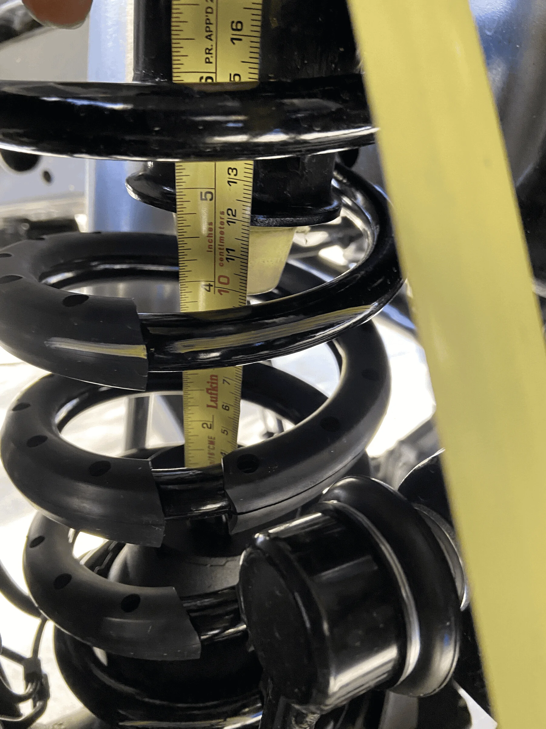

So i'm a little confused. From some previous posts the measurement was 4.75" from metal to metal as shown here; EDIT: Scratch that, this measurement is with a Mopar Lift
sounds like stock this measurement from metal to metal is 2-5/8"
Jeep Gladiator Gladiator Diesel Bottoming Out Poll - Let’s get some numbers here. 1645132170487
But now banana is showing 3.25" metal to metal with the new bumpstop here:
Jeep Gladiator Gladiator Diesel Bottoming Out Poll - Let’s get some numbers here. 1645132226555
Right.
- Stock 2021's have ~2 5/8 uptravel to the metal lip
- Mopar lifted 2021's have ~4.75
Interesting that 2022's have 3.25", with the same spring and shock part numbers as 2021's. How'd FCA come up with the extra .5"? Coil tower length? that was proported to be measured 1.25" different between Gas and Diesel JT's, so don't think they changed that, unless they now have THREE different lengths of coil towers.
Mystery continues.
I still think ~4" of uptravel (e.g. lifted) is the real fix.
