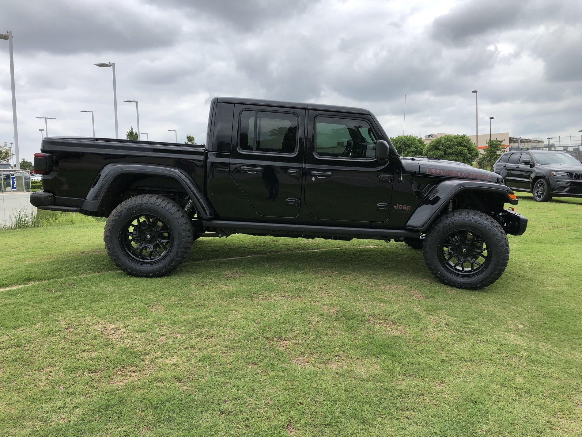

35x12.50x20 , Mopar 2 inch lift .
Fuel wheels with -18 offset
You can own this beauty for a low low price of $72,000 . It’s literally a mile from me

Wait isn't this in Tulsa, this is down the road from me as well. I stopped in and looked and sure it's cool but come on 72K?! I called and asked if they could take the lift wheels and tires off of it to sell it and they said no.
That's just stupid.
