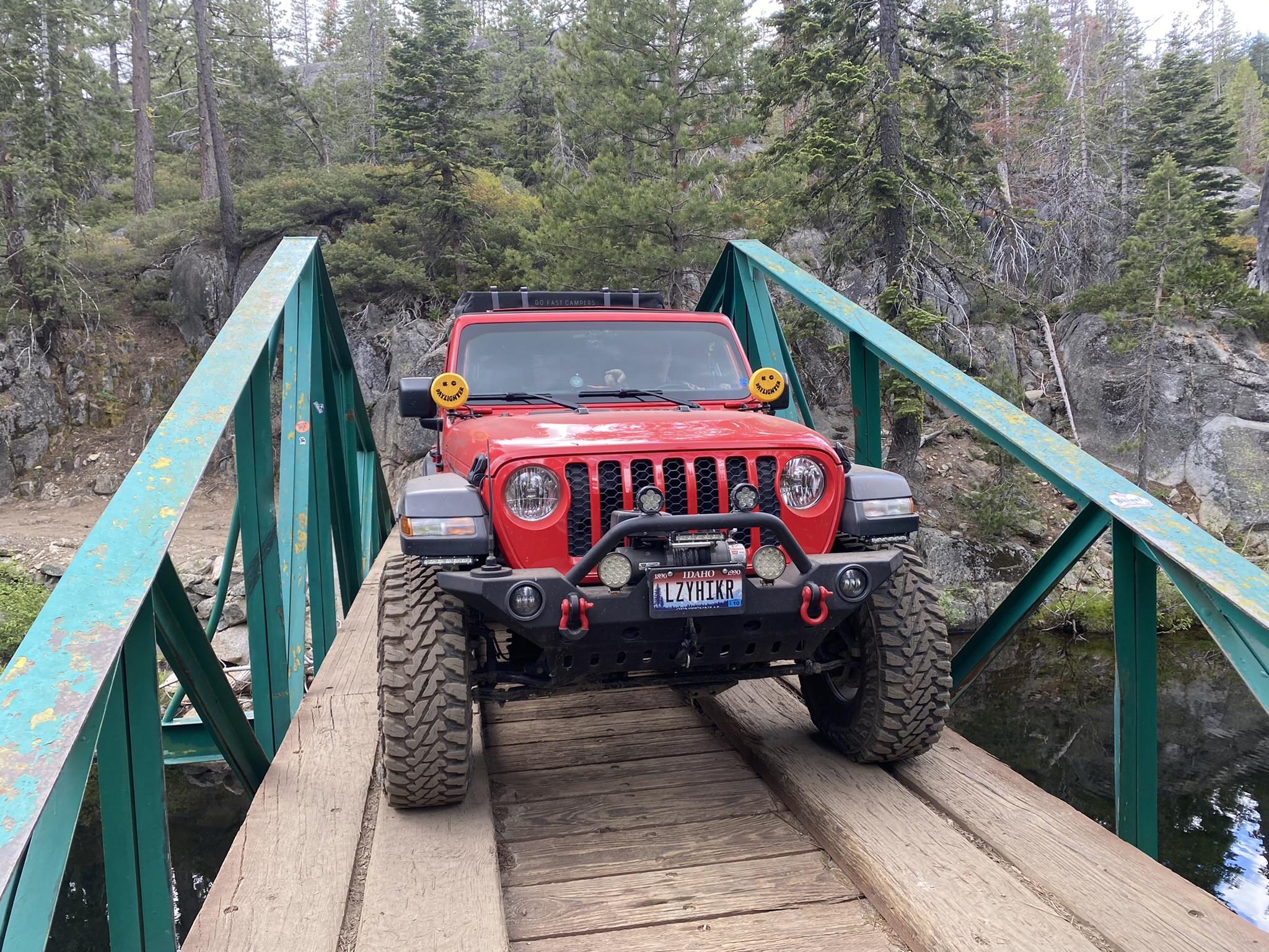

Jeep engineers did it stock. In my experience, there are two main types of wheelers:
1) "You'll never make it through with that"
2) "Watch me"
One of my favorite things about the gladiator is wheeling it hard on the rocks and showing naysayers what's up. My skids, sliders, and bumpers all have done their duties, but the Rubicon only "needs" 40s if you're lacking in the talent dept. (Qualifier-- I would definitely need at least a 37, as my own talent ain't high enough for 35s)

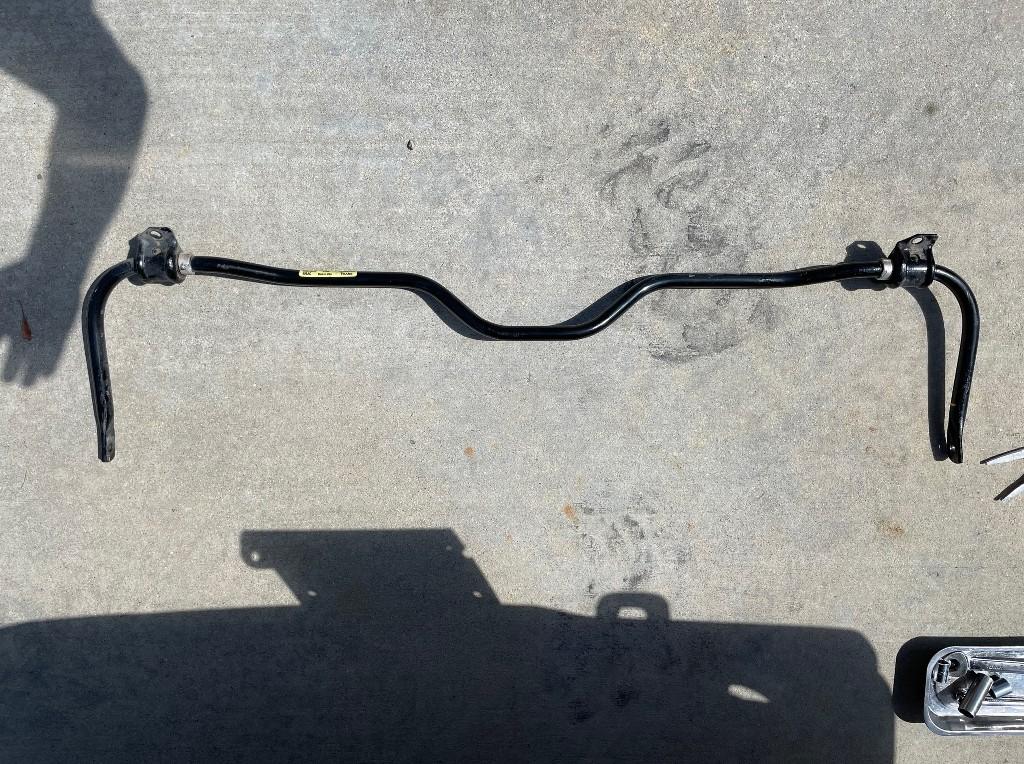

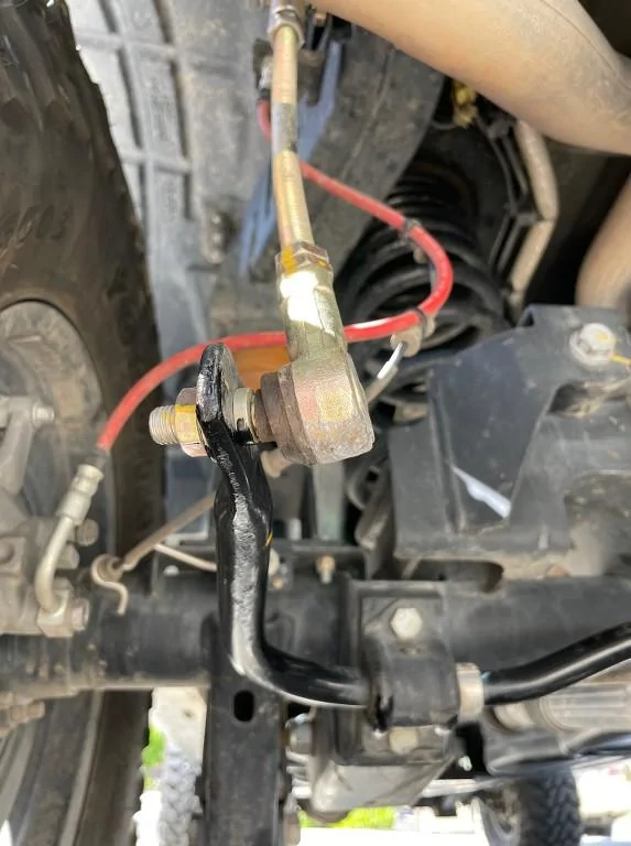

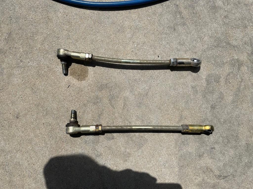

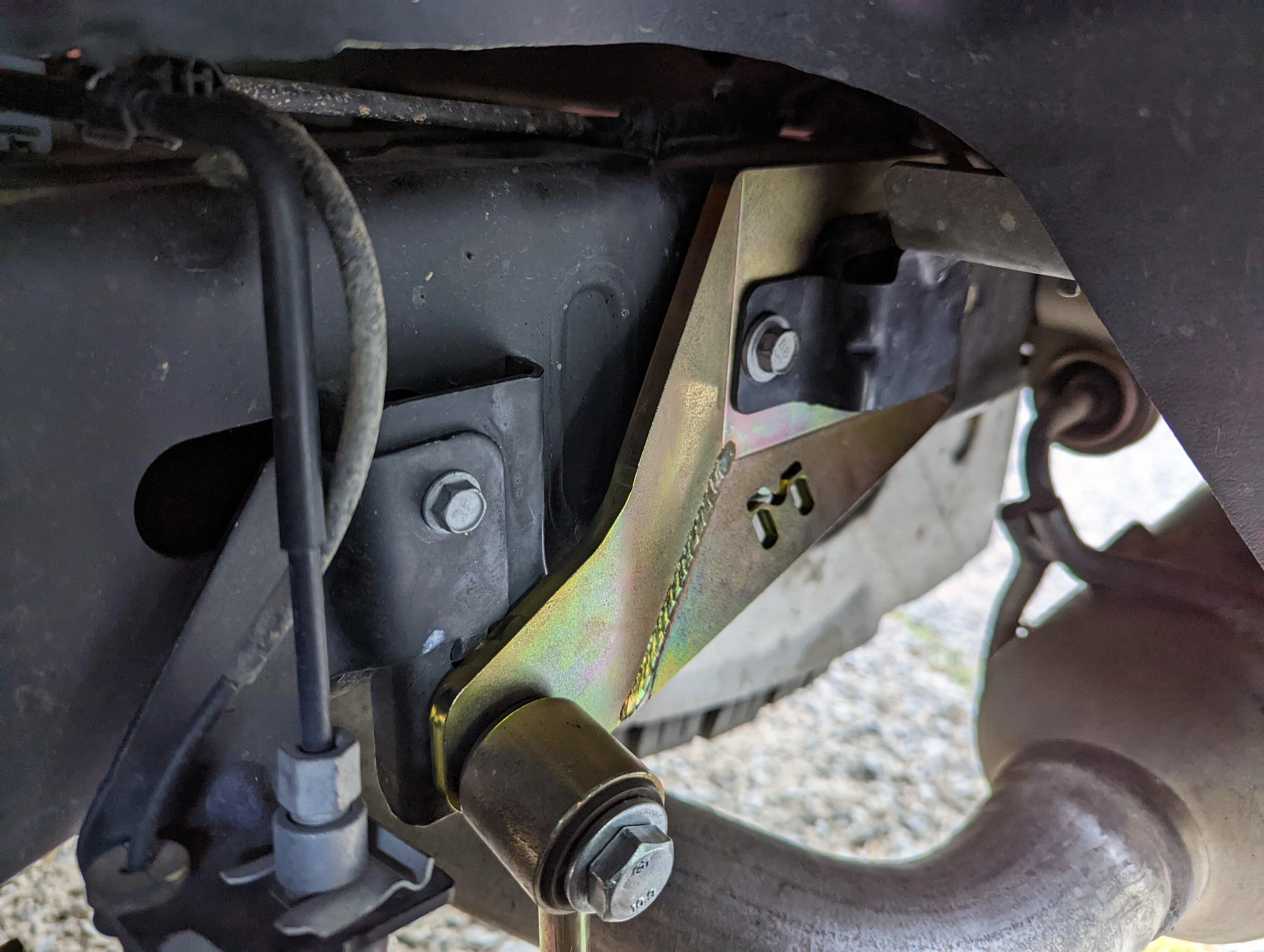

Good info. On the topic of rear end links, I recently got the Metal Cloak rear sway bar link reinforcement bracket and their end links. The factory frame mounts had cracked and the captive nut that is in there was loose on both sides and the reinforcement resolved it. I've seen many pictures of those mounts ripping out. We'll see how long the links themselves last lol.
As I mentioned, the Metalcloak plate did it's job, no problems with the end links mounting location on the frame. The end links stud bent as predicted, but, also the sway bar tabs were bent out.
I just finished the end links job. I went with new rod studs and used a copper hammer and 2x4 piece of wood to bend back the sway bar tabs. My assessment is that I prefer having the Metalcloak reinforcement plate and bending end tabs back on the sway bar and replacing rod studs than dealing with the OEM flimsey end link connection plate at the frame. So, I am glad I have them. Here are some pics:
Jeep Gladiator How successful would my Gladiator Sport be on the Rubicon Trail? sxgiGR
Jeep Gladiator How successful would my Gladiator Sport be on the Rubicon Trail? Hc8DhJ
Jeep Gladiator How successful would my Gladiator Sport be on the Rubicon Trail? UaYXXM
Note: tabs bent out

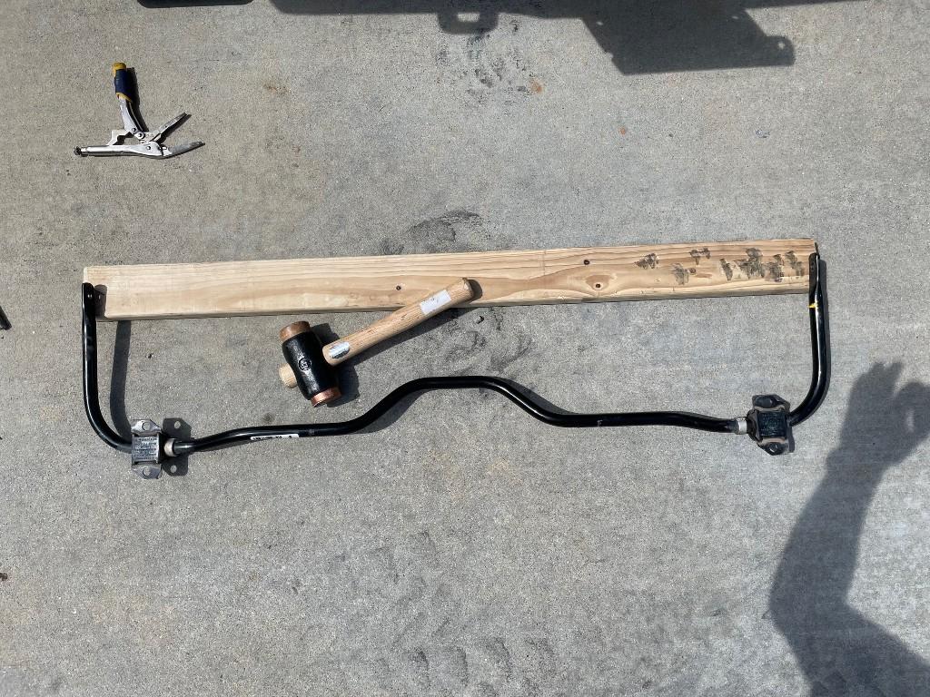

Tabs bent back in with Copper Hammer and wood backstop

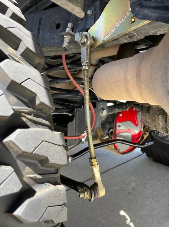

Good to go again !
Note: tabs bent out
Good to go again !
Looks like a simple enough fix. Yea I would rather replace the end links and hammer on the sway bar tabs then have to hassle with the frame side mounts. I tried various things to address those prior to Metal Cloak releasing their reinforcement plates so I am glad they developed those and now not having to deal with those again.

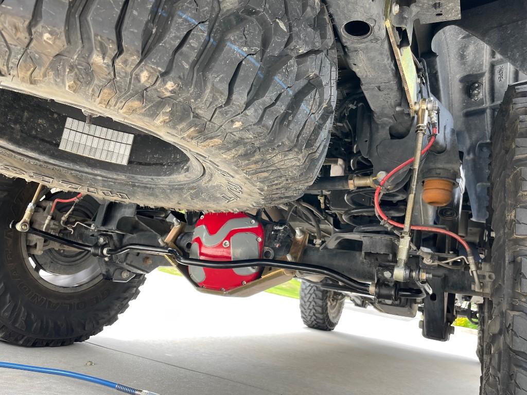

I just did it last weekend. Sport Max tow, no lockers no rear LSD and never spun a tire for more than a few seconds. 5.13 gearing on 37's with a 5" lift. Challenging trail, but I never needed pushed, pulled or winched. I did skip little sluice. I ran it in the traditional direction from the Loon Lake start to the Cadillac hill finish. We stayed 1 night at Buck Island Lake.
