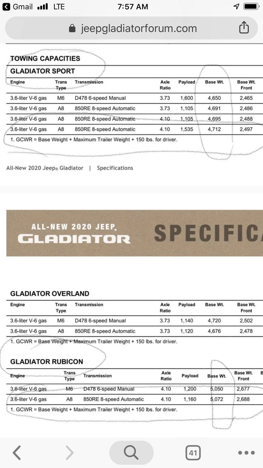

The specs found over on another thread in this forum equate to a 350# difference between the Rubicon and the Sport/S with Max Tow. To say the tires have nothing to do with is pretty bold, even if the .25" difference in height is true. Based on the metric tire sizes that are advertised on each model, the tires on the Sport/S are @31.5" tall and the Rubicon tires are @33" tall. Granted those sizes printed on the sides of the tires don't usually equate to a true size, but that's close to 1.5" difference in height alone so the circumference is almost 4.75" greater on the Rubicon's bigger tire. At least on paper. Certainly big enough to make a noticeable difference in the final gear ratio that actually gets to the ground for a relatively small displacement engine.
Are you talking about curb weight difference? Or payload difference?
As far as the tires go, that's the specific reason I stated that I have done measurements on Sport, Sahara, and Rubicon tires and suspension height with a level and tape measure to get the real world differences. I don't have any reason to believe Gladiator will be different.
I was looking at the curb weights.

As mentioned, only the Sport can be equipped with the 1,650 lb. payload OR the 7,650 lb. towing.
Last I checked, max payload was on the manual and for whatever god awful reason, FCA didnt beef up the manual so its towing is an embarrassing 4500lbs... so you can get max payload or max towing but not both.

I believe the Rubicon suspension and weight are impacting the payload and towing capacity.
YOU are exactly correct.

I don't think it's just tires. How different are the tires really? To me the major difference is the weight that the rubicon components add.
Somewhere I remember someone saying that the Rubicon was about 500lbs heavier...
If you're really pushing for that extra 650 lbs of tow capacity you might want to look into a different vehicle for towing. The engine in this vehicle is still going to whine at 7000, let alone 7650.

Is it me or does the Gladiator advertisement seem a little misleading. I was told by my salesperson that the the maximum tow package was already a part of the Rubicon tow package. He showed / told me that the maximum tow package was not an option for the Rubicon because the components of the maximum tow package were automatically included in the Rubicon tow package. It seems that the dealers/ salespeople are not really sure about building specifications themselves.
So far with my Gladiator what I've discovered is that you cannot ask a salesman, they will tell you anything to get the sale. Only the Sport model can be configured for Max tow. It has to do with added weight on the Overland and Rubicon. The max tow has the Rubicon 4.1 wide axle, no other suspension difference. The max tow weight has to do with added weight on Rubicon (heavier skid plate, etc.) cutting into the tow weight.
