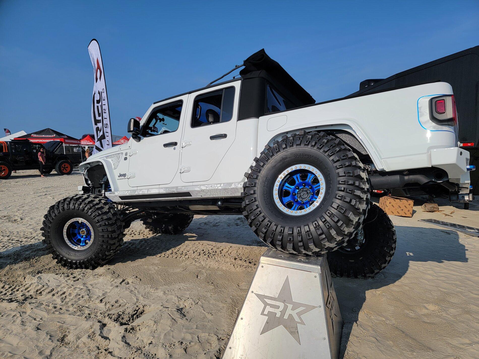

35's are the new 33's.
37's are the new 35's,
40's are the new 37's,
42's are the new 39/40s
Jeep Gladiator I know I’m going to catch grief for this question. Why go larger wheels and tires 20210710_082810

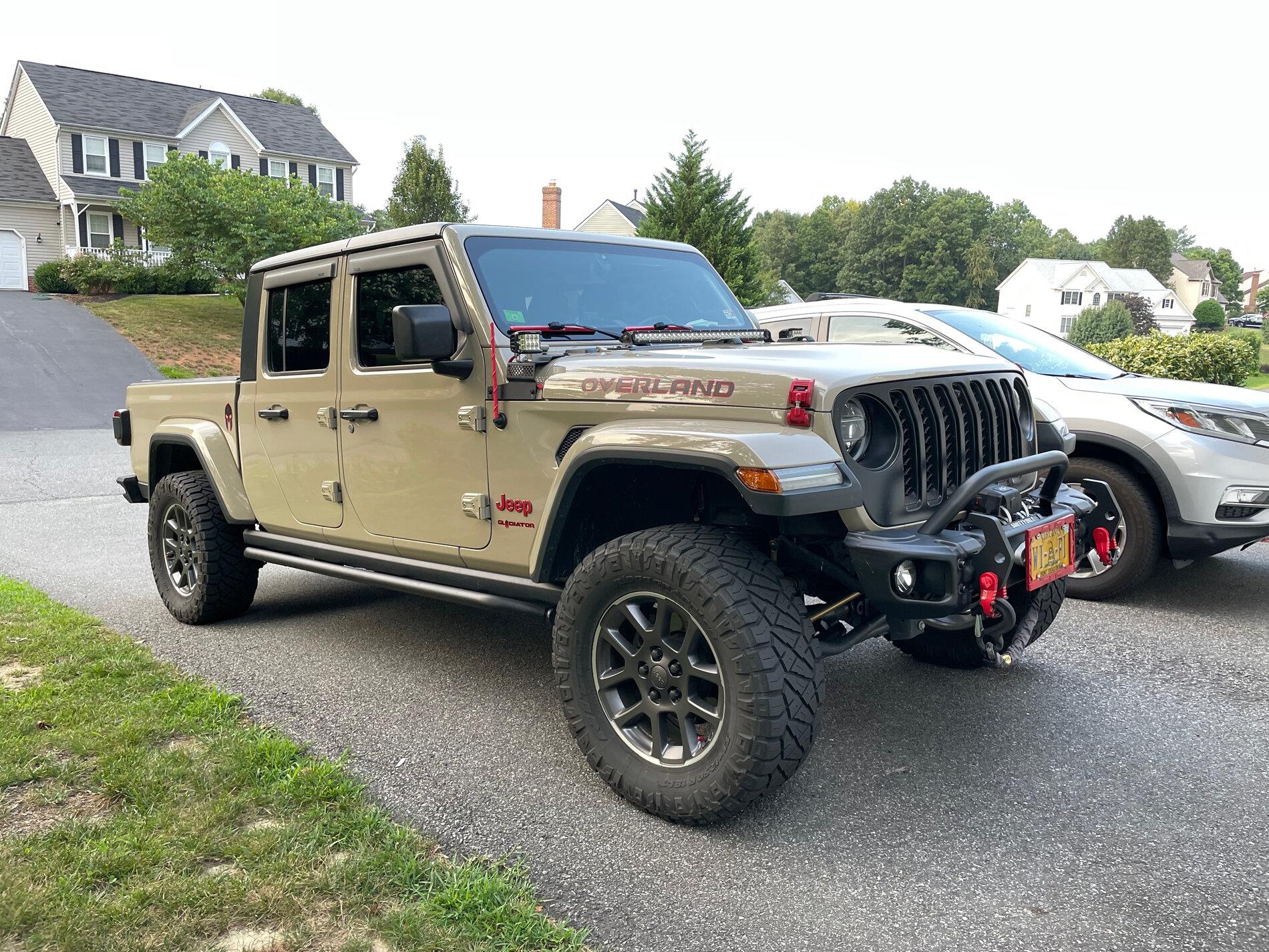

I off-road, but not quite "hardcore", because this thing still has to get me to work. I haven't lifted, but the last trail I went on, I scraped the skid plates more than I would like. I have the factory Rubicon 33s now, so I'm going to 35s. This will give me an inch more ground clearance and also protect my wheels a little more off-road. The mpg hit from 33s to 35s will be pretty trivial, so I'm not worried about it. If after I put the 35s on, I still scape, then I'm going to do a couple inches of lift. I'm also already adding more skid plates for the areas that the factory skid plates don't protect. For those that don't off road, the appeal is the same as changing rims on any other vehicle. It's simply the easiest way to make the vehicle custom and yours.
do it right the first time. I am ditching the 2 inch lift and 35s for 3 inches and 37s since the scraping is still way too much on 35s w 2 inch lift.
also the fuel economy hit going from 33s stock rubicon A/T to 35s M/T ridge grappler is significant just a heads up. If you just do another set of slippers maybe not so much
