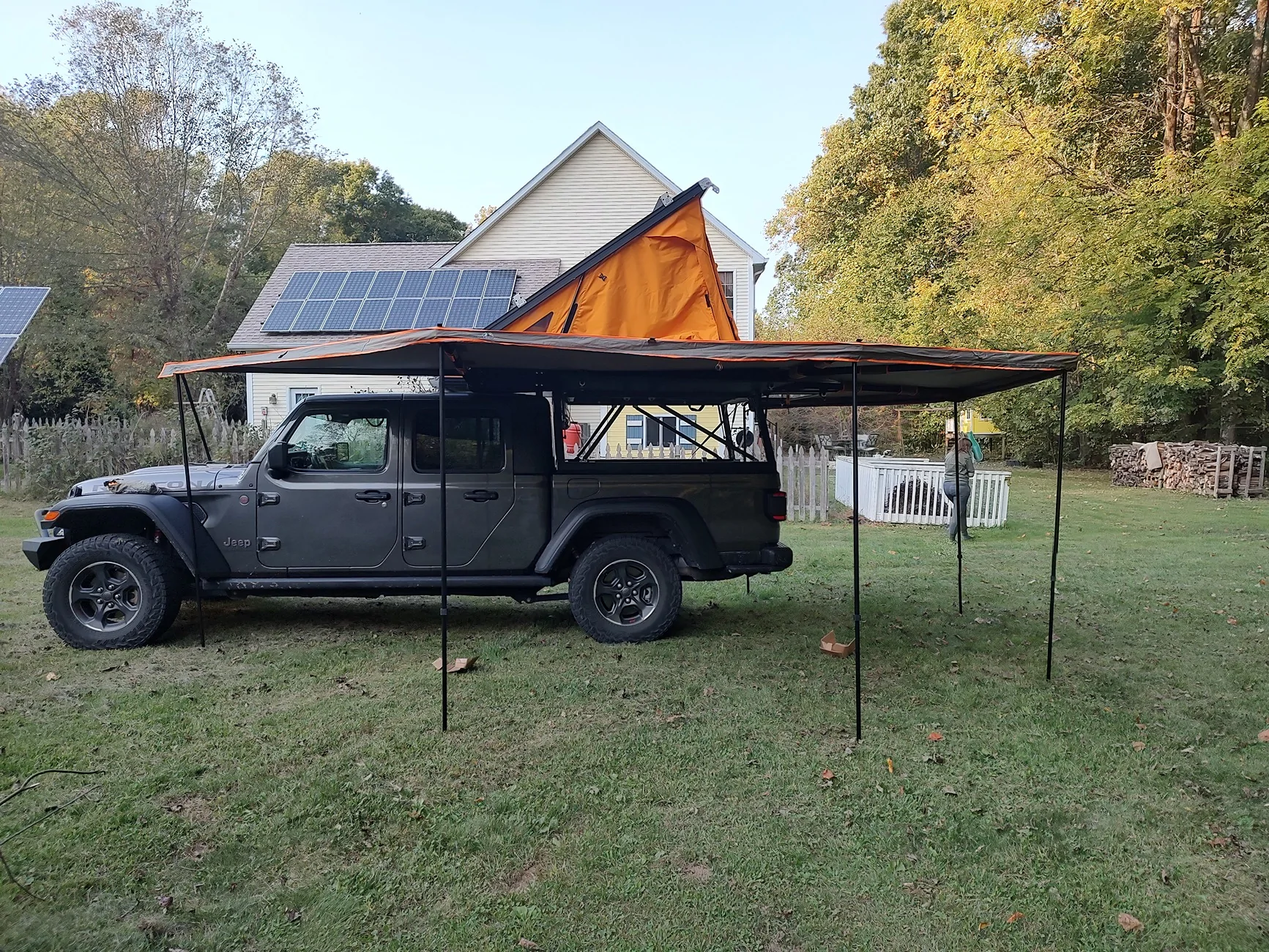

Chemist
I have the GFC camper with a 270 awning.

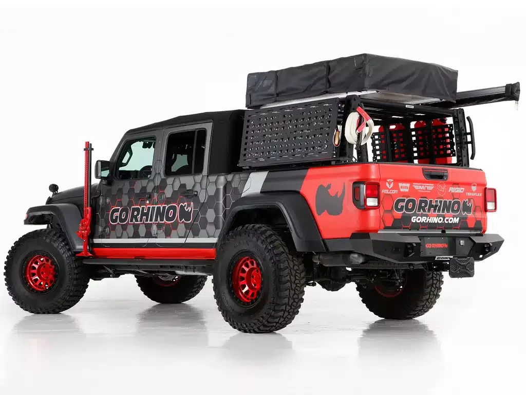

With a rack like the RealTruck Go Rhino XRS Overland Xtreme Bed Rack, you have the freedom to attach multiple accessories and gear holders.
Jeep Gladiator I need canopy suggestions please 1784303546817-0q
RTT up top, awning along the side, Rotopax containers, recovery straps- you name it, the options are there.
