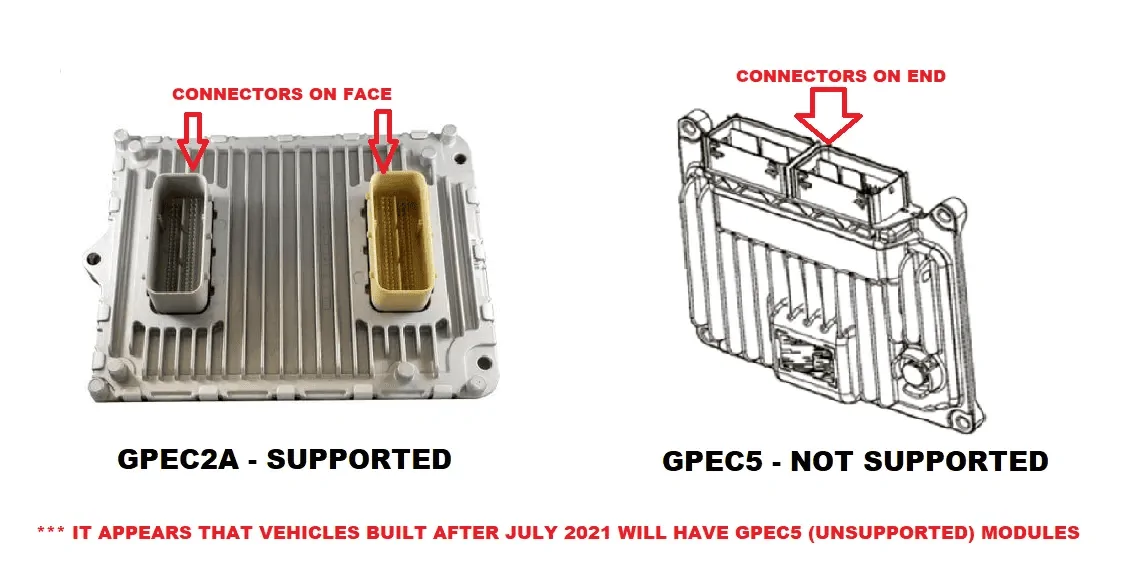

If you are thinking about a tune or forced induction, you need to check your ECM first. The one in the right of the picture, currently HAS NO TUNING SUPPORT.
The change is seen on late 21 models and not communicated or well documented. The dealer parts system does not even show this change has taken place..

Any updates on this? I have an early 2022 and it has the one on the right. ☹

I was in contact with HPtuner on the last day, exchanging emails re unlocking the GPEC5 for my Gladiator 2022; the following is the bottom line of the conversation:
I have seen a reply from the team that does state the security on these is a lot harder than normal, could even be we never support it.. as it seems that way.

If they can crack open John deere tractors, then with enough time the gpec5 will get opened, especially when it's used on more and more cars.
