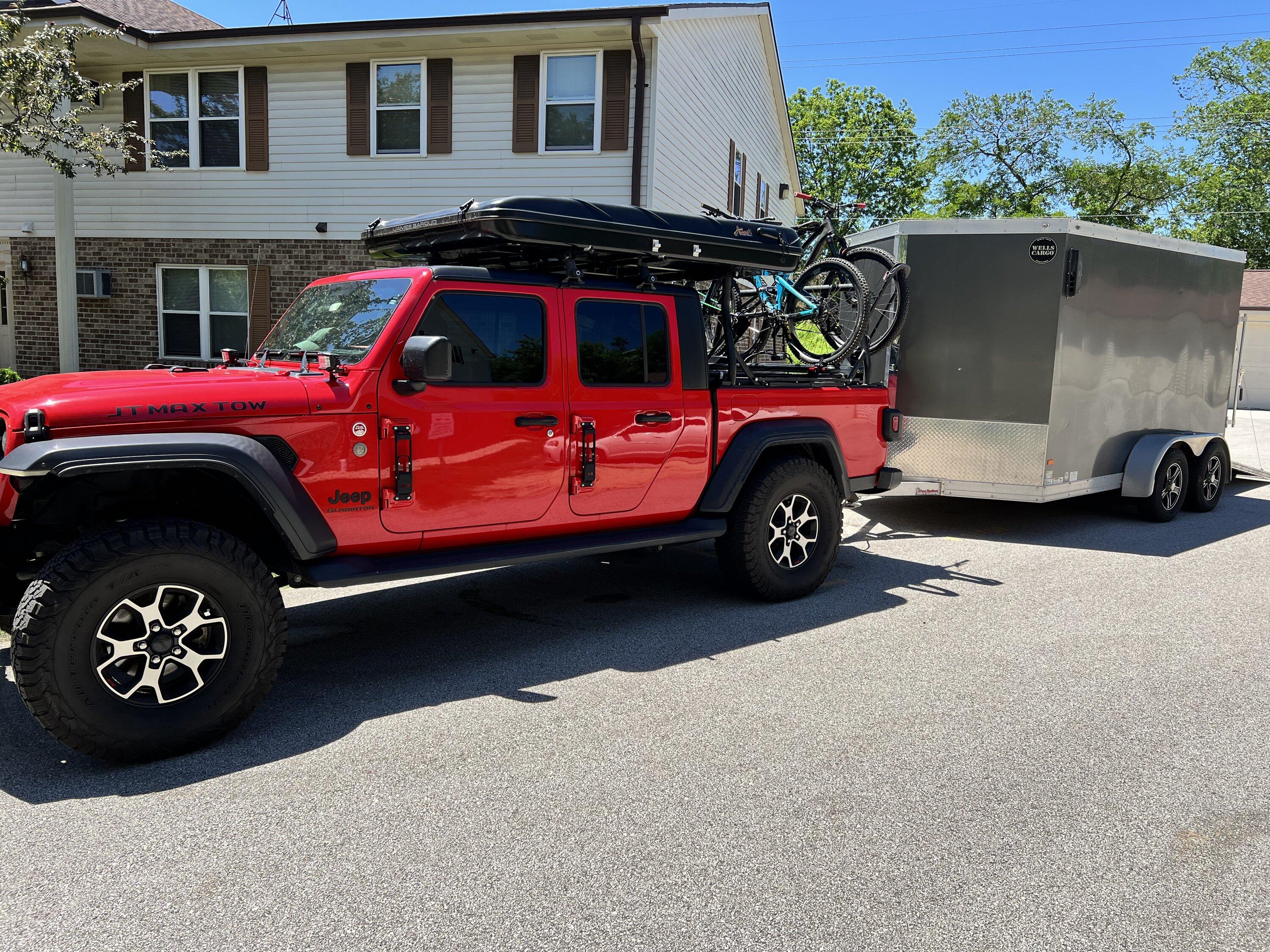

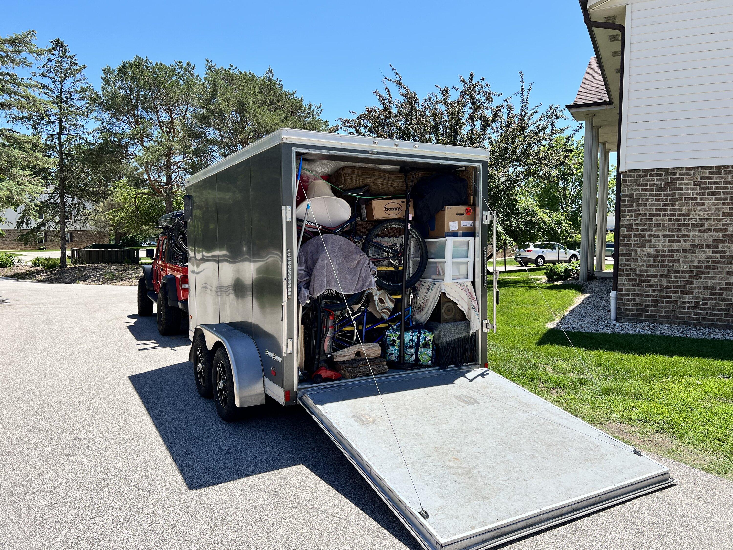

Mine is a May 2019 build Max Tow. I have 80,000 miles on it and I’ve been very impressed with heavy towing(close to 8000#s) and daily driving. Still has the stock 4:10’s. You do need to let her run higher rpm’s and towing I use the manual shift mode with great results.
I know what power is, as my DD is a 2013 sleeper built Mustang GT convertible with a built 5.0 coyote, lots of handling upgrades and manual 6 speed.
I love my JT and the 8 speed Auto!
