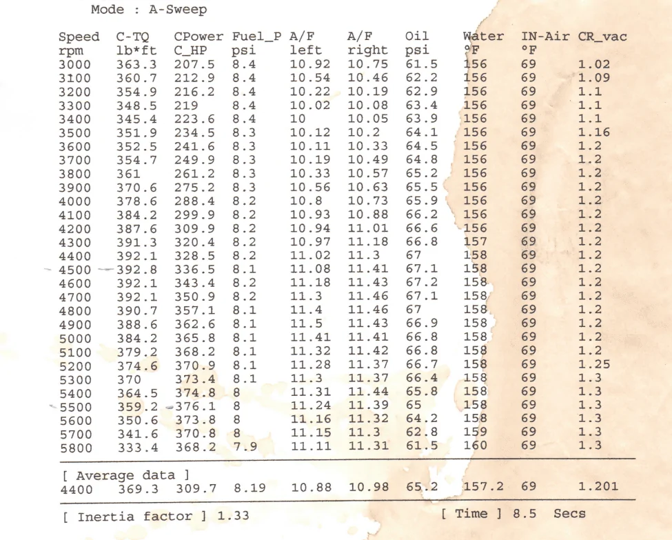

Derived? Well, unless you use a dyno and actually measure it. Otherwise yes, it's calculated for marketing, etc.
Horsepower is work done, so it can truly be measured and proven.
One of the pages from my 73 Javelin 360 - real numbers, not calculated or "derived" -
<snip>
"HP is calculated from the following formula: HP= (torque X RPM)/5252. Dynos that only measure hp are making a series of calculations. Force = Mass x Acceleration, Work = Force x Distance and Power = Work / Time. The mass is the weight of the rollers. The acceleration is obtained by measuring the speed the rollers. "
180
29,415
34,990
Yes math has to be done to calculate the amount of work being done but it's specific, unlike the old calculations used for marketing car HP. I know HP- but you made it sound like it was all theoretical and conjuring up numbers and that it wasn't actually measured in real tests.
We had a small dyno in high school and one of the things the teacher did to demonstrate HP was to check out small engines (like 3 to 15 HP)
Interesting how accurate advertised HPs were on those things. If it said it was 5hp, we measured within a tenth of 5 hp.
