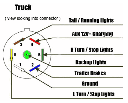

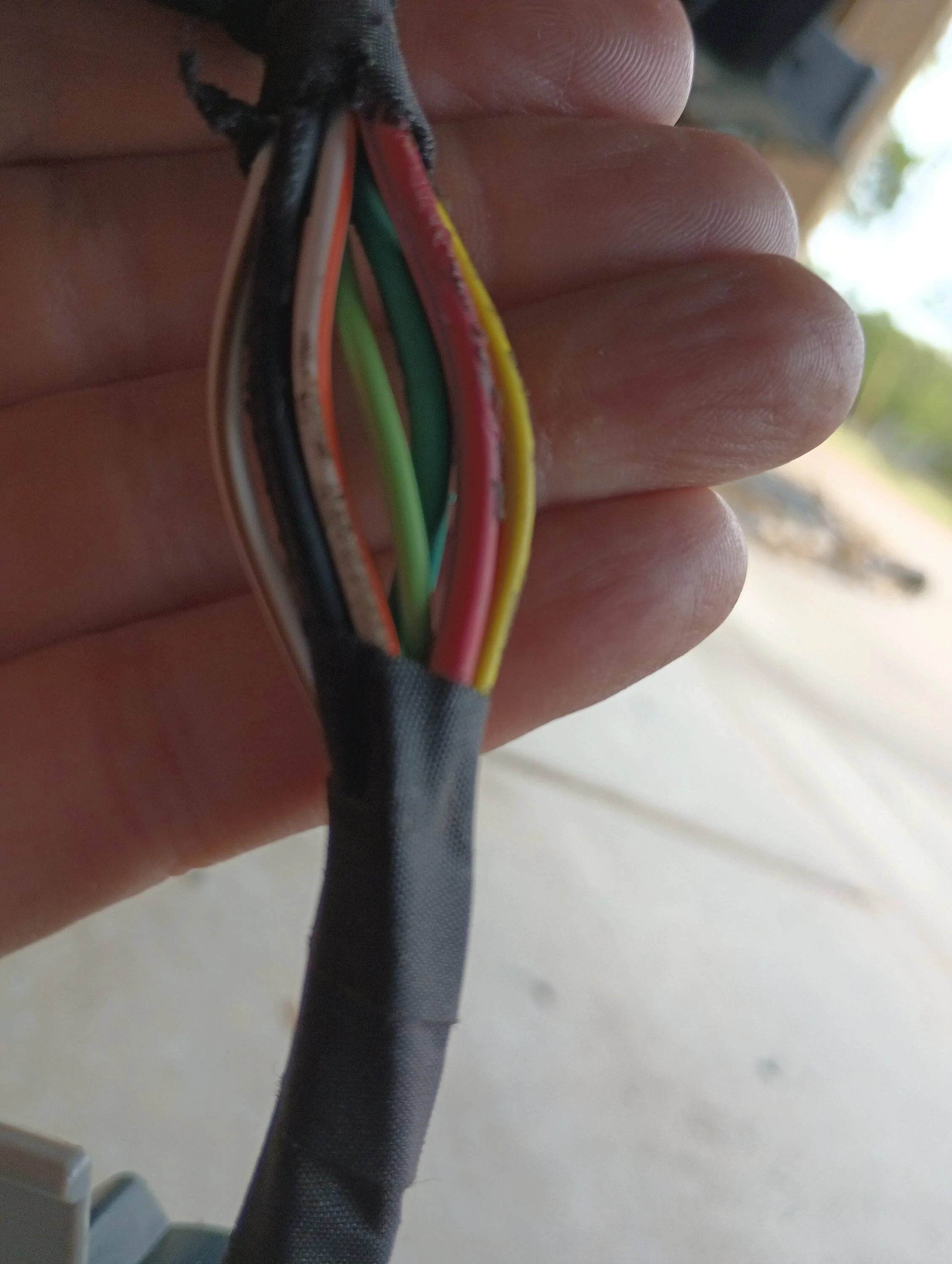

Ok, I've looked at many wiring diagrams and I just keep not finding one which has all the colors represented here mapped to the right circuit. Interested to locate the tail/license plate lead for the trailer. Can someone point me to the corresponding diagram? Thank you!

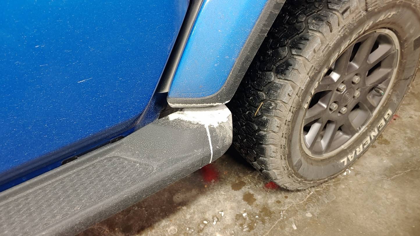

I hear ya and agree........ and then you know what the white stuff here is LOL

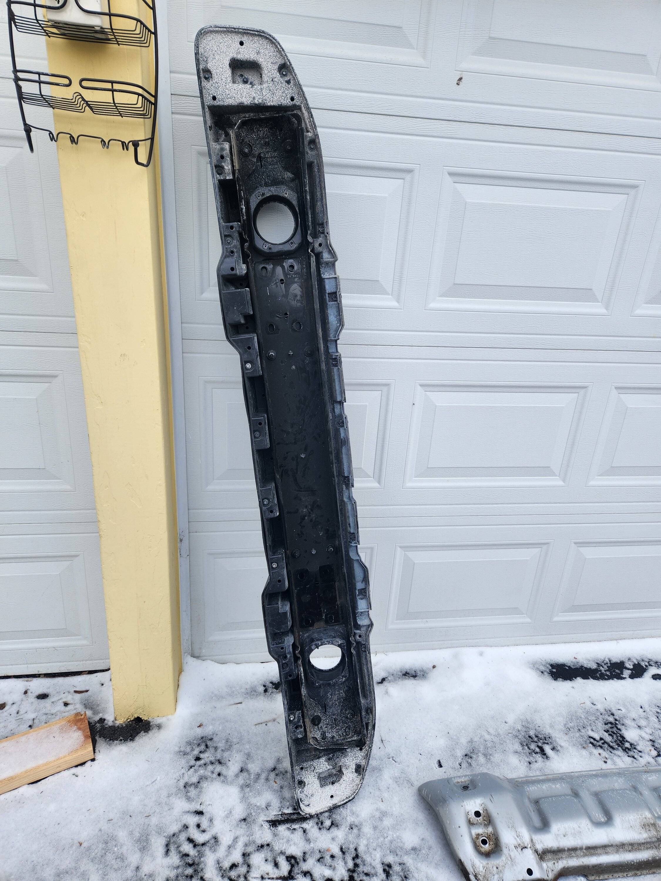

Jeep Gladiator JT trailer wiring harness dissection 20221220_162442
Jeep Gladiator JT trailer wiring harness dissection 20221220_162504_HDR
Beemer533
Zion
Oct 25, 2021
620
715
Upstate NY
2021 JT Mojave
Field Engineer
All too familiar lol. I think most years we get more salt than precipitation.
Makes everything nasty..

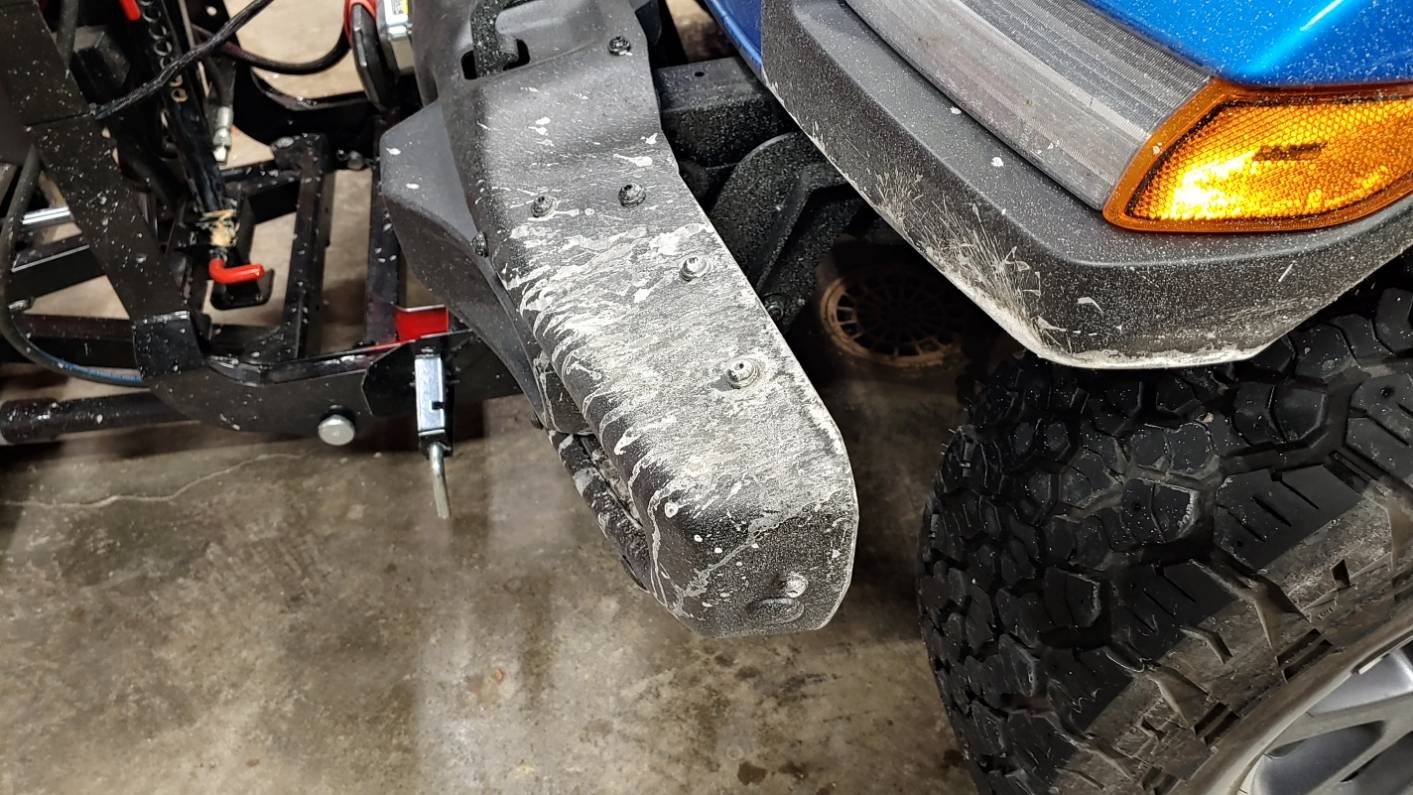

Jeep Gladiator JT trailer wiring harness dissection 20230319_162810

Thank you all. On the color coded diagram above, I looked at that one a few times and just not seeing the color alignment that I was hoping for vs the one in the harness itself. I'm aligned this isn't necessarily the most awesome place to perform a splice but good news is I'm not in a snowy/icy climate and will ensure I protect it well.

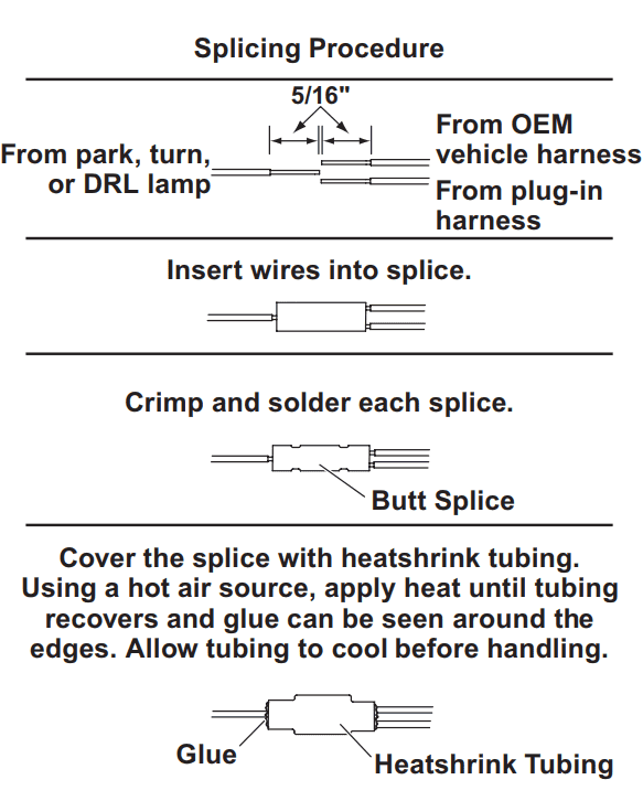

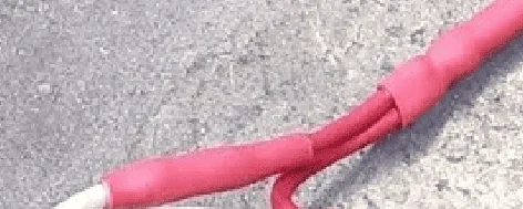

Why get so messy?
Having worked in an electronics engineering company and watching how they did their wiring for atmospheres at petrol drilling sites, pumping stations, pipelines and other nasty places, and then going on and making wiring harnesses for automotive restoration, it's really simple.
Electric tape is short term, especially when exposed to elements. It will fail.
I've had liquid tape fail as well - it's very dependent on the type of insulation used on the wire. It just won't last against certain wire insulations.
Do it like the pros - look at wiring harnesses that come with equipment like the RSE power steps or other fun stuff. They use either a butt splice crimp or solder the wires and use a sealed heat shrink tube over it. That's all that is needed.
Extremely simple process:
DO cut the wire, use either a factory type crimp connection, or solder, then use a marine type heat shrink.
Neat and a forever joint.
It's how I did a lot of the wiring when I merged the Jeep PDC and PCM into my car's original systems.
Here's one explanation from Douglas Dynamics/Western Snow Plow -
Jeep Gladiator JT trailer wiring harness dissection 1681999972755
You can use solder only after twisting the wires together and skip the crimp splice, or use a quality splice connector.
In any case, a good water-proof heat shrink will seal it proper. If you are paranoid after that, you can use a type of tape that is rubberized and sticks to itself. Stretch it around the joint like you would electric tape, but use a bit of stretch in the process of wrapping. Because it's rubbery it forms snug around nooks and crannies and forms a bond to itself that's so good after a few hours you can't pull it apart without cutting it or ripping it to shreds.
It's neat and very sealed, although the marine type heat shrink with the glue inside is all that's really needed.
