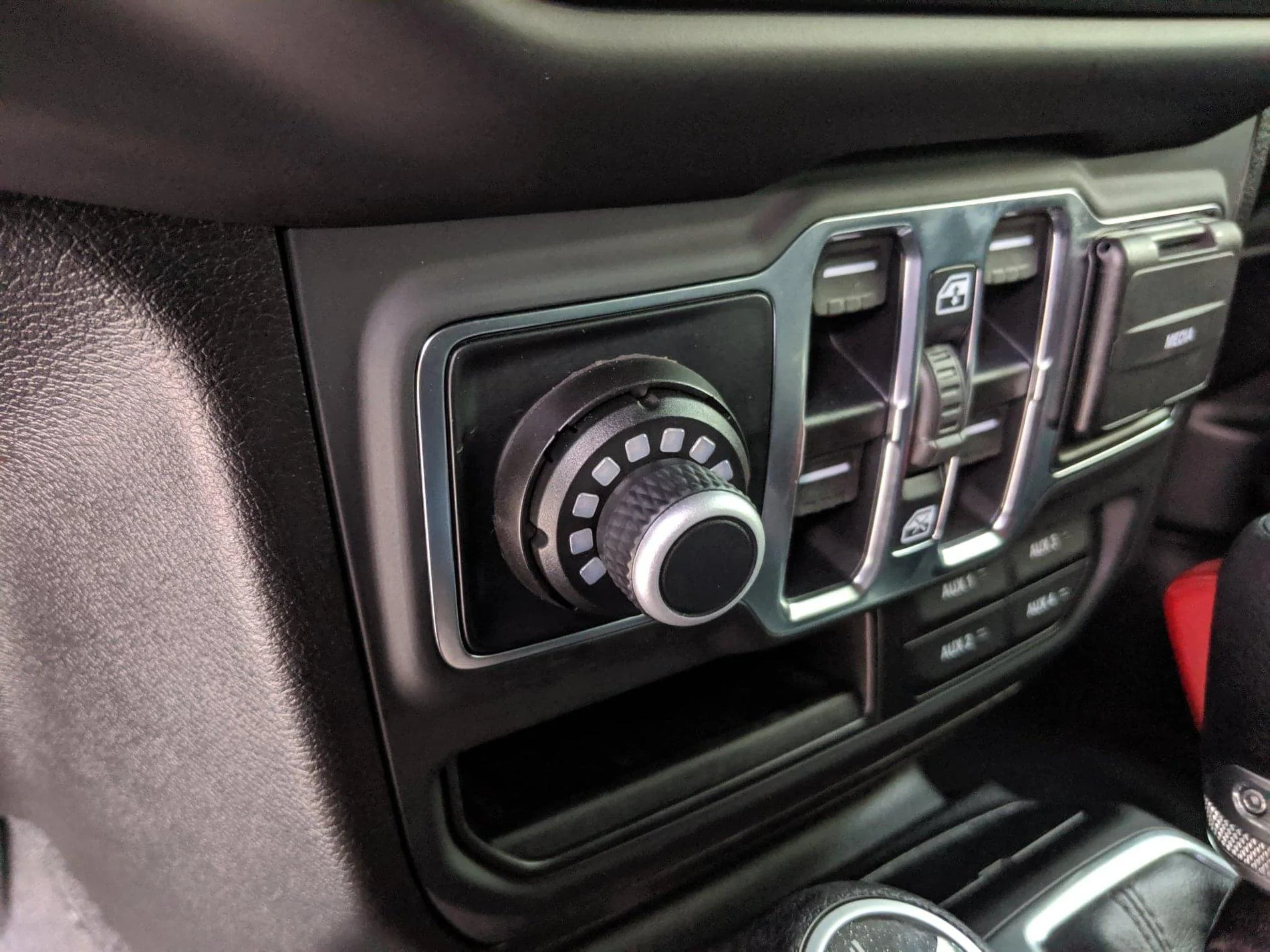

The adaptor you need will depend on the BRAND of controller you end up with. I just installed a Curt Spectrum controller so the harness was Curt #51459 (which will work with pretty much and Curt controller). Looks great, IMO and matches the other panel components. Like the Redarc, it has a separate module. Unlike the Redarc, you can install it without putting any holes in your dash if you choose too.
