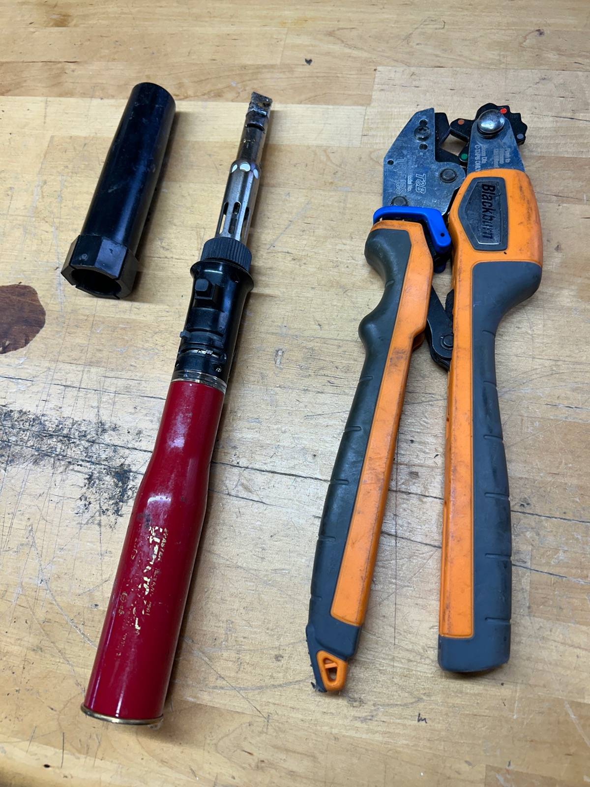

Electrical Foreman
Industrial electrician here. I reaches for these every chance i get as it's convenient. We usually crimps and solder, depending on conditions. Not cheap though. Crimps up to #2.
