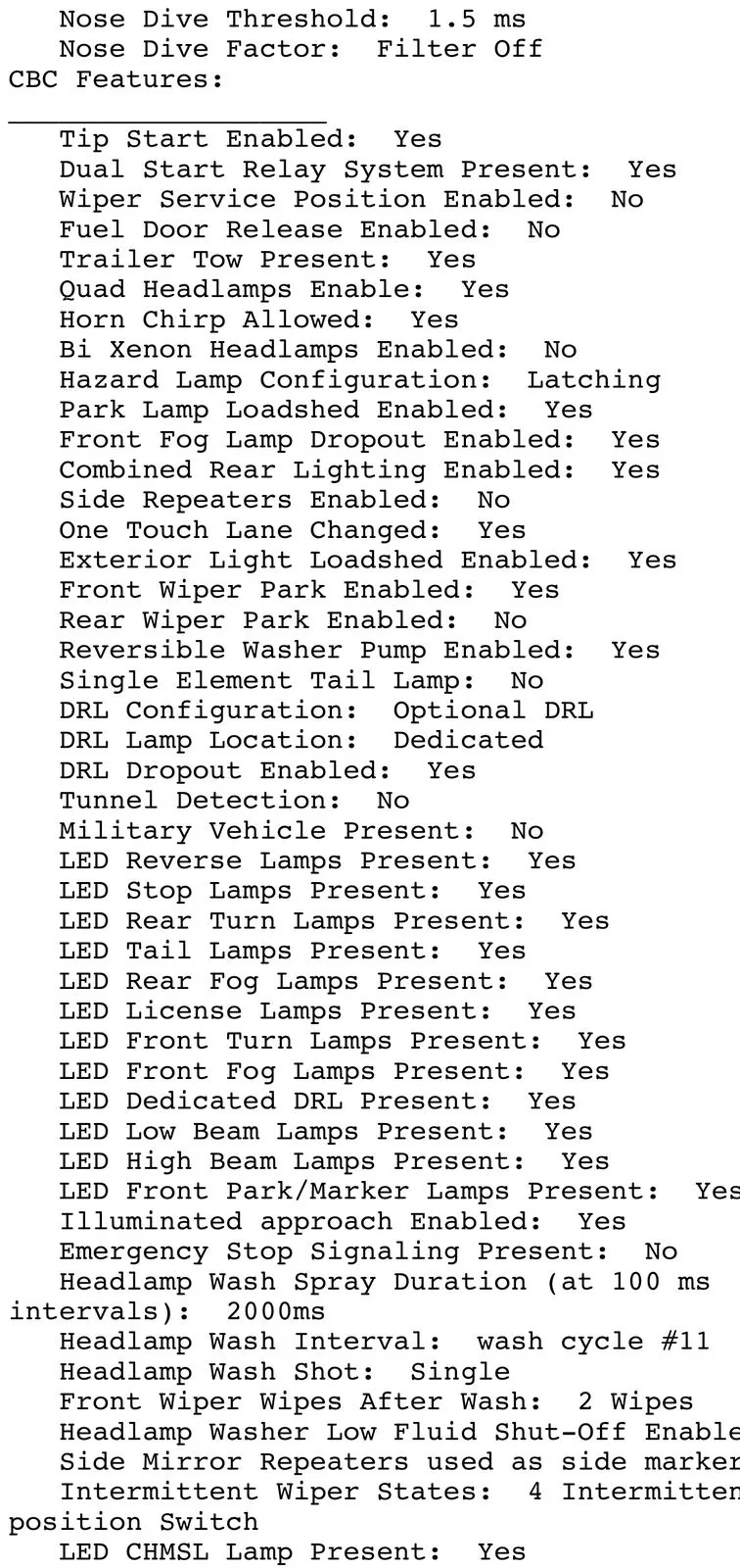

What the LED settings in Jscan does is shuts off the pulse width modulation in the BCM for those bulb driver circuits. On halogen equipped vehicles, PWM is used to rapidly turn on and off the circuit (duty cycle) to extend bulb life. The duty cycle changes with current load, and LEDs are more susceptible to flickering if the duty cycle is too low, because an LED instantly goes out when power is removed from it, as opposed to a halogen “dimming to off”. The BCM is also sensitive to detecting the brief zero load when LEDs are pulsed off, so it might think a bulb is out. Here’s a screen grab of a factory equipped LED package configured BCM-
Jeep Gladiator LED Bulb Replacement - IT WORKS! Ik5kZra
Thanks for the extra knowledge. Still don’t understand why my truck seems to be a random for a wavy pulse like on my front lights when at idle. I don’t think they did it when they were all halogens. Not sure if I ever paid enough attention.
Either way the LED setting seemed to make it gone from what I can tell.

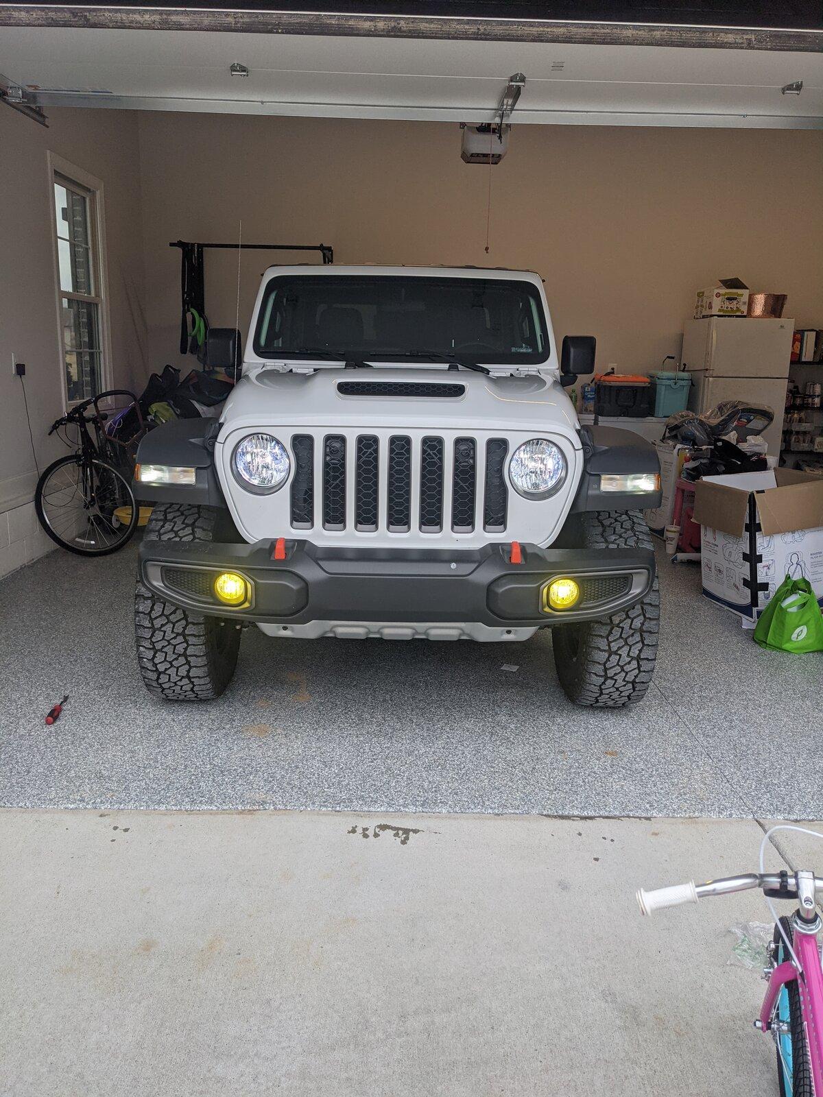

Got all of mine swapped this morning. Looks so much better. Excited to see it tonight.
Decided to give the yellow fogs a chance. Never had them before.
