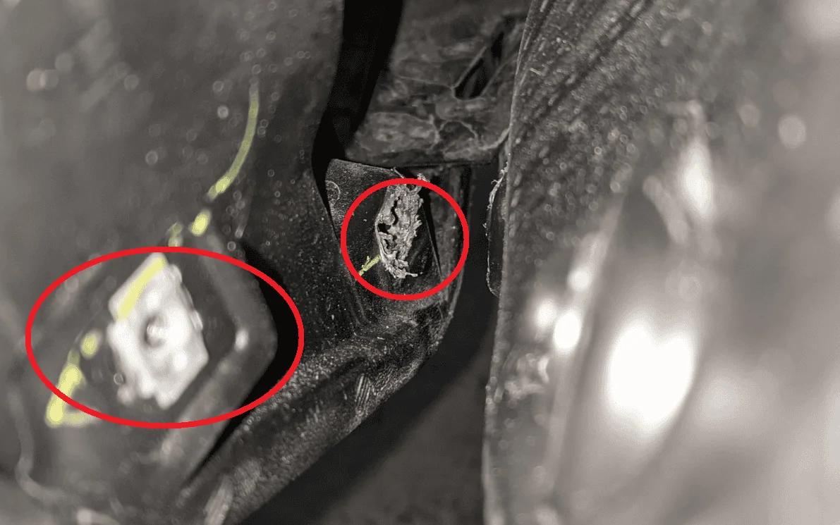

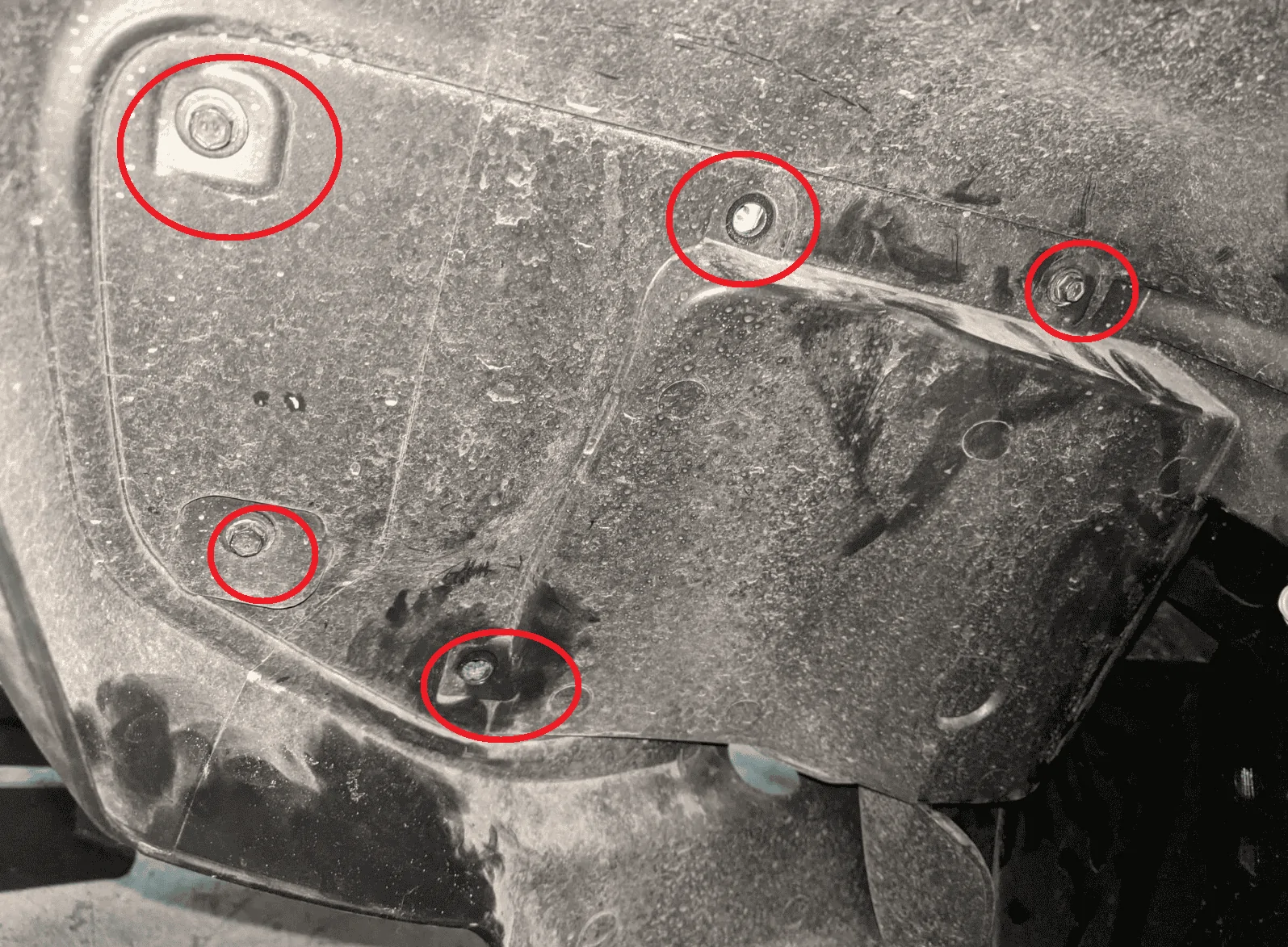

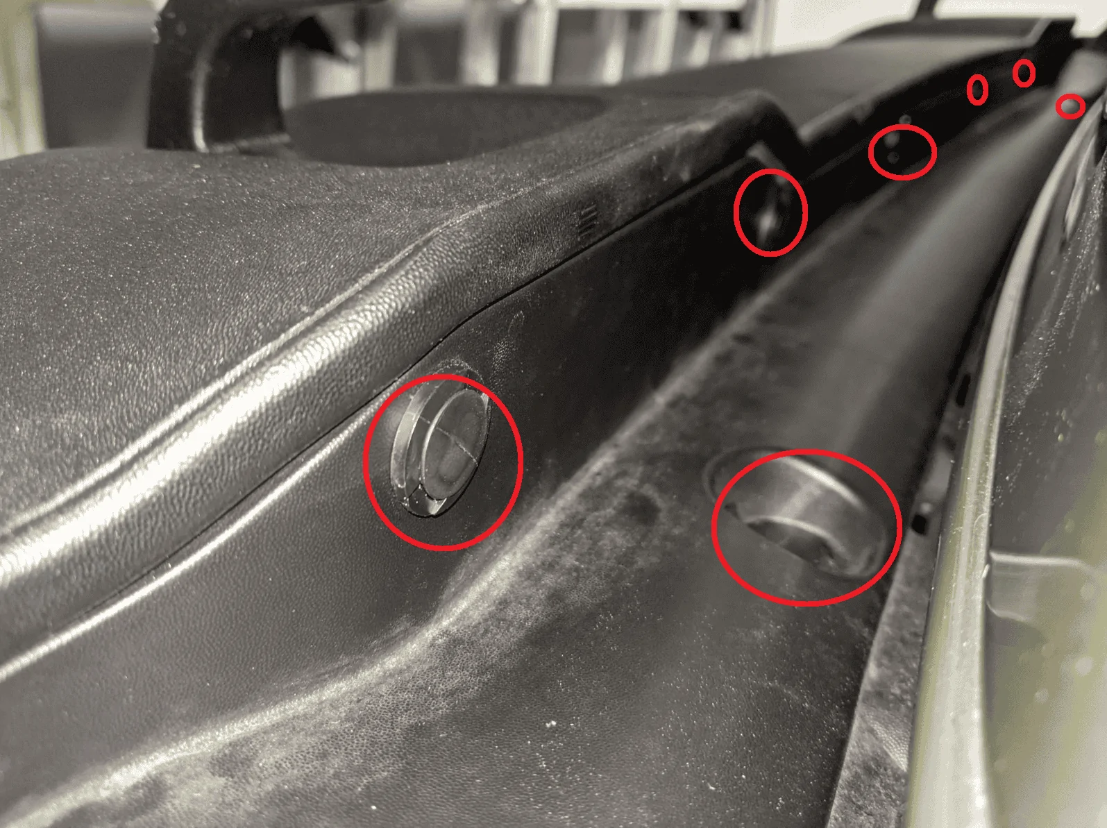

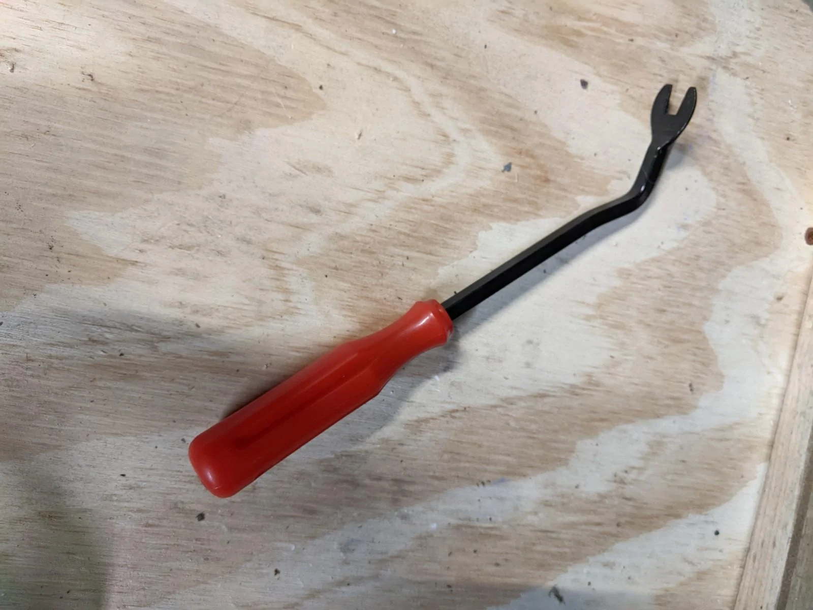

Step 1: remove clips, super easy with clip removal tool

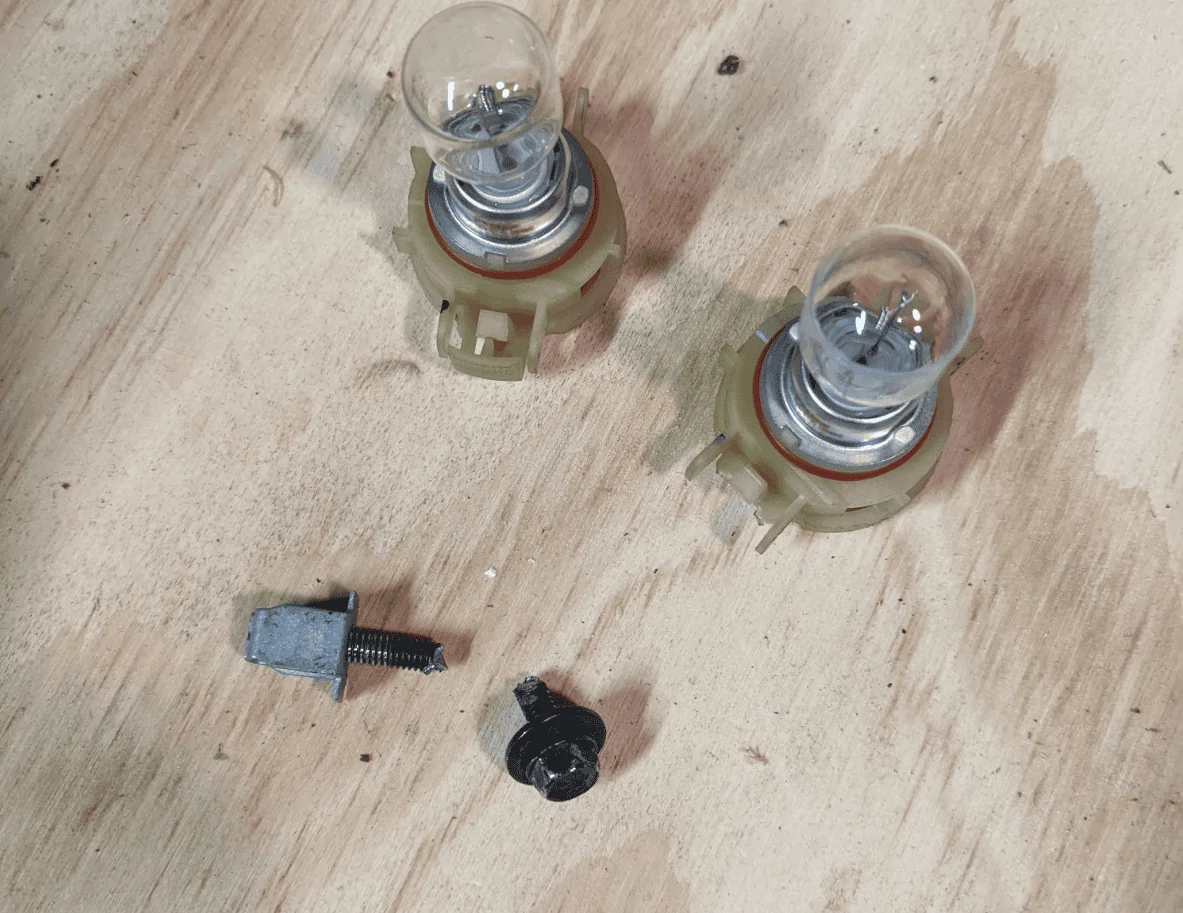

Step 2, nightmarishly long bolts that go into plastic retainers. They are very long, I used a cordless drill to pull em out as they got very tough using hand tools. As you can see in the 2nd photo the bolts go into metal retainers held in by a couple mm of square shaped plastic. Not sure why jeep couldn't just have a plastic clip in cover inbetween all these bolts for ease of access.

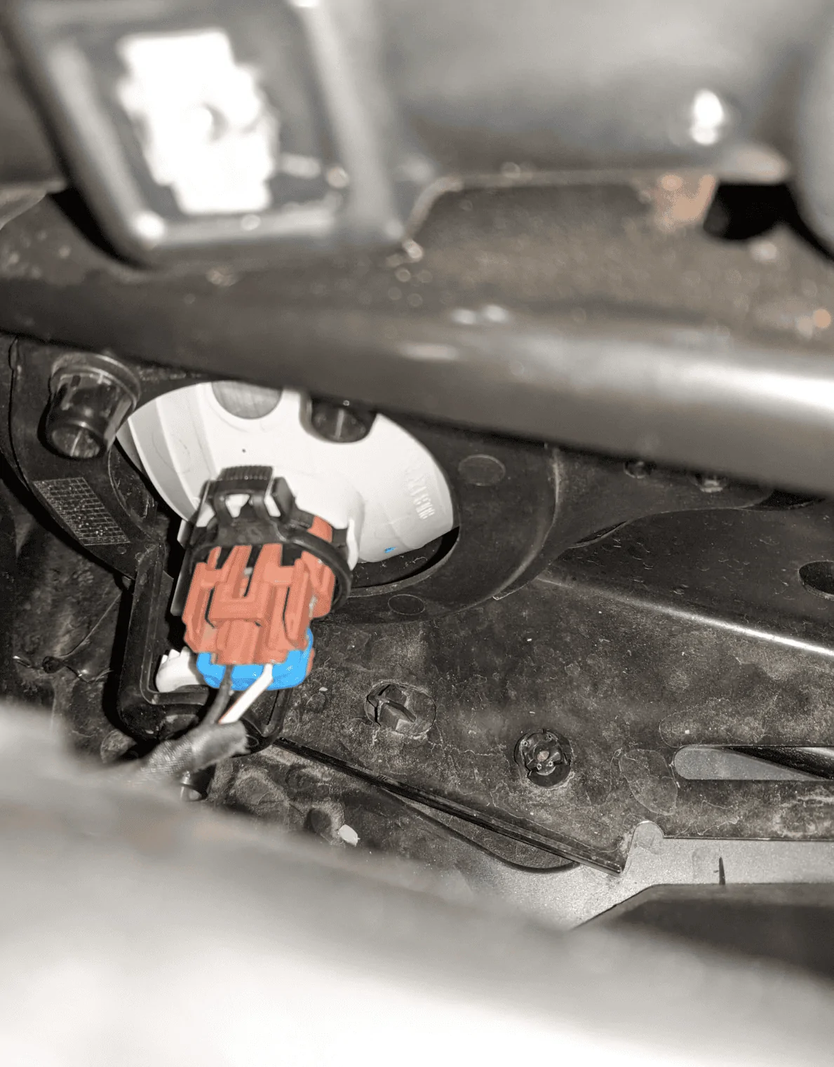

Step 3, the nightmare continues, now that you spent 30 min unscrewing unreasonably long bolts, you get about 3 inches of space to work with very soft fog light clips. I'm used to fog lights having a metal retaining clip, that is usually annoying to get out / in, but doesn't break, these clips were very frustrating to get out due to the limited space working with them. I believe the shape is symmetrical with a clip on both sides that needs to be pulled away from the housing enough to pull the bulb out.

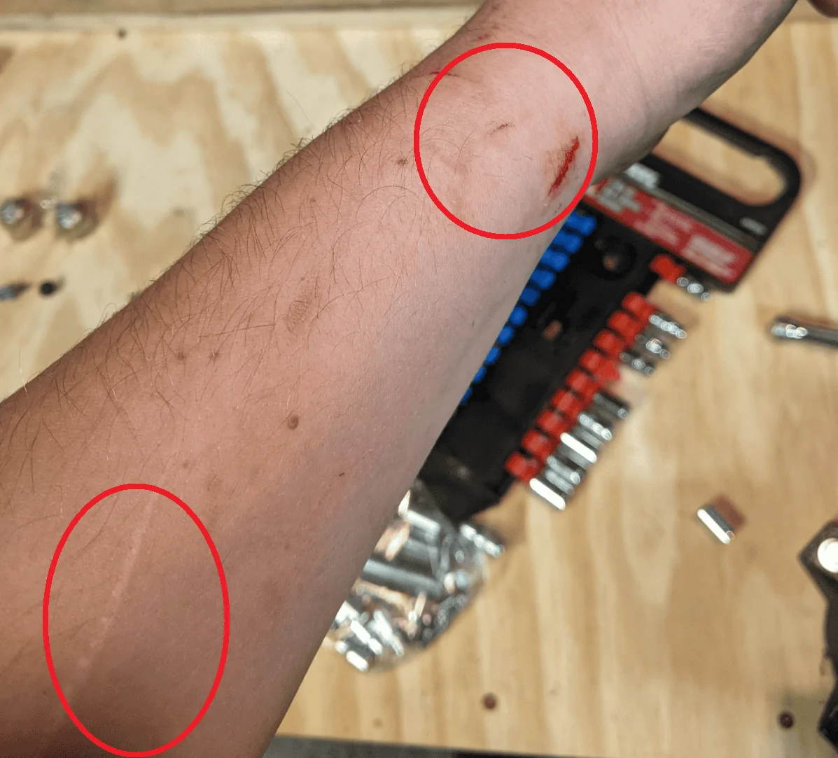

Step 4, install new bulbs by pressing them into the socket, this worked pretty easy, and was simpler than installing bulbs with retaining clips, but everything up until installing the bulbs is awful. I ended up with another car project scar on my left arm and some sheered bolts. I had to cut a couple with the bold cutter to get them out. Might be worth a shop putting in bulbs if it is going to be this difficult.
I had no problem with those bolts in the fog light covers. They came right out. I also removed my air dam from the bottom. I had everything off in about 15 minutes. Not sure why those bolts gave you so much trouble. I used a air wrench though so maybe that's the difference. Removing the air dam fom.the bottom gave me easy access to the fog lights with getting any scraps or scratches.

It sucks. You must remove the lower air dam. I tried it without. I was able to one of the upper air dams out and change the fog light but I couldn't reinstall the air dam until I removed the big lower one. Once it was removed, it was all straight forward.

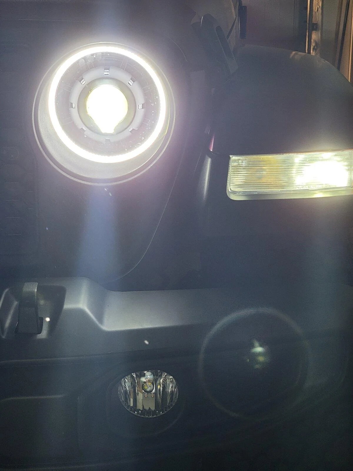

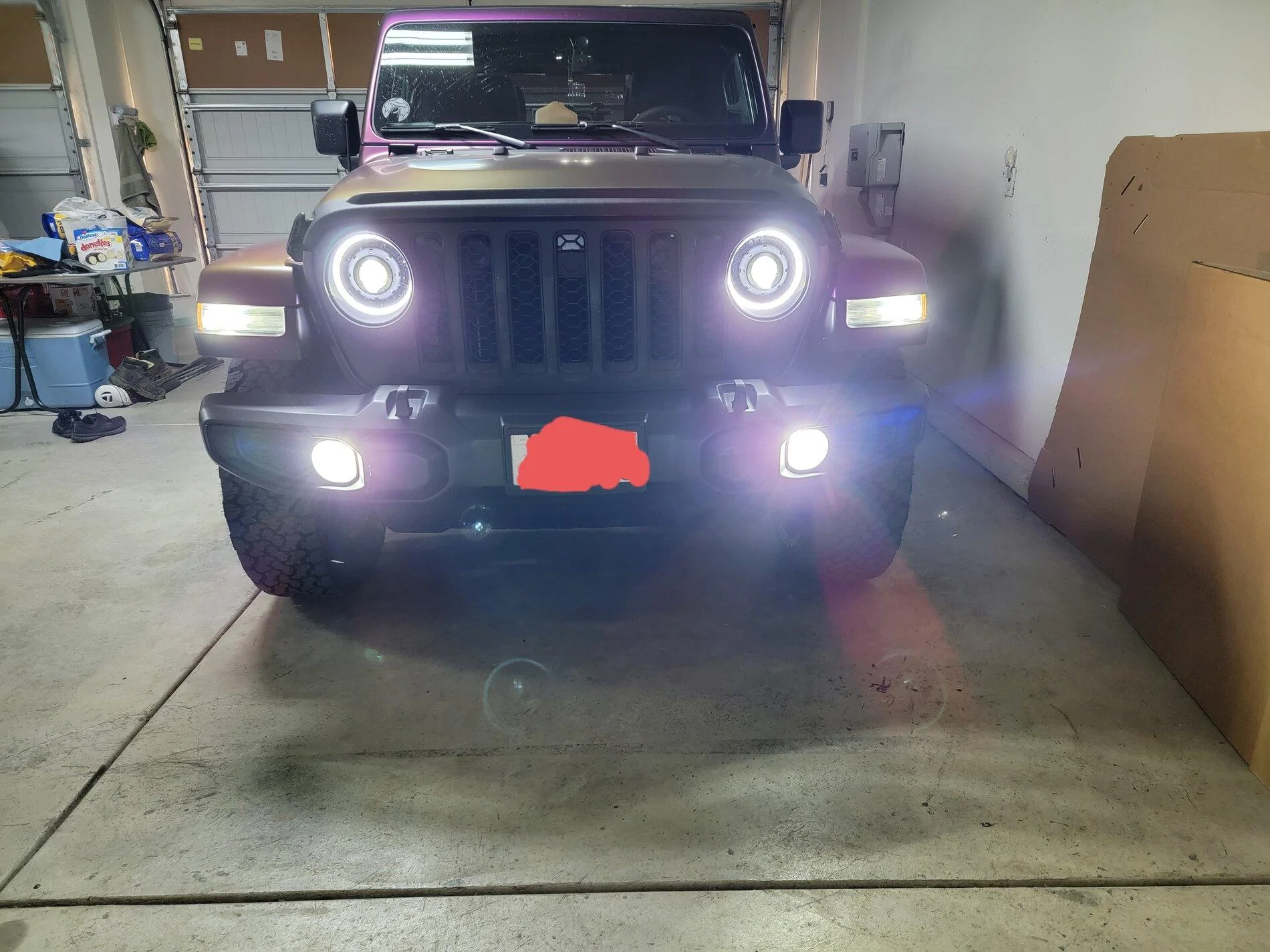

Anyone installed these to compliment the oricle oculus headlights?? Curious how that looks...
I didn't see if anyone replied to you. I have the Oculus Bi-LED headlights installed and just did the bulb switch on everything else today with some smoked LED taillights.

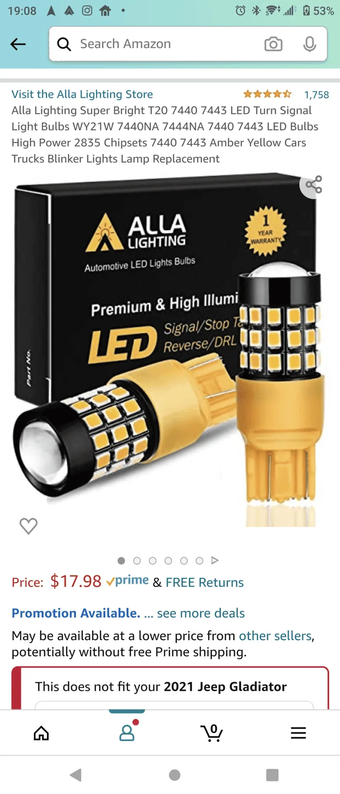

Which rear turn signal bulbs are working without issues for you all?
These give me occasional rear turn signal out messages and hyperflash. I did use JScan to activate LED lights.
Bump. These caused hyperflash even with JScan activating LEDs.
What rear turn signal bulbs are other people using?

I'm using the Sylvania Zevos 7443 in the rear in red. I also had that Alla lighting ones you posted installed but mine didn't hyperflash after the Jscan was set to led for the rears. The reason I switched was because the Zevos were brighter.
