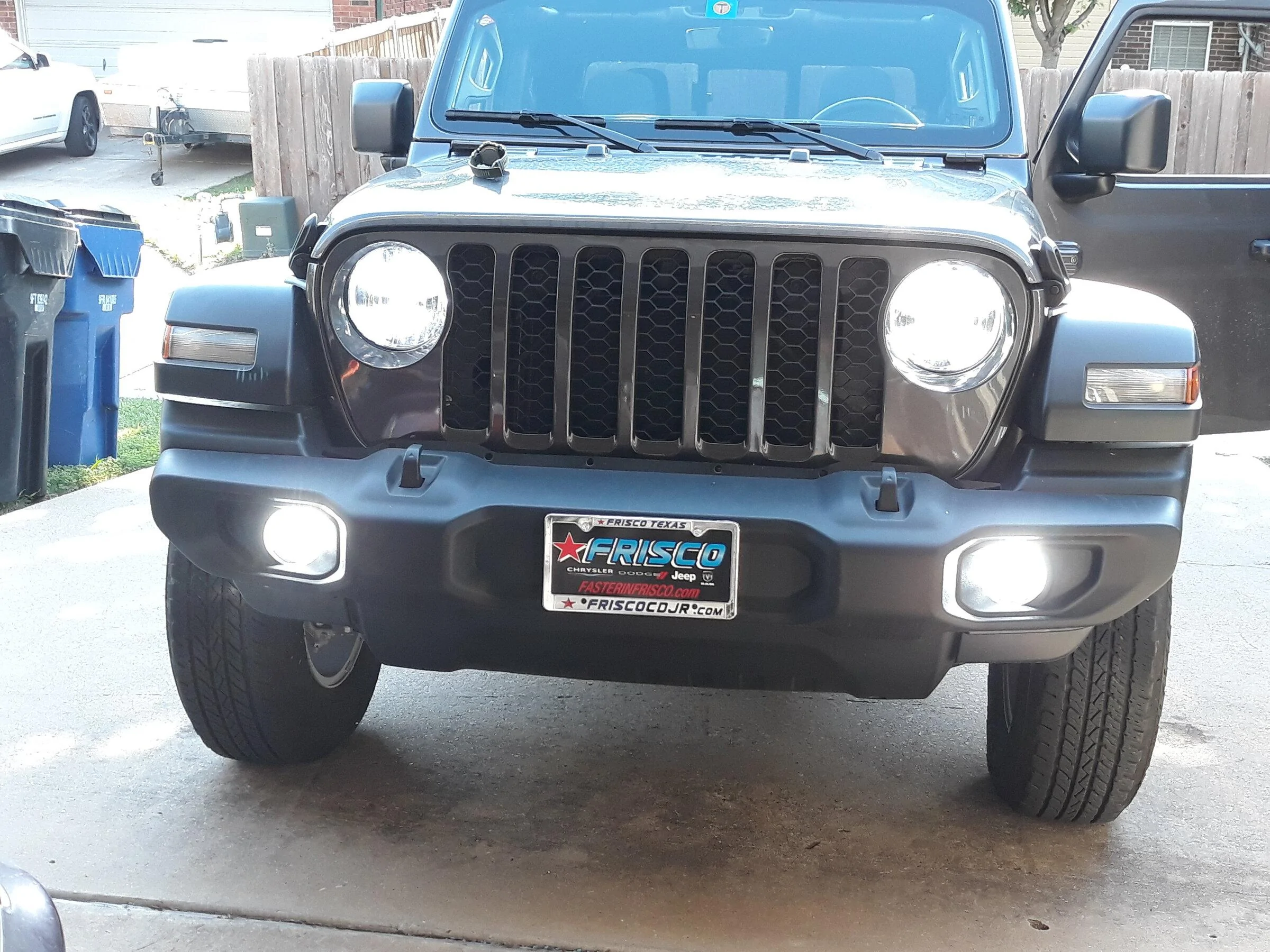

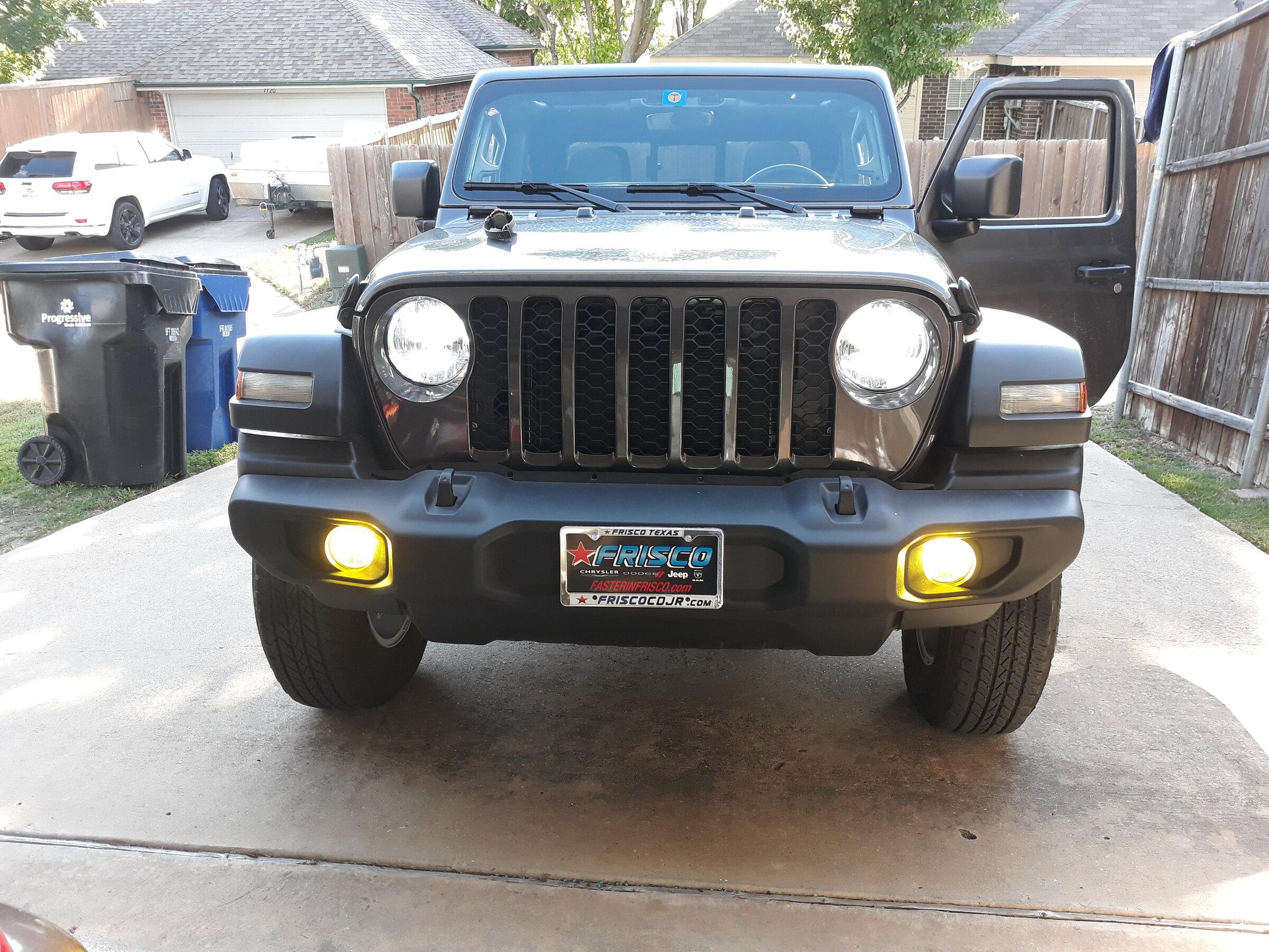

I'm using Lasfit headlights and fog lights, no issues at all. My Lasfit switchback DRL/turn signal lights work great too, but be warned that the turn signals get too hot in the texas summer and if you're sitting at a stop light waiting to turn, with turn signal on for about 4-5 minutes, they will overheat and you'll get a signal on your dash that the turn signal bulb is out. If you let them sit for a couple of minutes, you can use them again but I tend to manage how long they are on, I'll wait until I'm up closer to the turn before I turn them back on.
The fogs are switchback as well, one push of the fog lamp button and they're brilliant white, turn them off and back on, and they're amber.
